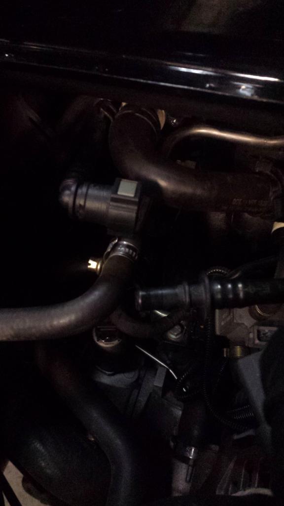

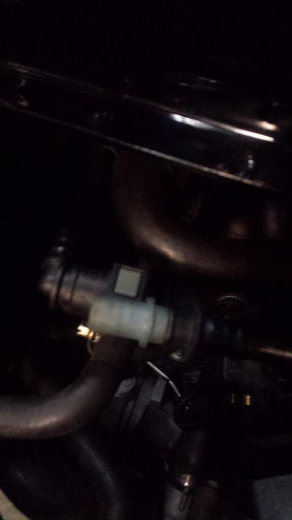

Congrats on the car. Sorry to hear of the problems. What does the car do when you put the A/C on? There is a vacuum line that goes up to the charcoal canister/ gas tank, one of the valves up by the gas tank may have failed? You can disconnect and cap in the engine bay easily. I will get a pic up of it later today.

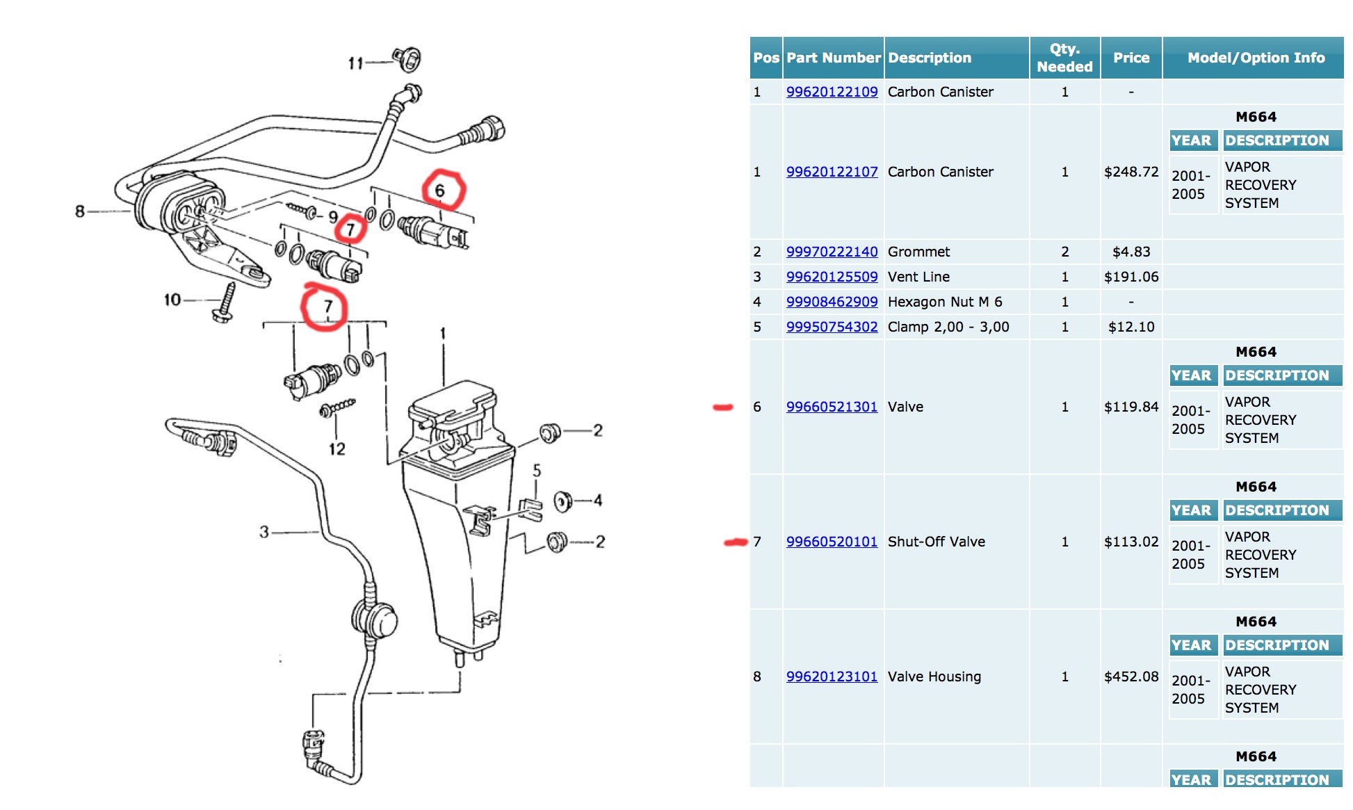

If you catch all the leaks in the intake air system it can be related to the fuel tank ventilation system according to the OBDII manual… If you got access to Durametric there are a couple of valves you can check in the system for proper operation...
Ya know, you guys might be on to something... What would you expect to happen if you remove the gas cap while the engine is running (warmed up)? I tried that and got nothing. No rush of air, no change on idle and no difference if I put my palm over the opening. I expected some change.
Tim, if you can find that photo that would be awesome.

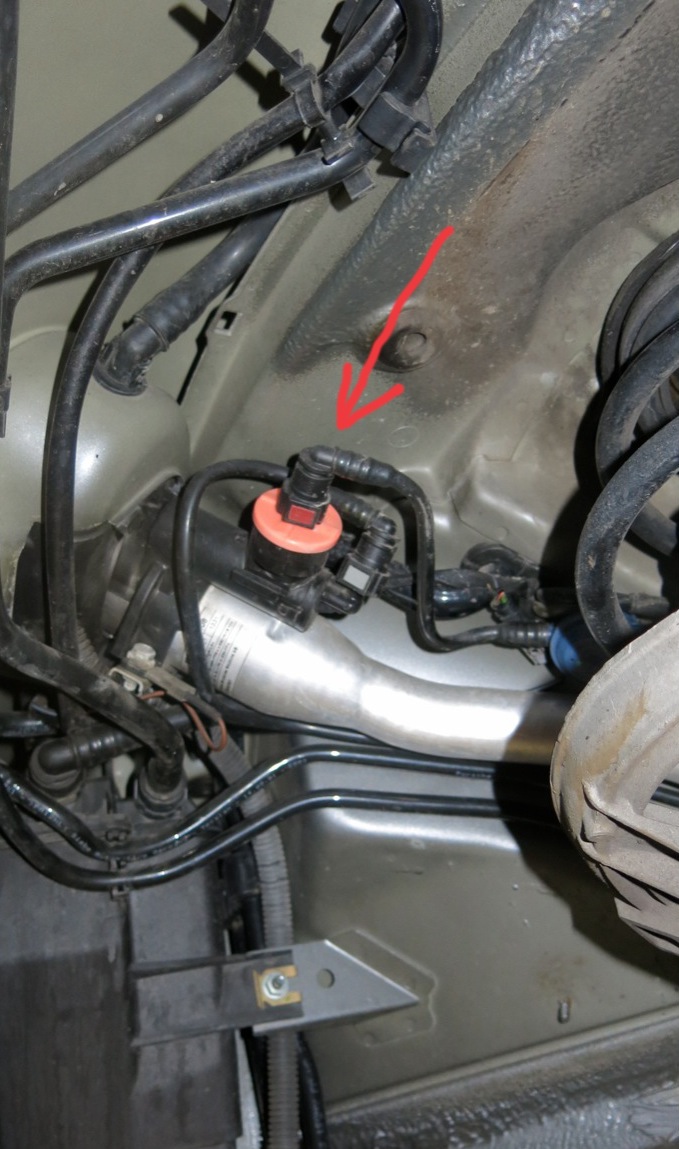

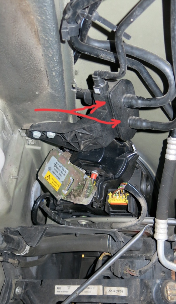

May be this will help you located the pipes going to the tank and the valves. They are under the right front wheel well liner. One is located besides the filling pipe and the two others are a bit in front of it….I remember not long time ago helping someone with one of those valve found at fault. But cannot found the thread ;-(

Tim: If I remove and plug that line (thanks so much for the photos), it makes no difference
Now, I do feel a nice strong vacuum on that line so that is a plus, but in no way could I notice a difference (revving a few time and holding at 3K for a few seconds and then to idle)

I haven't done the bit under the right wheel because I don't have the Durametric kit. Can I check them without it? Maybe just 12V to the appropriate pins? Looks like one is in my future. Seems like it is a must with this car (or a strong want).

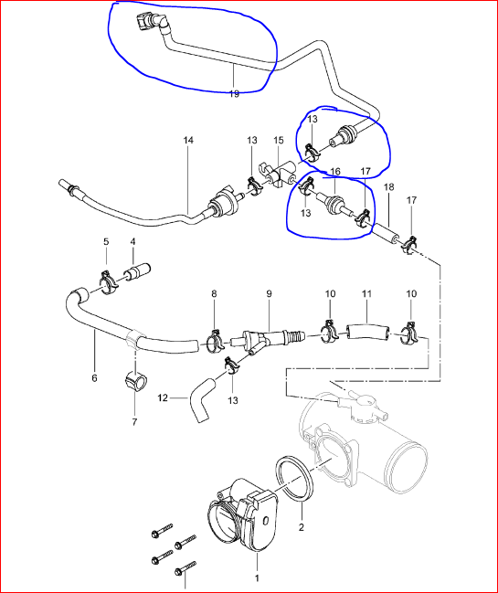

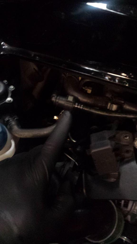

Ok. It is a vacuum leak. Once you have a load on the engine the Leak is providing enough flow that the T/B at its stop is enough to control the idle. Try the brake booster line next. It is right behind the line you just opened. You will need to remove the grey clip (on a white coupling) in order to separate the coupling. All these lines have check valves the boost leak testing will not show the leaks.
Ok, so I found what your were describing, removed the gray clip and there was even a little wush of air (engine off...) when I pulled the tube out. I replaced the tube, but not the clip and went out to warm it up again. Got back and pulled that tube - lots of vacuum! The car almost stalled and I sealed it with my rubber gloved finger. No real change. I had someone run the rpm up and down a couple times with it connected and with my finger on it and no real difference. Tried the AC thing again and the idle went down. Put the tube back on and reinstalled the clip.

Any ides on what to check next? Maybe some of the valves under the fender well as JP suggested? Can I check them the same way as the other two?
