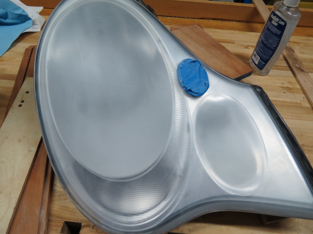

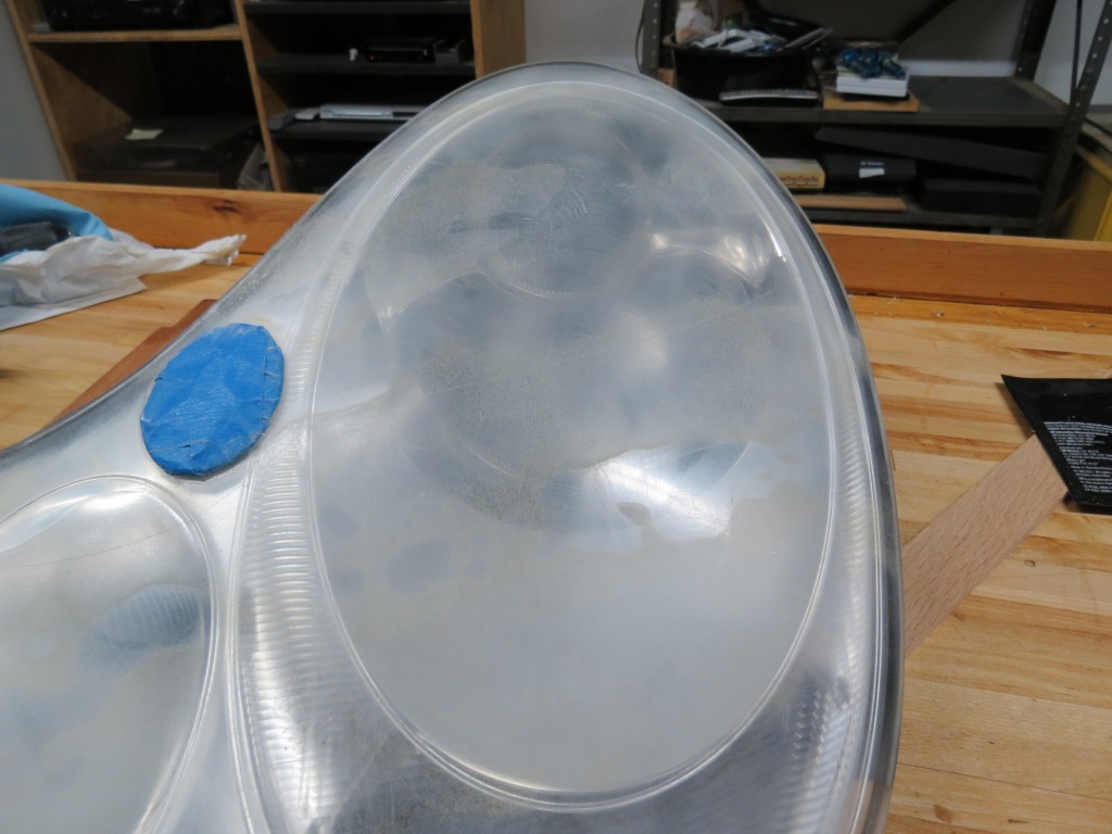

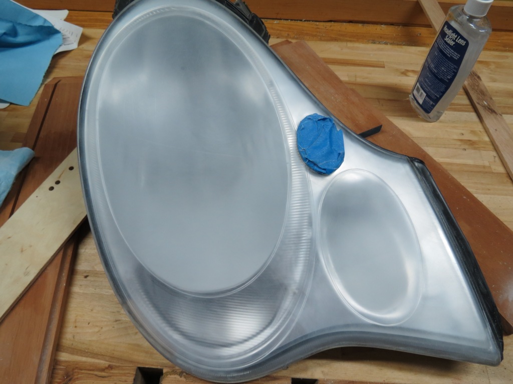

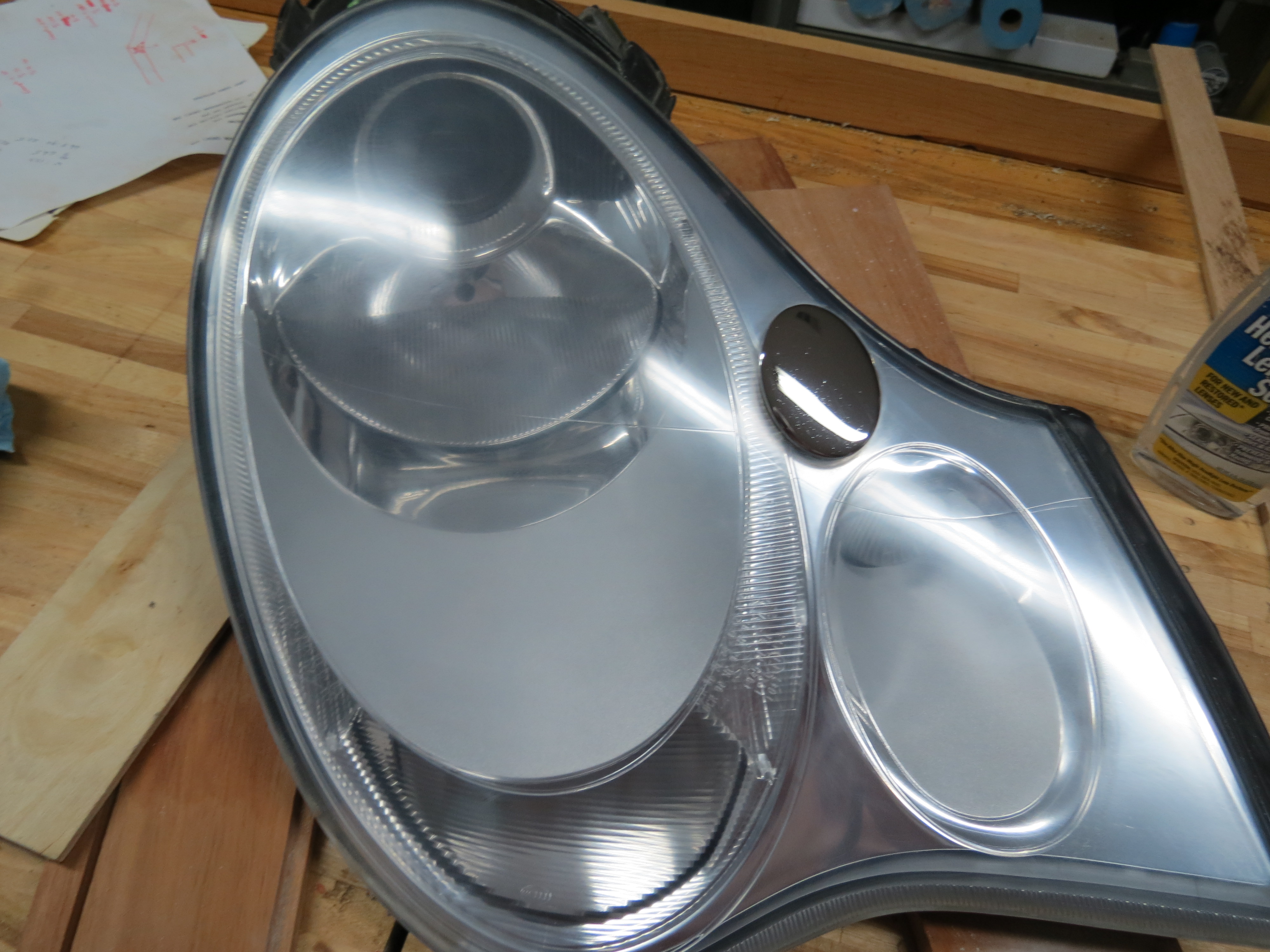

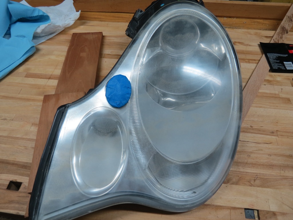

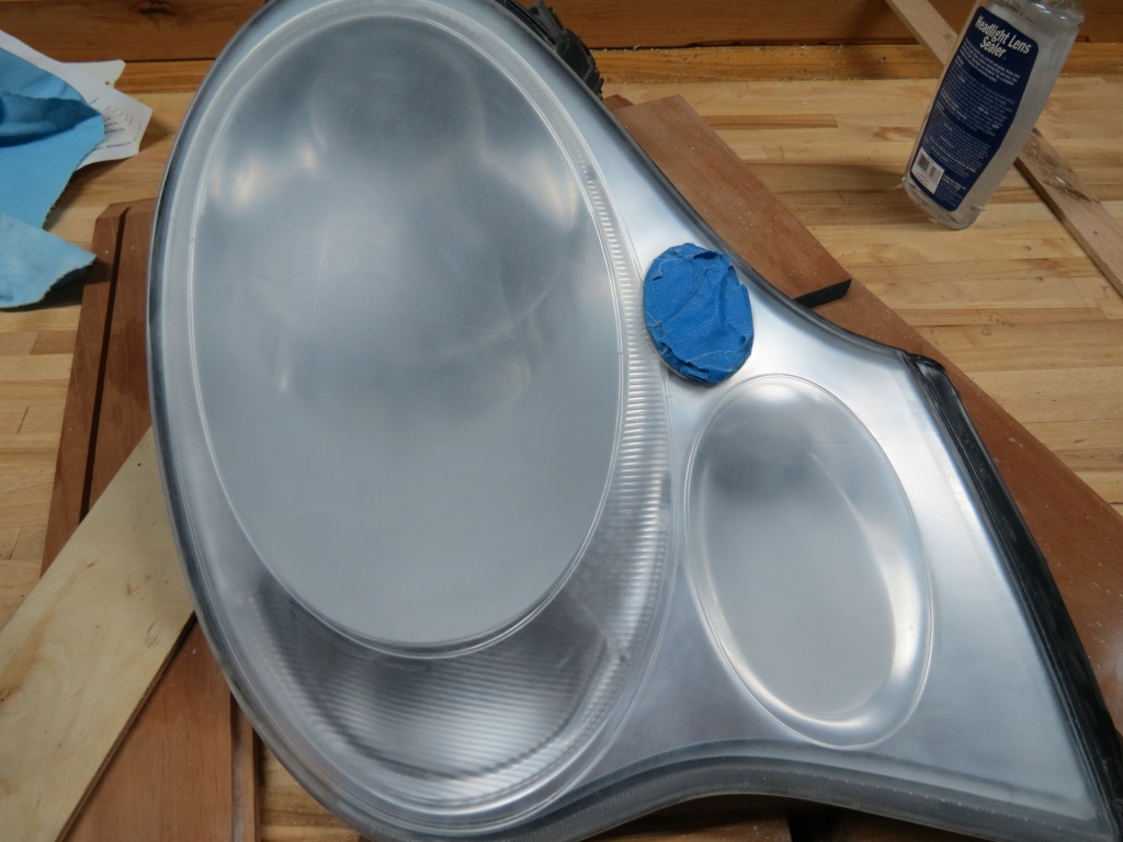

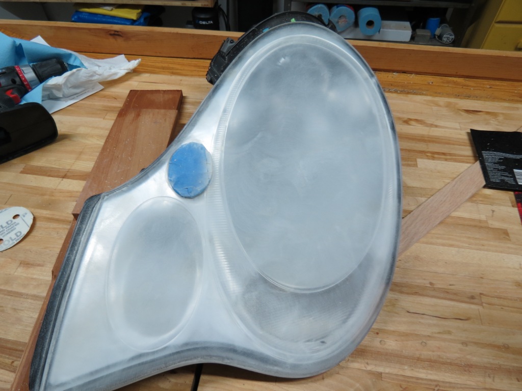

This is my first multi-picture upload, so bear with me. The first picture is how the headlights looked before I got started. The second is how it looked after I worked and worked with the 500 grit paper from the kit. It still had lots of cloudiness and discoloration. So I went to 225 grit woodworking sandpaper and got the results in the third picture. Then I think I went back and un-clogged the 500 grit paper as best I could and got the fourth picture. (Yes, I've jumped from the left light to the right light because I forgot to take pictures of the left after I started seeing results!) The last picture in this post is after I used 600 grit paper from my shop.

I then used the 800 grit paper from the kit and took this first picture. I used the 3000 grit wet pad (no pic), then the polishing paste and got the results you see. As I said in my earlier post, I'm very pleased with the result and hope it lasts at least a couple of months.
