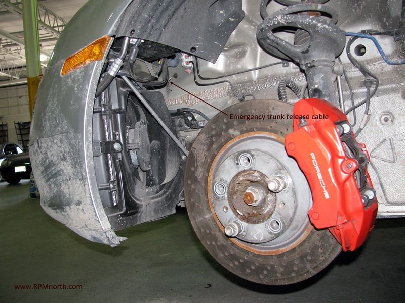

this is KEY:!!!
Third Method
Inside the top of the passengers front wheel well, just aft of the spring coil mount, is a little rectangular corner in the black plastic shroud that lines the inside of the wheel well. Reach under this, and you will feel a "wire" about 1/8" in diameter. Too thick for an electrical wire (and not in a harness anyway). Tug this cable gently out from behind the shroud and get a good grip on a loop of it. Now pull hard away from the headlight once, and prepare to hear the music of the alarm as the front hood pops open. Grab a 10mm wrench and take off one of the battery cables to silence the alarm.
this pic is a 997 c4s its same but OPPOSITE side on your 996 tt
