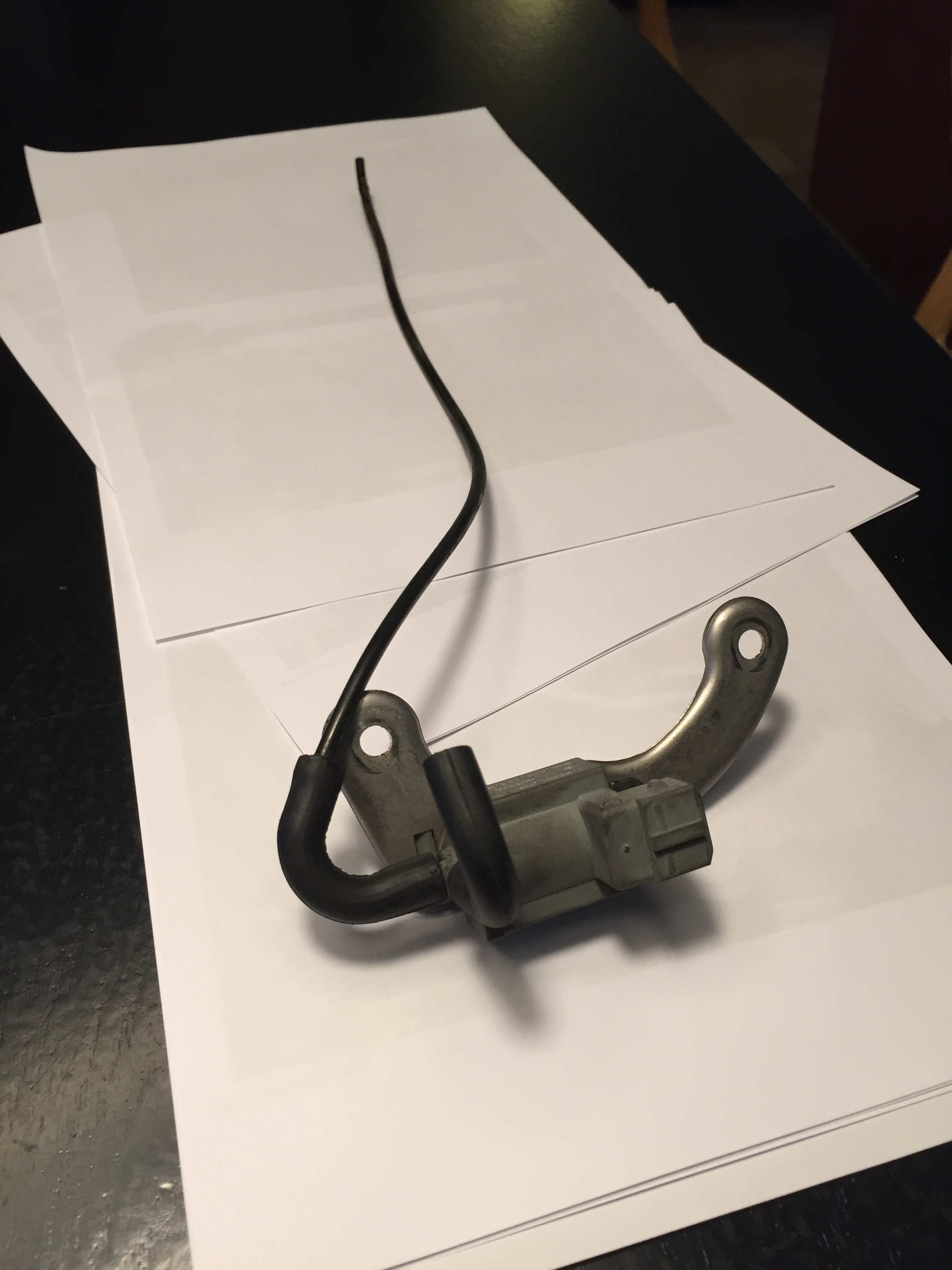

While installing my COBB 1000cc injectors I managed to pull this vacum pipe of a hose.
The solenoid was mounted on the Secondary Air Injection pump. While removing the solenoid from the SAI pump I managed to pull the pipe off before I could see where it came off.

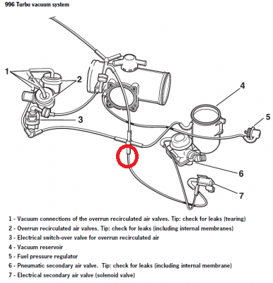

I located this vacum system drawing and I guess I need to locate that red circled vacum connection. But havent been able to locate that X-hose..
Hoping that some of you Guys recognize and can let me know where to find it
Considering removing the whole damn SAI system now that I am in there anyway..

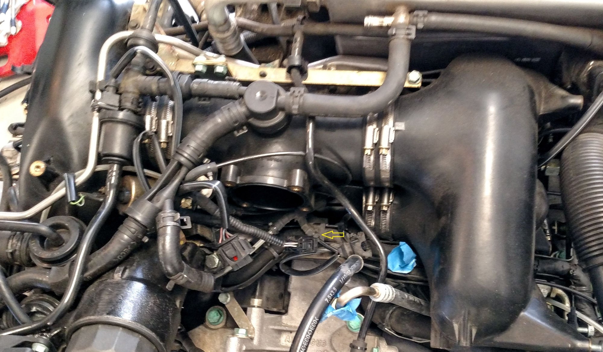

I was just in there securing all my vacuum pipes with small tie wraps last night. That X-pipe is tucked in there under the throttle body and behind the A/C compressor. But it's also behind a wiring harness and fuel pipe.
This may help:

Thanks pteck,
Thats exactly what I needed!
