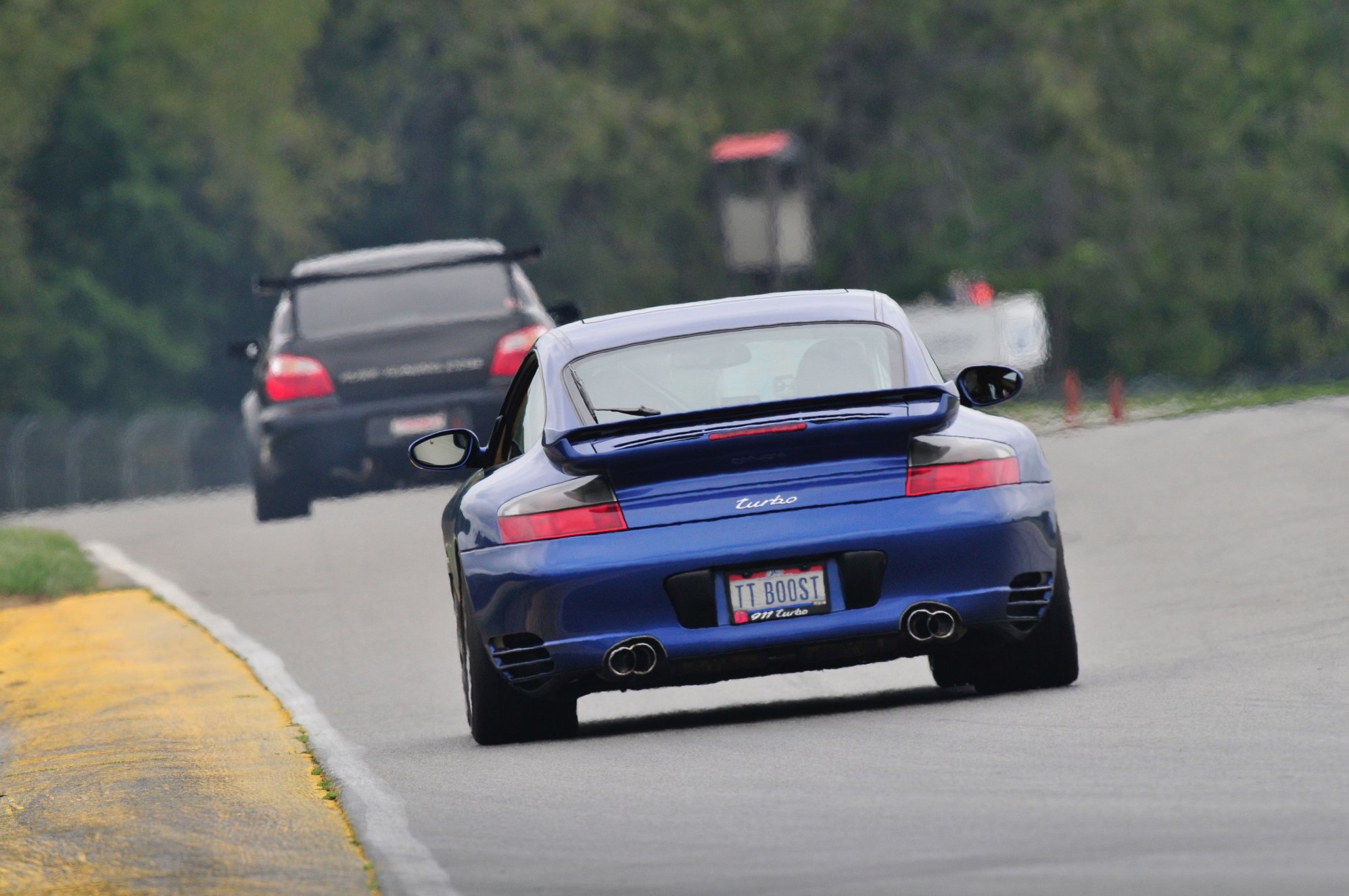

thanks for the plug BLK, getting the wing up higher in cleaner air is the name of the game. Exactly why the cabriolet wing extend another inch. This past summer I put on a toth 2 piece splitter, that combined with 4" eRams really made a difference during DE time at Mid Ohio and other tracks. In fact, getting the stock wing up to 4" puts it at roughly the same height as a GT3 or GT4 wing.
