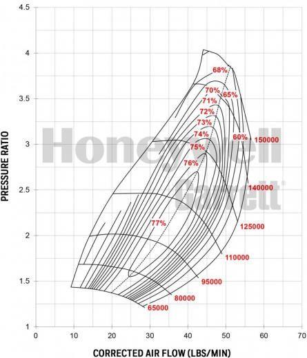

Here is another example of turbo tech coming a long ways. Here is the 71hta comp wheel.
the inducer is .7mm larger than an 18g and 1.3mm smaller than a 20g with the same exducer size as both. It flows 51lb.

was that cast or a billet. A mhi cast 18g flows about 39lb. So a modern billet 16g out flow a cast 18g by about 5%. Looking at something like a cast 20g, they flowed 42lb. Modern billet flows over 50lb.
billet to billet it can be hard to say as it harder to find maps for everything.

Here is any example of technology. This is garrets 3071 gtx wheel, gen 1 vs gen 2. You can see how much flow is gained. Same size wheel, just better design
