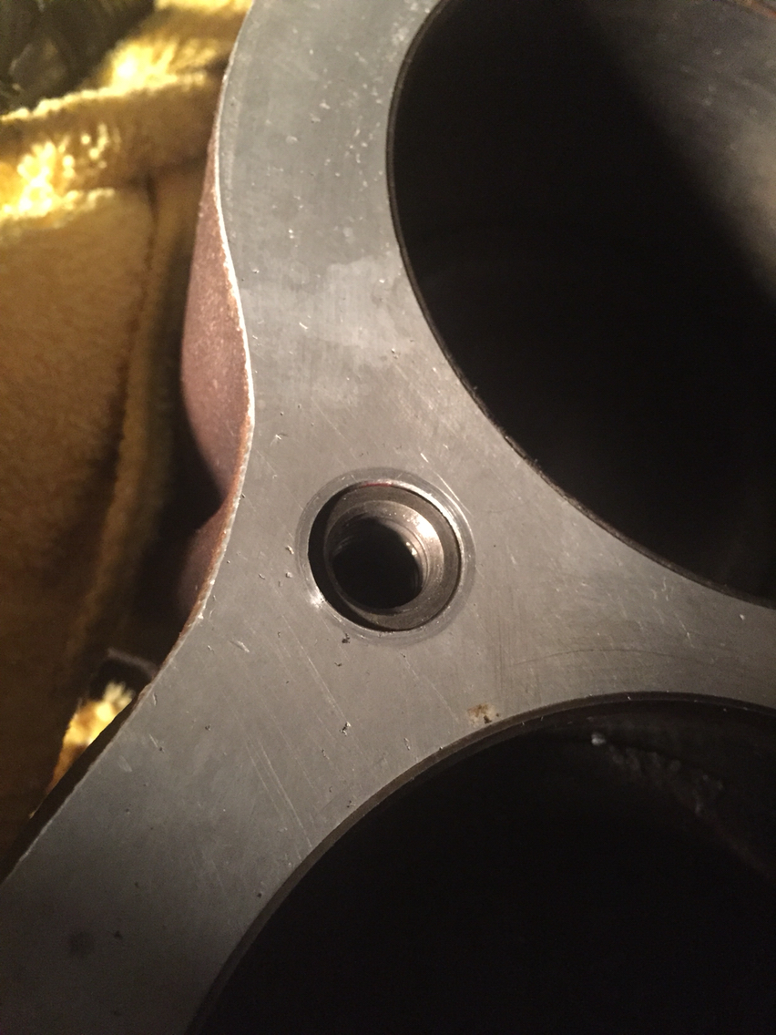

I hit a snag while installing a new exhaust on my 2002 996tt last weekend. I decided to replace the studs and nuts as they were looking a bit ratty. Soaked everything in PB Blaster and let it sit overnight. Successfully pulled 6 of the 8. I used heat from a torch to heat up the turbo housing, but these 2 studs were very stubborn. Finally got them loose, but they left bits of their threads behind. Rented a thread repair kit from Autozone and ended up flattening the threads on their tool. Turns out that what I thought was a tap and die set was a thread chaser set. Went to the trusty Harbor Freight and picked up a tap and die kit and then went to work on my threads. Ended up pulling out a nice coil from the threads in the housing.
https://cimg2.ibsrv.net/gimg/www.6sp...c01f32e759.jpg
I made a video in the hopes that it would help others that may face similar issues working on their own cars.

z06801, just make sure to use the first few flatter threads on the tapered end of the tap to get nice and square
Highlander, that sounds like a nightmare and what I was afraid of having to do. Adds to your experience, though. I am not sure if helicoil/loctite red would hold up to that application. It probably would be off and out to a shop.

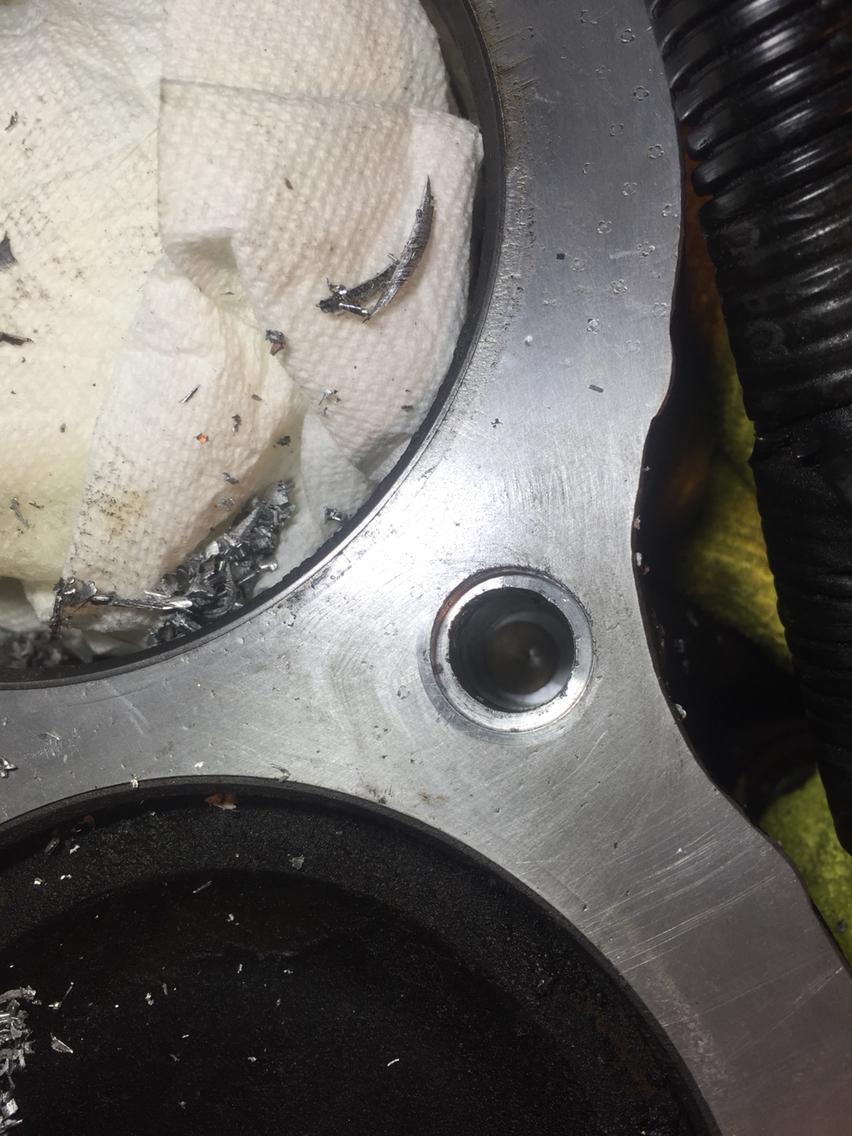

1 Attachment(s)
Right, that was one of my concerns keeping everything square as I have to free hand it with a hand drill, this Timesert kit came with its own special tap. It's kinda do or die for this motor and not really looking for it to go much further. Really just want to see if I can put it back together and have it run for awhile.
Well just went to garage and did the first step, drilled out the old threads then cut the seat for the Timesert, seemed like it went pretty smooth the tap wouldn't fit into the tap handle I have so I'll stop there for tonight. Still think it is weird that the same hole pulled threads on both sides.Attachment 472932

z06801 03-30-2017 07:26 AM
1 Attachment(s)
First side went great, new threads installed these Timeserts seem to work pretty well. Going to see if I can get the head torqued down today. Attachment 473018
