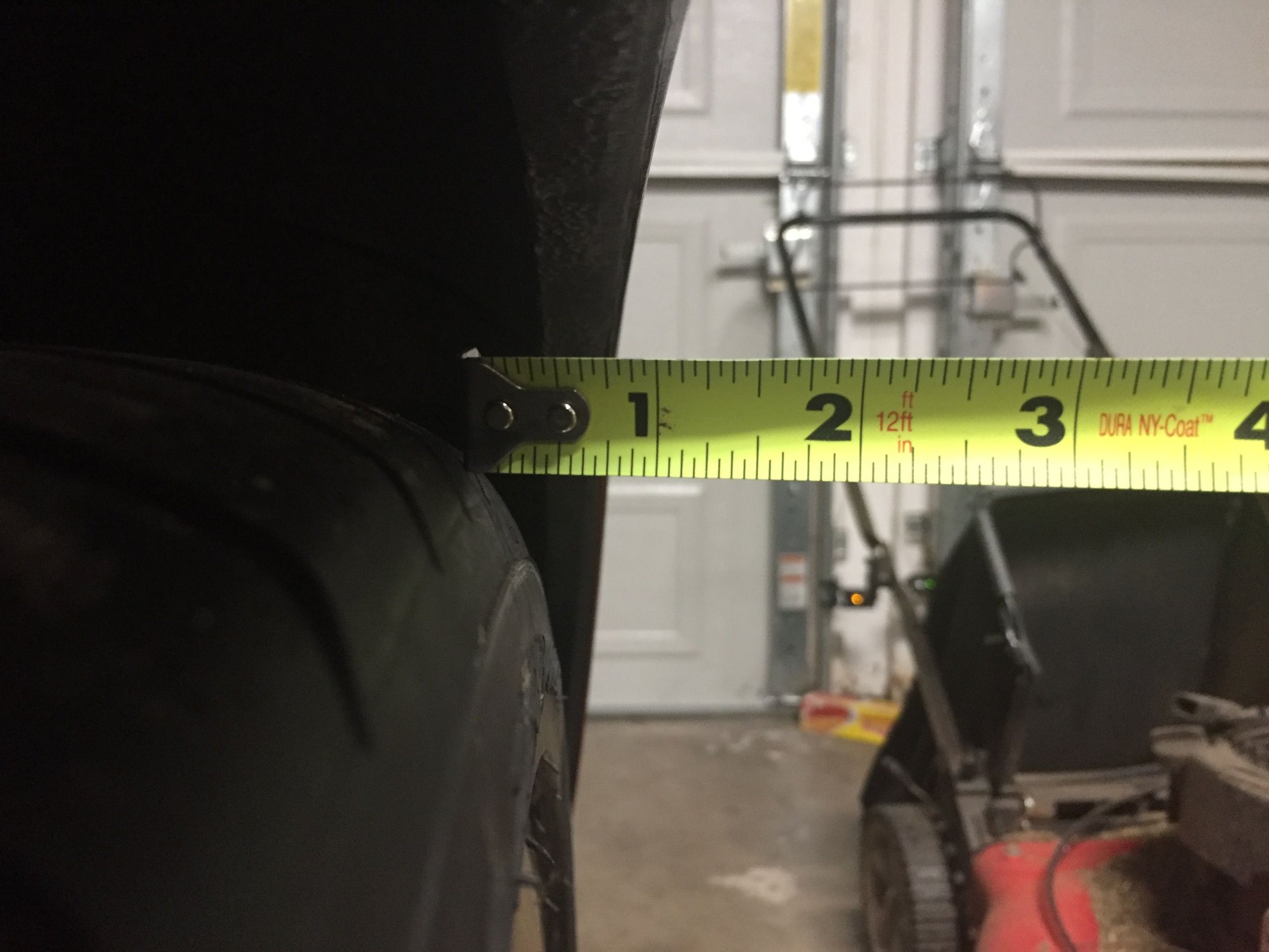

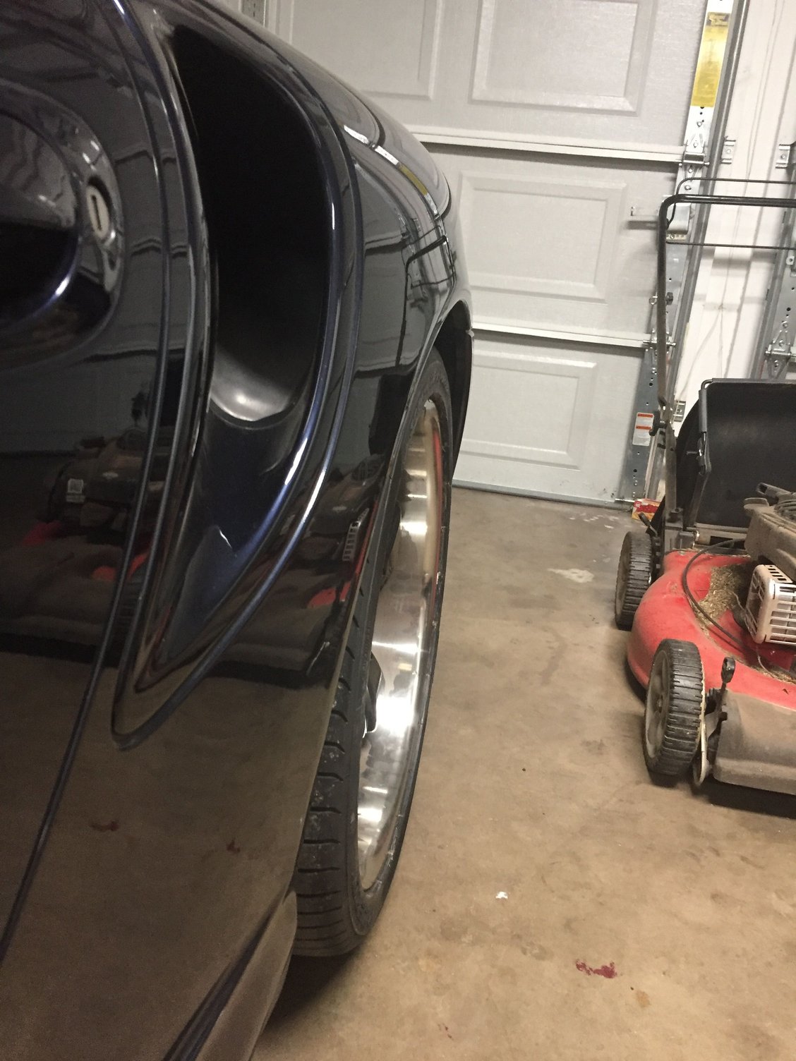

Here is fitment and area rubbing, I got an alignment to see if that would help...it didn't. I ordered a set of 15mm spacers. Are these narrow body wheels, is that the issue?

Atrox, I think 15mm spacers will be too much. (You will definitely have to roll fenders) 40 offset on an 11 is conservative but ok for widebody. 305/30/19 is quite a bit larger overall diameter than stock. I think 15's will push the wheels too far out...something like 5-8 mm will probably do the trick.

15mm is about 5/8 inches. Here's some better shots with car for perspective. It looked like 7-10 mm would not have been enough to keep from rubbing.

Yup, I see....it won't hurt to give it a shot! are your fenders rolled? Thinking you will likely have to do so. Keep us updated.

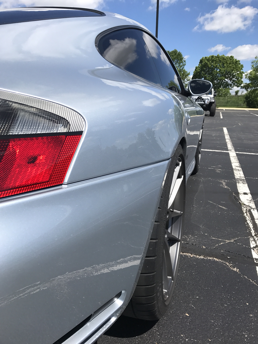

Btw, here is a shot of mine with 8mm spacers and 19x11 40mm offset, fenders not rolled...
