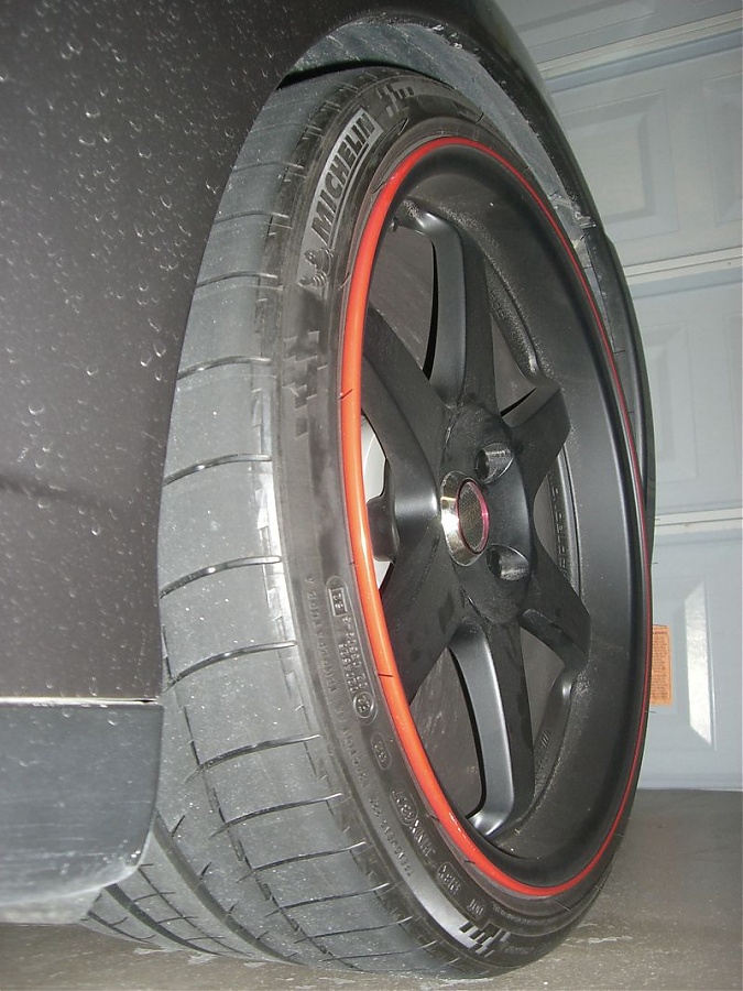

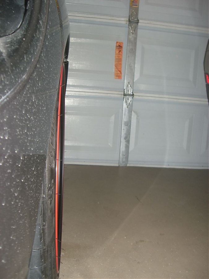

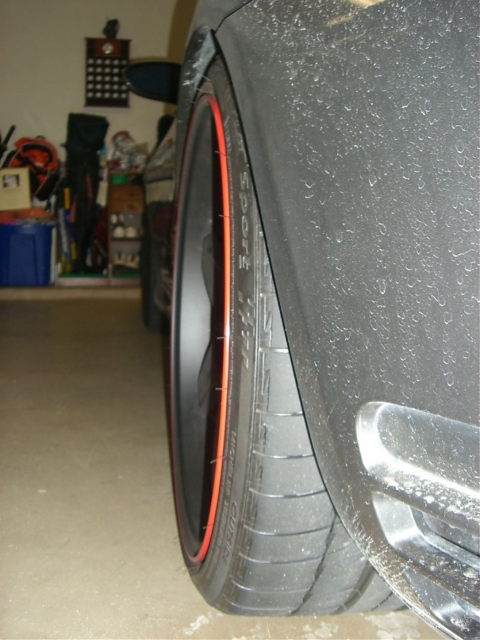

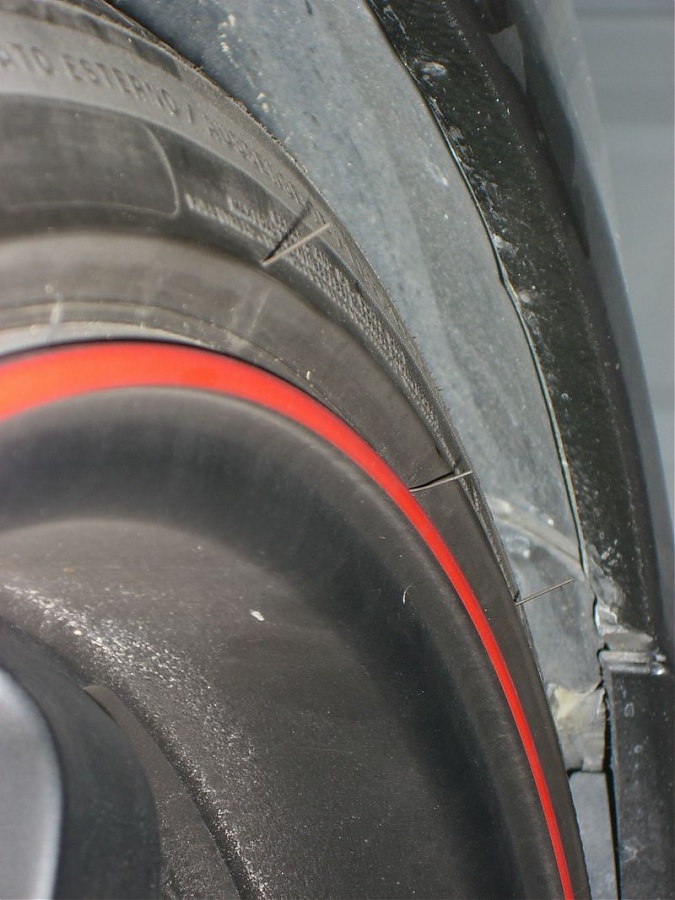

I ended up with 47mm offset on 12" rears with PS2 315/25/19's, plenty of clearance in and out, car dropped 1.25". The fenders are rolled conservatively, no more than 1/8" gain. But I think that there wouldn't be any rubbing without it to be honest.
My rear offset is original - 65mm - less the 18mm H&R spacer I settled on, giving 47mm. I tried a 14mm spacer first but it was a little too tight on the inside fender liner and the wheels looked a little tucked in. Going out to 18mm gave a better fit and look.
Sorry the picture aren't great, just trying to show the final fit. Car is dirty, I know!
You can see on Image4 where the inner fender liner rubber when on the 14mm spacer and lowering the car when it was on the jack, it rubbed then and then also a tad over bumps. That has gone now.
I am guessing a good offset for the 12" rear would be from 47mm to about 40mm avoiding rubbing in and out. Remember if you get a big offset you can always add spacers, if you get too small an offset (aggresive to the fender) then you are out of options once you roll the fenders, I was there with the Work wheels I had before (28mm offset).
