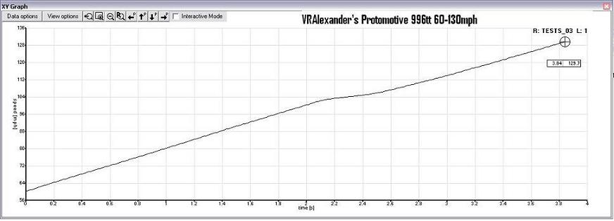

I have NEVER felt her pull like she did last night (must be the desert air) ...here is the chart for your review (Dr.Jean is still crunching numbers):
Name:  VRAlexander's Protomotive 996tt 60-130mph.JPG

For another opinion I am having a Physics Proff. analyse the file as well as a tech at Race Technologies...we will have validation soon..

Yes according to my calculations Alex's run is not good. There is some (a bit complex) calculation to be made that links acceleration with speed and gives the final verdict in these cases. The G force generated does not match the momentum at which the vehicle is picking up speed. This same calculation can determine slope etc.. which in this case was not there.
I am sending detailed instructions to VRALEX about how to use the tool and avoid these situations. In hard launching cars, the unit is subject to sudden tilt, and it can fool the numbers as the GPS does not have time to adapt quick enough and calibrate the accelerometers. These conditions are rare however and usually only happen if the car in question sees some serious Gs and the unit is not well attached. He will do some reruns and have these ones double checked by a friend. These are my findings.
The unit is extremely accurate, and one of the best out there for sure, proof is that one is able to pick up these variations, however like any other electronic gizmo, they are sensitive to usage conditions.
Alex is comfortably into the 5s however, that I can guarantee..And still holds the fastest 60-130mph I have seen listed anywhere on a street car.

Jean,
Thanks for your analysis...are you saying that my car pulls so hard (G's) that the unit cannot catch up and recalibrate in time to record an accurate time?? The other question I have is why is there a difference in 'Summary' vs 'Continuous' mode?
I have sent the file to race technologies for a verification as well as a Physics Proff. friend of mine at MIT.
As for the procedure, I make shure the car is turned off when it calibrates on flat ground and I use a level to make shure the unit is 'square'...I will follow your procedure and If we still have a discrepency, then I will do the Michael Jordan 'nothing but net' into my garbage can!
Thanks again for your time and diligence in analysing my files...
