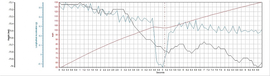

Scott I think you uploaded the wrong graph, the one there is less than 5 seconds and also has 2 shifts. Its also below sea level, I suspect that is a graph of one of your runs.
Aaron

Originally Posted by acicchelli
Great run, very fast 997TT.
Aaron
Thanks, Aaron.
I was comparing his run to mine, and consequently uploaded my graph by mistake. It's now correct. Good catch!

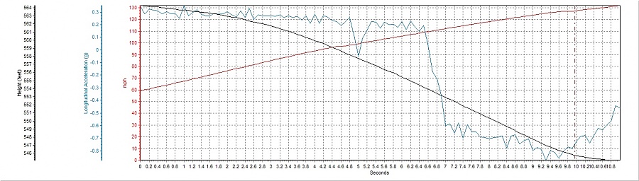

For anyone that's interested, I just reviewed some times from a stock E60 M5.
It went 10.48 with 2-shifts on a 1.08% decline. Total distance was 1,747 feet. He sent me 6 run files; with the slowest being 11.6, then 11.1 and the others 10.9. The car is definitely quicker than a stock 996TT.
Interestingly, the 2nd to 3rd shift on the 10.48 run took .16 seconds, and the 3rd to 4th took .30. Slower than I expected.

I agree those are good times especially for such a large vehicle. Maybe Iam reading it wrong but the graph looks strange to me. If you look at the g line it looks like he stepped on the brake after ~110mph but yet the car kept accelerating as quickly as you would expect for no braking. It does not seem like enough total longitudinal gs to give those times either. Can someone explain?

Now that you mention it, I looked at the graph, and you are right. How can someone accelerate with negative long G's? Something screwy is going on with that run.
