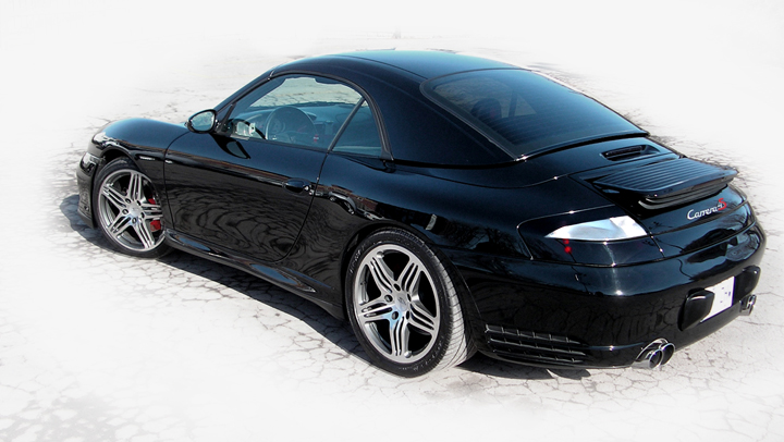

Old Nov 18, 2011 | 07:27 PM
Psycho Sid's Avatar
Joined: Feb 2010
Posts: 1,810
Rep Power: 321
Psycho Sid Is a GOD !Psycho Sid Is a GOD !Psycho Sid Is a GOD !Psycho Sid Is a GOD !Psycho Sid Is a GOD !Psycho Sid Is a GOD !Psycho Sid Is a GOD !Psycho Sid Is a GOD !Psycho Sid Is a GOD !Psycho Sid Is a GOD !Psycho Sid Is a GOD !
Originally Posted by Mamut79
Sexy car!!! Sell me your reflector :P
Im having difficulties locating one for a reasonable price, lol
Thanks!
Actually I painted the reflector black before I ended up putting the turbo decklid (see pics).
I'm pretty sure we're not allowed to discus a sale out side of the classified section but pm me if your interested in making an offer on the decklid and painted reflector (you'd have to sand the black paint off and clear-coat it), it also still has the electrical motor, "harmonica" (for the "wing" part) and metal separation liner.
The wiring harness and lettering (C4S badge) is missing though.
Cheers,
Sid.
edit, Oh yeah you'd also need to get the extra brakelight for when the "wing" is up.
