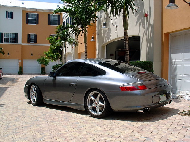

What wheels?....and assume we're talking reg narrow body?
Anyway.......nothing wrong with 7mm in the front, 17mm in the rear if you are running OE 8J & 10J 18" Carerra style rims.......that produces an effective offset of 45 & 48 which is OK without fender prep even in a a slightly lowered car.
Here's 'about' the same thing in offsets (43 & 50) in HREs with a slightly lowered suspension............stock 225/40...285/30.

my spacers
7mm on front and 15 mm on rears
