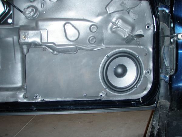

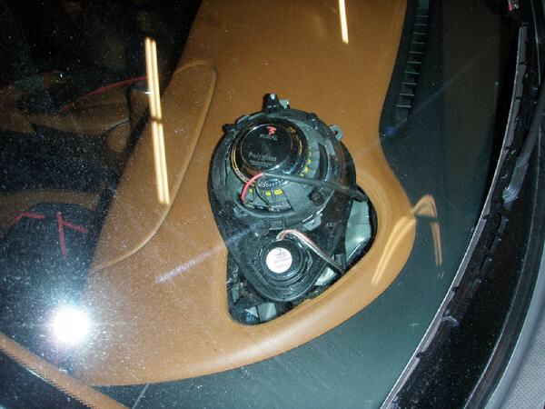

Dash and rear speakers dropped in easily. Custom mounts were built for the subs in the doors and behind the rear seat.

Here's a a photo of the door speaker mount.

Thanks for the pics. Very helpful.
