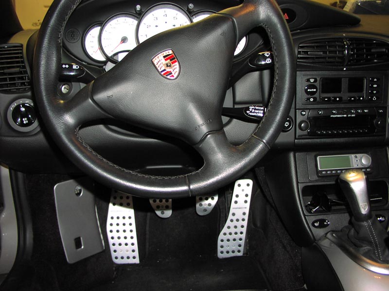

Tweety,
I have not heard of the SUV swap path. I just picked up an XM commander, installed it in dash, and connected it in place of the 6CD changer. As I recall had to get a pigtail to make that connection. It fits in the location you describe. I took a quick route and mounted the smaller XM faceplate on top of a blank w/cutout -- probably could have spent some time and come up with a non-layered solution. You should be able to see it just above the shifter in the pic below. My 01 already had the CD changer so I didn't have to figure out if/how to add that AUX functionality.
