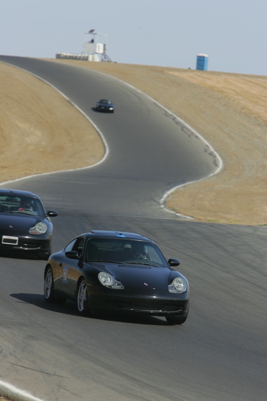

Here's a follow up. I went to Thunder Hill this past Friday, and have to come this conclusion. I love this new configuration!
Here's one of my track videos from the last session of the day.
http://video.google.com/videoplay?do...35143116&hl=en
Here are some pics as well.

I have virtually the same setup on my '03 996C2. You won't be disappointed at the track. I went with slightly heavier springs (8k/12k) as I do more on the track, but have really enjoyed it so far. The "flat" feeling through a turn makes my old M030 suspension feel really spongy by comparison, so I'm happy to have made the change.
If you continue to feel like the car is a bit too bumpy on the roads, you may want to soften up the rears a bit, as the engine tends to weigh heavily on the rears over bumps. You could also soften the sway bar in the rear as well.
Curious how your setup works for you at the track - share when you have a chance if you make changes/etc as to how the car feels. I've found the settings toward the middle of the "clicks" tend to make the car feel really tight through the turn and loose coming out - I've softened my back settings to 3 from soft and tightened the front to the middle setting (8 from either) and the car tends to settle better through the turn - let me know how you end up!
Enjoy.
