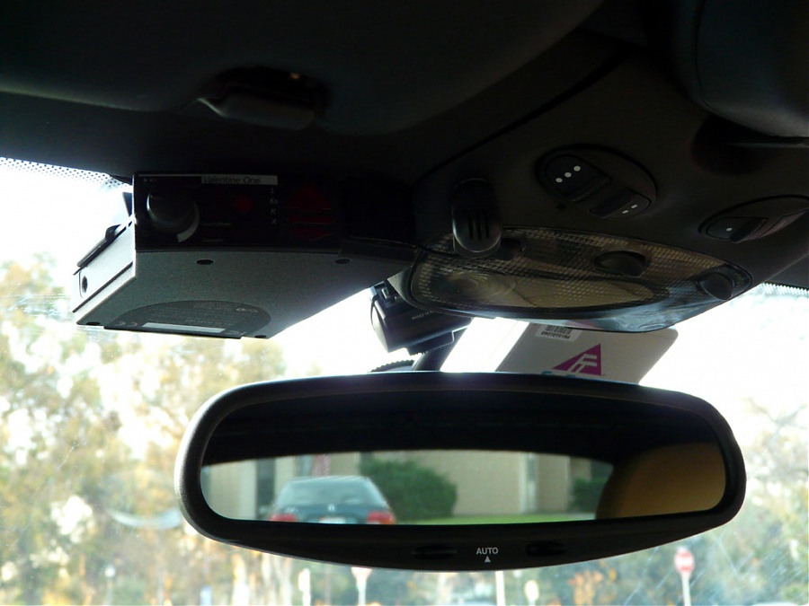

so this fully integrates into the head unit system? where does the mic get installed?

Here or there
