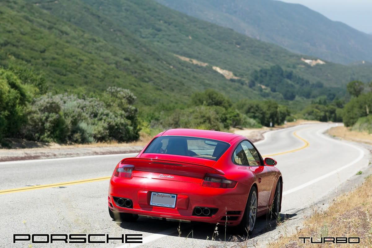

Just a couple of pics to add, from my drive in Southern Cal over the weekend.

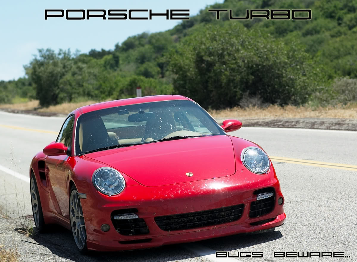

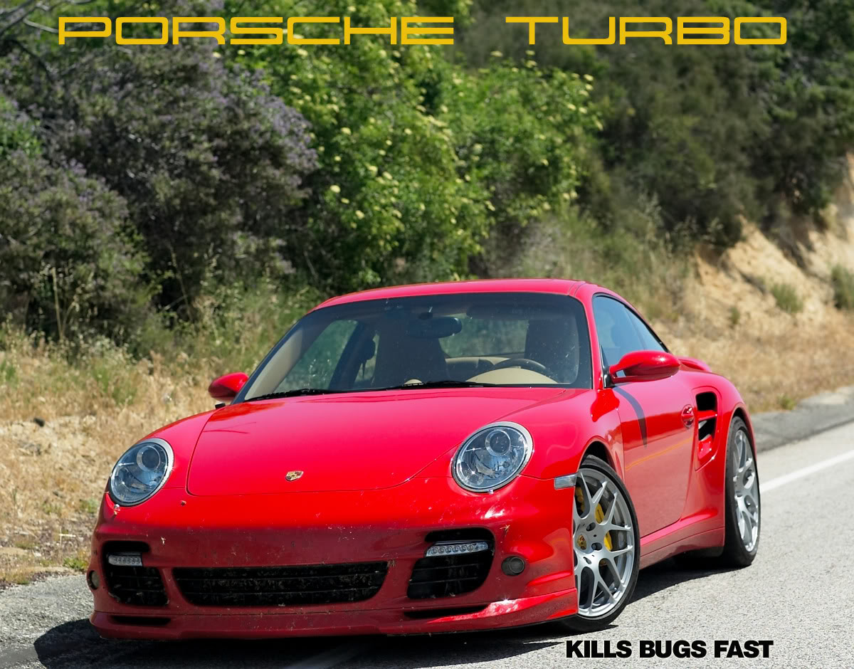

That pic above reminds me of this ad,
Yes, that's where the idea came from.
