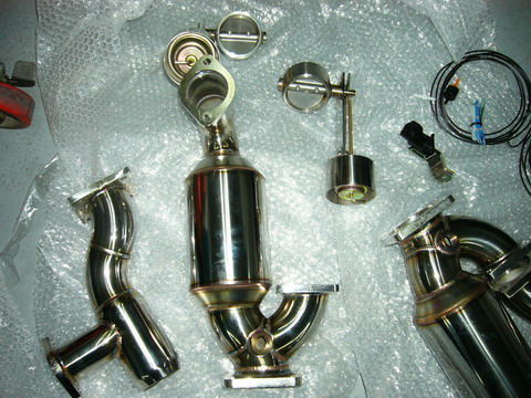

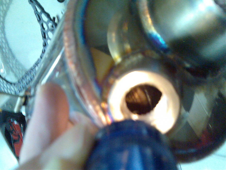

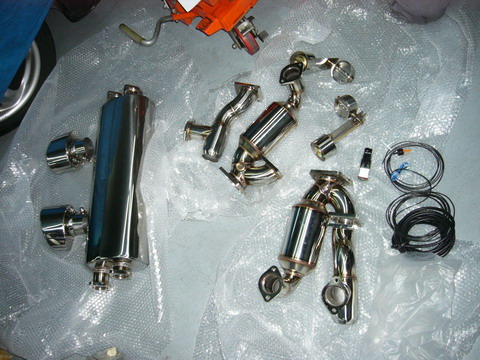

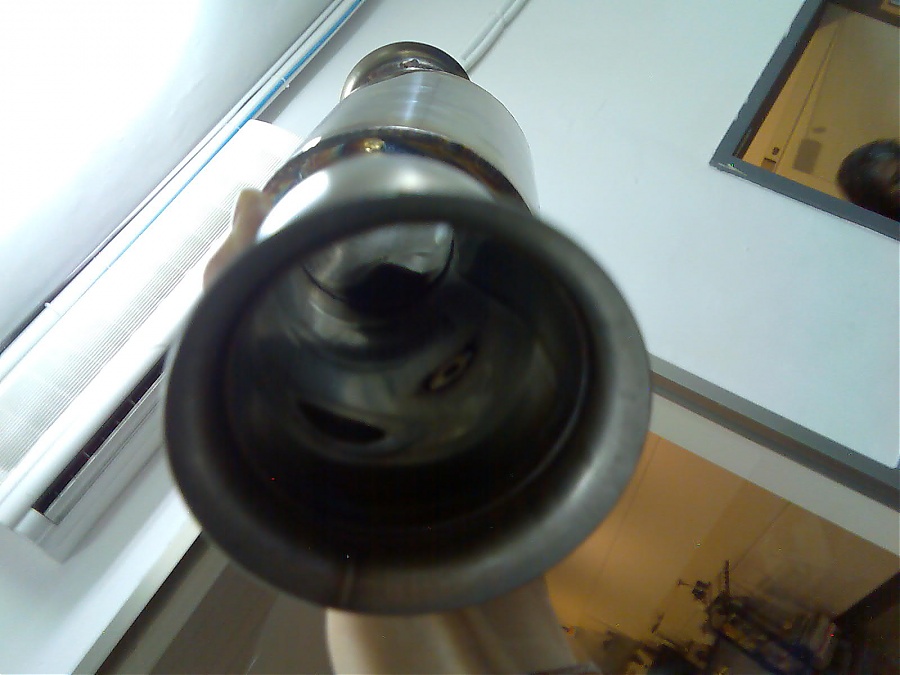

Originally Posted by S4corrado996TT
I see sorry!My friend SP620 also had bypass test pipe, but strangely with cat car performed better.
Do you want to see what is free flow valvetronic bypass type exhaust that my friend was using to replace Sportec's restrictive exhaust?
Attachment 75908Attachment 75909Attachment 75910Attachment 75911
this is my actual pipe 83mm no kat.
