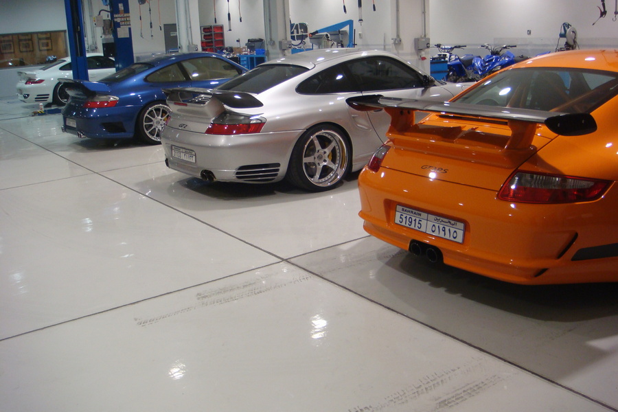

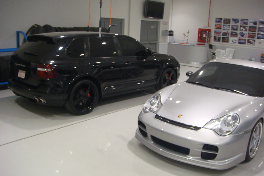

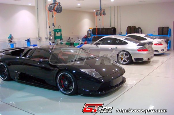

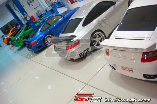

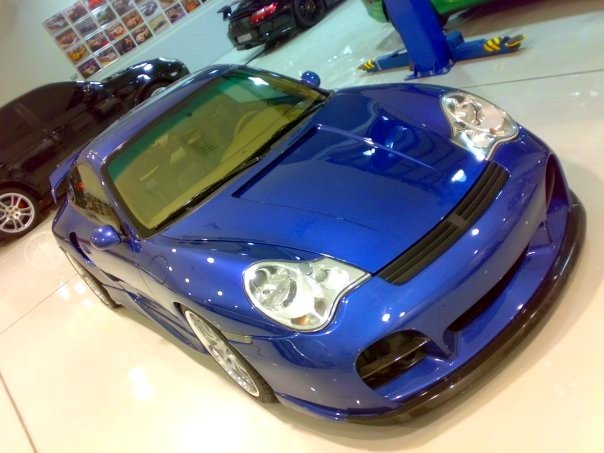

Our customer just saw the photos of his engine and here was his email to us:
"Ohh man what can i say, i'm speechless, its amazing!! It is so clean and I can't believe the craftsmanship and details in this build. I have done
many JDM engine builds in the states from really well knows companies from east to the west coast, but this Porsche engine is special. I can't wait to see what it will do on the dyno. Please thank all the guys that worked on this project, i'm so happy and now I can say that the wait was well worth it :-) Let me know when this baby is going to be installed in your car for testing. I am worried that after you install it, you won't want to let it go. LOL - EK"
Here are a few photos of his cars / stable
