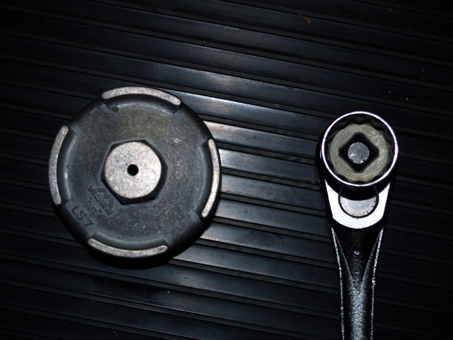

Oil filter wrench 000 721 920 40

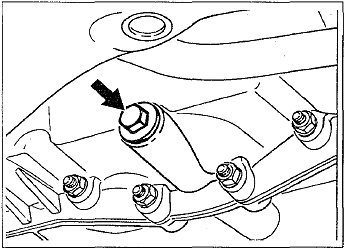

Use a ramp or jack up the vehicle at the correct points.Remove the oil drain screw and collect the engine oil in a disposal container (at least 9 quarts).

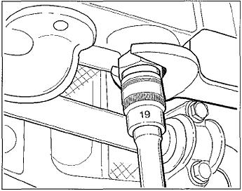

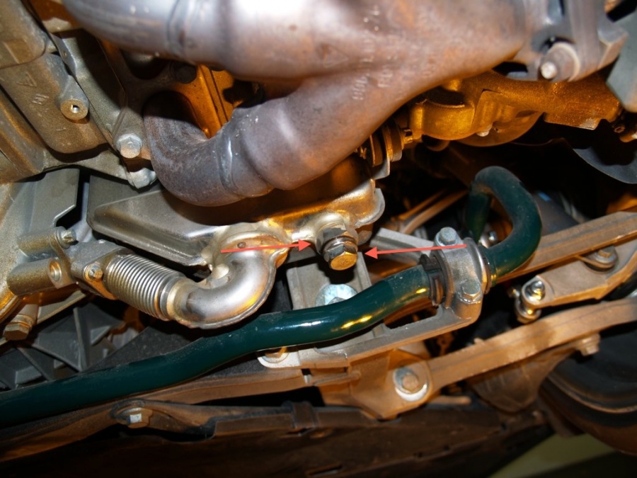

Identify the oil tank drain bolt and drain the oil over 20 minutes (44 lb-ft torque.)
Make sure you use a 27mm open ended wrench to counter torque the drain bolt.

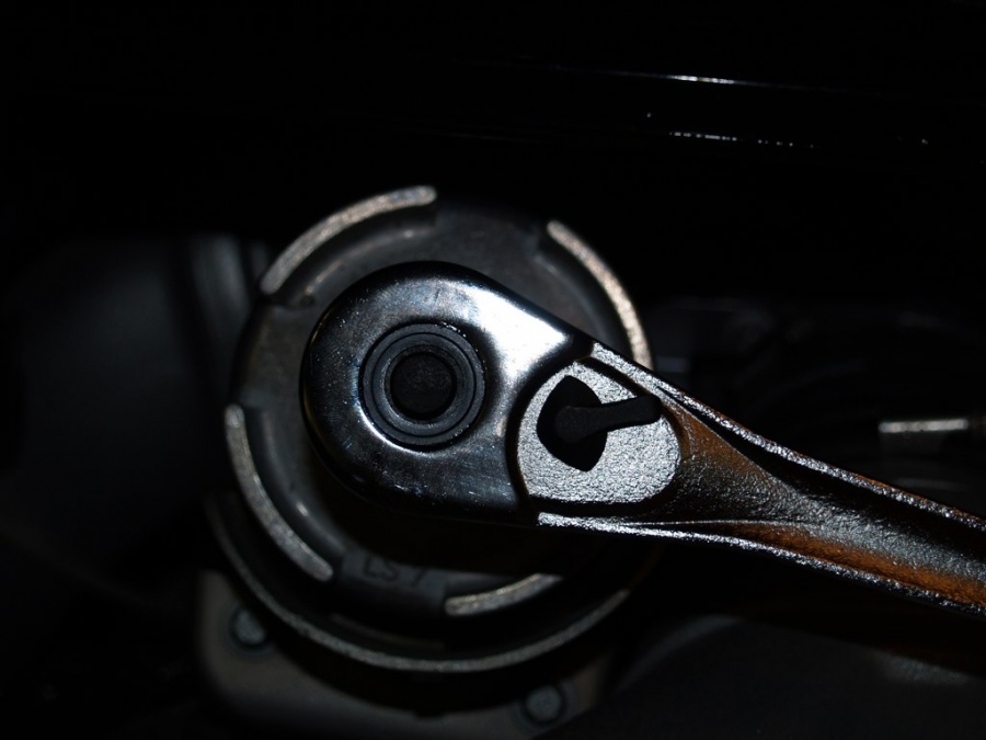

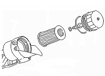

Remove the oil filter using wrench and socket:

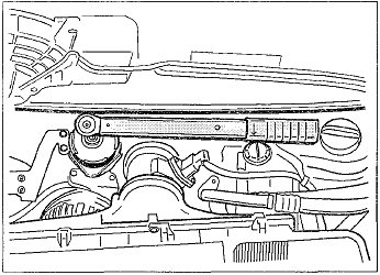

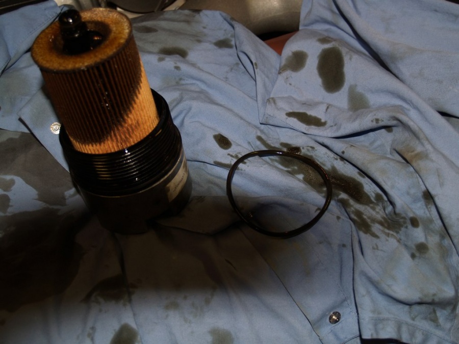

Next, Remove the filter, old O-ring seals, and replace...moisten the rings with a touch of new motor oil. Reassemble the filter, ring seal, and oil cap. Torque for the oil filter casing is 19 ft-lb.

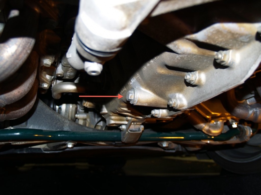

Finally, identify the crankcase drain bolt and drain the oil over 20 minutes (52 lb-ft torque.)
Once both bolts have drained completely reinstall the bolts with new crush rings, 44 lb-ft torque for the oil tank with the copper crush ring, 52 lb-ft for the crankcase bolt and aluminum crush ring.

One question on the oil filter wrench... would using a strap type wrench work or would a Porsche one be needed as there aren't enough room to use anything else?
Good write up, big help! thanks
If you can, get the Porsche oil filter wrench. I didn't have one and I tried literally 6 different types of generic wrenches from 2 different auto supply stores and even the one that eventually worked was not ideal. I now have a scratched up oil filter cap due to all the futzing around trying to get that darned thing off.Originally Posted by bli8
Just found this older thread and thanks for posting One question on the oil filter wrench... would using a strap type wrench work or would a Porsche one be needed as there aren't enough room to use anything else?

Looking at the tank I would guess it keeps you from bending it out of shape or possibly splitting a weld. It looks like aluminum and could be reasonably soft.Originally Posted by my996
What does counter torquing do?
Quote:
Thats correct...That nut has no purpose except for torquing the bolt...If you don't, you will surely snap the bolt off!Originally Posted by ruf_turbo
