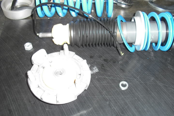

Hi Gary,
From this enclosed picture that you posted, I take it that there is a small (drkbrent) cone washer in the rear as well? Just curious and TIA.
Old Apr 6, 2010 | 02:28 PM
  #42
Gary@G Rides's Avatar
Joined: Aug 2006
Posts: 233
From: San Luis Obispo, CA
Gary@G Rides has a reputation beyond reputeGary@G Rides has a reputation beyond reputeGary@G Rides has a reputation beyond reputeGary@G Rides has a reputation beyond reputeGary@G Rides has a reputation beyond reputeGary@G Rides has a reputation beyond reputeGary@G Rides has a reputation beyond reputeGary@G Rides has a reputation beyond reputeGary@G Rides has a reputation beyond reputeGary@G Rides has a reputation beyond reputeGary@G Rides has a reputation beyond repute
Originally Posted by cannga
Hi Gary,
Correct, once Coilover is assembled you really can't see it.
Hi Gary,
cannga < i just installed my bilstein damptronic for my 997 turbo the ride is a bit hard but im fine with it, the worst part is I forgot to put the small washer all 4 side of them. will it affect the handling or will I get in trouble in a long run?

wowowow, i just saw the other post by drkbrent.
so the shock rod really snap because the installer forgot to put the "magical washer"???
indo, isn't this some kind of a joke? If you are serious and if we are talking about the same cone washers, yes you need to immediately get the car on lift and off any weight bearing - NO MORE DRIVING without the washer!
A couple of questions:
1. How much have you driven the car without the washers? If you have, the shafts might have been bent, weakened, or damaged already. Get them inspected, especially at the neck where the washers are supposed to be. Good luck!
2. Did you buy this Bilstein coilover new? I thought new ones now come *with* the washers so that it's almost impossible to miss them?
