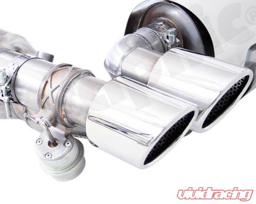

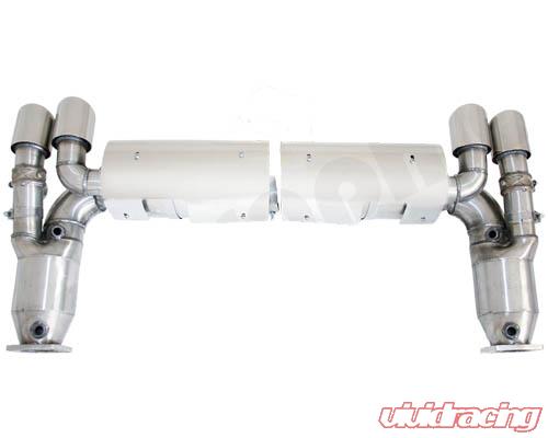

This is the more expensive **DUAL** version of Cargraphic that would be very nice for someone looking for a combination system.
The system has a flap that bypasses the muffler when you want more sound and an extreme free flow system (important for car with ultra high power mod). In one mode, exhaust goes through the cat and muffler as normal. In the louder mode, some exhaust bypasses muffler completely. See pics below.
It seems you have the quiet TUV version with flap? This means dual: quiet + medium, implying best of both worlds. If the quiet mode indeed does sound like a PSE on a C2S 997, then it is indeed supremely fine sounding. ***If I don't have one already I would buy this. No kidding.*** Anyone with a 997.2 Turbo who is looking for a combination system should jump on this immediately if price is good. Anything below 3000 is a steal - plus 6% commission to me. 2500 would be highway robbery. 2000 my commission goes up to 10%. He he.

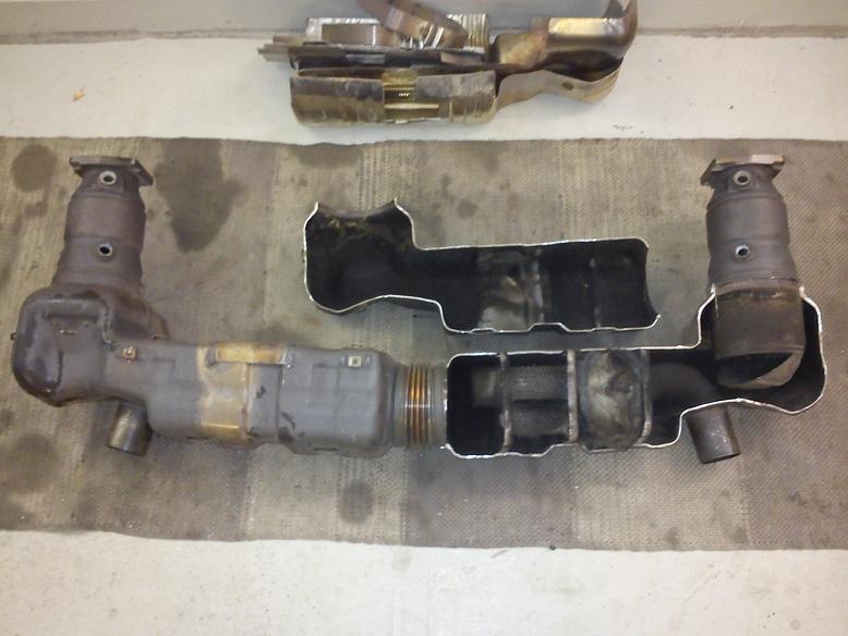

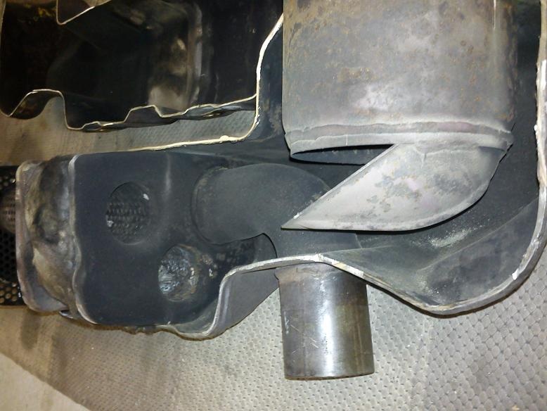

Yes, get in touch w Rhonda . It's louder than stock, slightly less than tubi and regular fvd.
Here's some some images of a 996tt exhaust (pete95zhn), the 997 is very similar but different.
What ruf does is remove the two stock cats and replace with a 100cell hjs hd cat and dog leg a second outlet off the j pipe. They also dilate the secondary resonator pipes on a 996, these are already bigger on a 997 p, therefor not required. The key is removing the two restrictive factory cats and the clamshell, which is exactly what fvd does, and replace with the hjs hd 100 or 200 cell cat. Fuchs in Munich is the company that does it for Ruf, they do a slightly different version for fvd in conjunction with mm, also in Munich. Contrary to previous information, either fvd or ruf both use your used core. Ask anybody who's actually done a ruf conversion, ie my brother for one.
I have other vids I'll upload tomorrow.

More images
