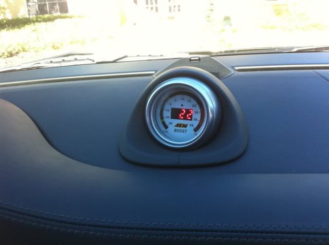

I just completed a digital AEM boost gauge in my factory chrono pod.

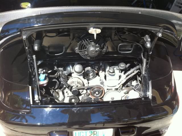

It was a tight fit getting to the fpr, even with the intake and y-pipe out, it was a little bit of a struggle.

^^nice. How did you get the lines back to the gauge in the pod? What did you physically do with the chrono clock?
Old Nov 25, 2010 | 09:13 AM
  #55
PacMan Z's Avatar
Joined: Feb 2008
Posts: 590
From: America
Rep Power: 53
PacMan Z has much to be proud ofPacMan Z has much to be proud ofPacMan Z has much to be proud ofPacMan Z has much to be proud ofPacMan Z has much to be proud ofPacMan Z has much to be proud ofPacMan Z has much to be proud ofPacMan Z has much to be proud ofPacMan Z has much to be proud of
I pulled out the rear Bose subwoofer and the panel that stretches across the bottom of the back window. With that out you can then finally pull out the rest of the carpet/padding that will expose the rest of the rear shelf. There is a grommet/access hole that leads to a location in the engine bay that is directly above the fpr. This hole is nearest the rear glass on the pass side.
As for the factory chrono, I took it out of the housing pod, put a cover over the glass and tucked it inside the dash with it still plugged in to avoid error messages. It took several attempt to fish the boost line through the dash to the floor board but eventually i made it work.

Where does it draw power?
Old Nov 25, 2010 | 10:31 AM
  #57
PacMan Z's Avatar
Joined: Feb 2008
Posts: 590
From: America
Rep Power: 53
I went into the fuse box. Same place I used for the K40.

the Aem boost gauge is really good, but i am afraid it has no bar indication only psi... The good thing is that this doesnt use the obd port though...
any nice white digital gauge with bar indication ?!
Old Nov 29, 2010 | 11:44 AM
  #60
PacMan Z's Avatar
Joined: Feb 2008
Posts: 590
From: America
Rep Power: 53
You are correct, it reads only PSI.
