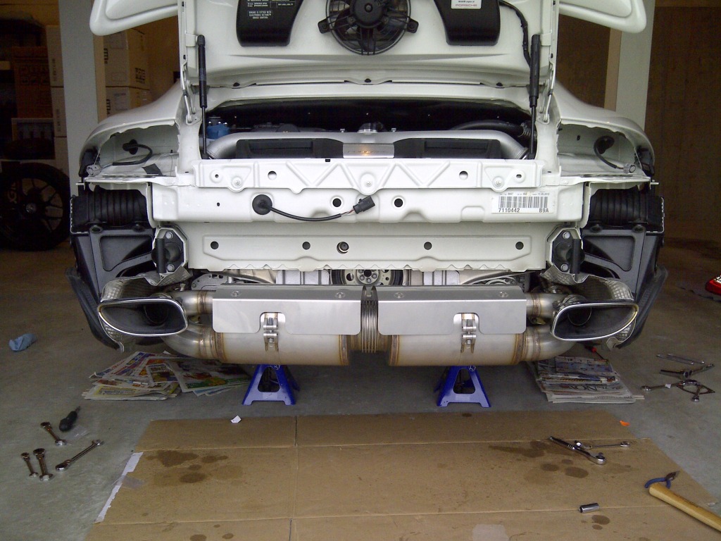

I installed the exhaust myself. Fitment is perfect! And I mean bang on. After all the issues I had with the custom 200 cell cats and to have these test pipes fit perfectly my eyes started to tear
If I can make a suggestion. You will need a special tool to access the half sized bolt that hold up the large heat shields. There is no access as the turbo is in the way so you will need some kind of crooked specialised tool. You'll need to drop the heat shields in order to access the 02 sensor wires.
Let me remind you I am running an OEM tune. With windows up there is no drone with the exhaust. I am amazed that with being catless there is nothing of that sort. If anything it is as much drone as the stock exhaust. I hear more road noise from the tires than anything else. The turbo whistle has gone from non-existent to now an apparent reality. It really takes driving to a new level. The sound of the exhaust is now more Porsche like. It has a beautiful raspy but throaty tone. It screams at WOT more so than the Shark Werks did. In all honesty I wouldn't mind if the exhaust was a bit louder and had some drone. However, Stef advised that once I get an aftermarket tune the cam timing will change, turbo vanes will open up more, and exhaust valves will stay open longer which, will make the Europipe louder and scream more at WOT. Regardless, I love it and I'm really glad I did not go with the 100 cell cats. Anyhow, I'll let the pictures and videos below do the rest of the talking. One thing that we never have enough of are good videos of the Europipe exhaust in action. I tried my best to remedy that.

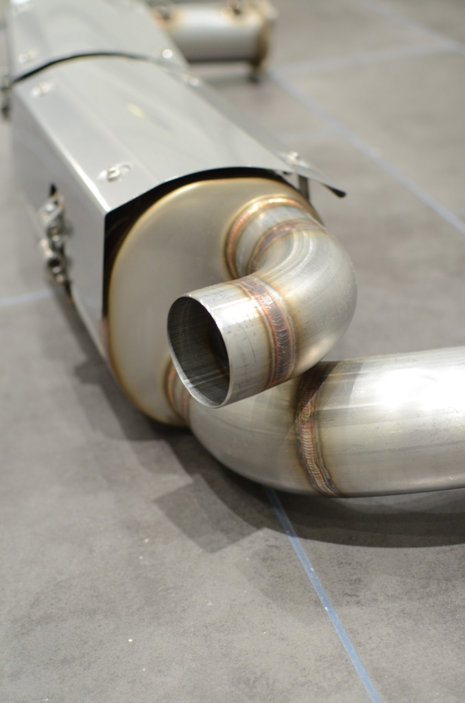

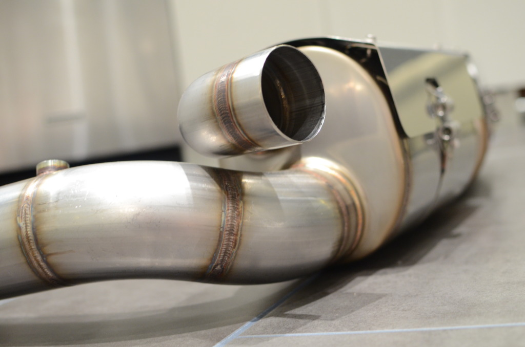

Check out those welds
