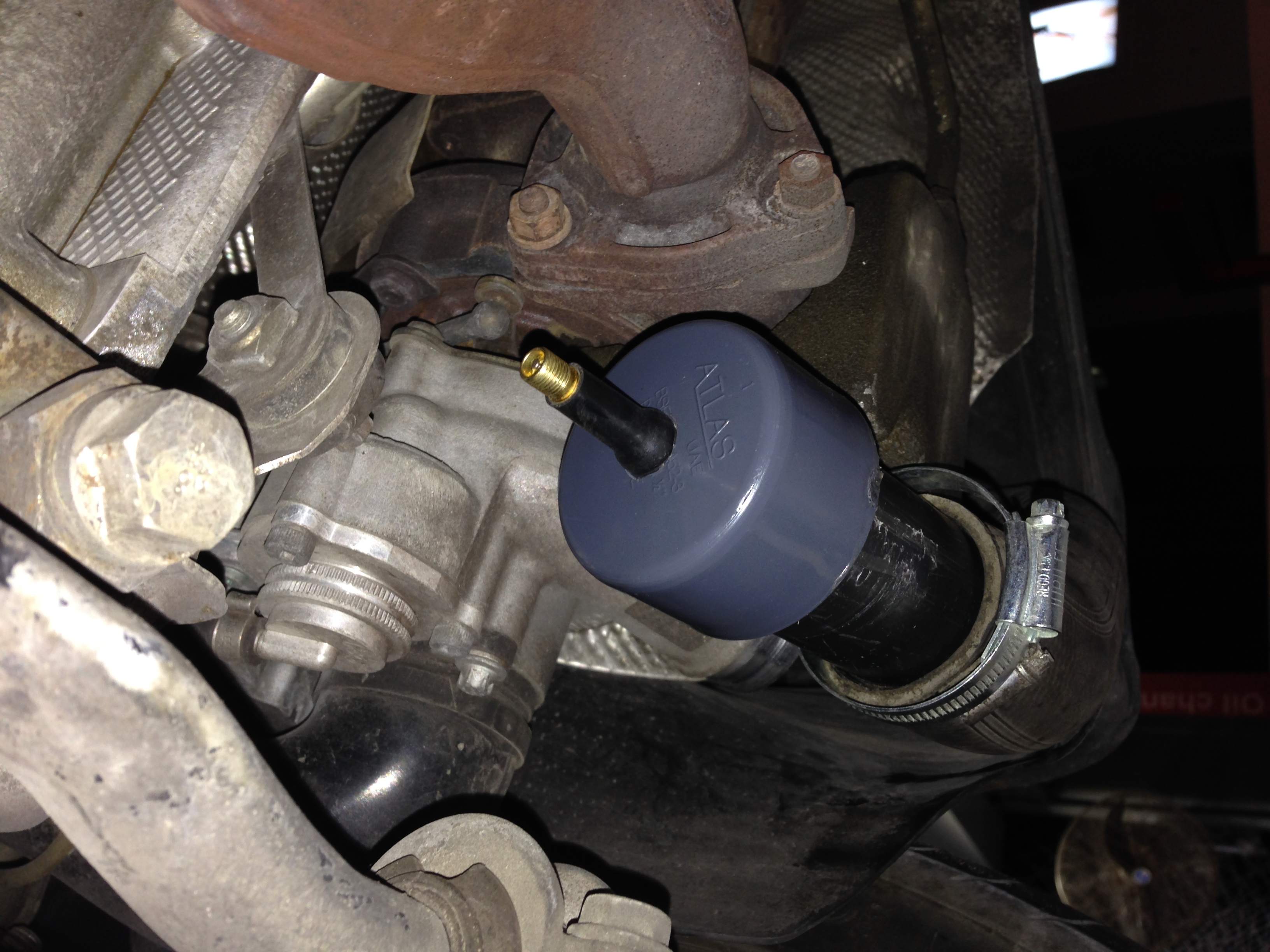

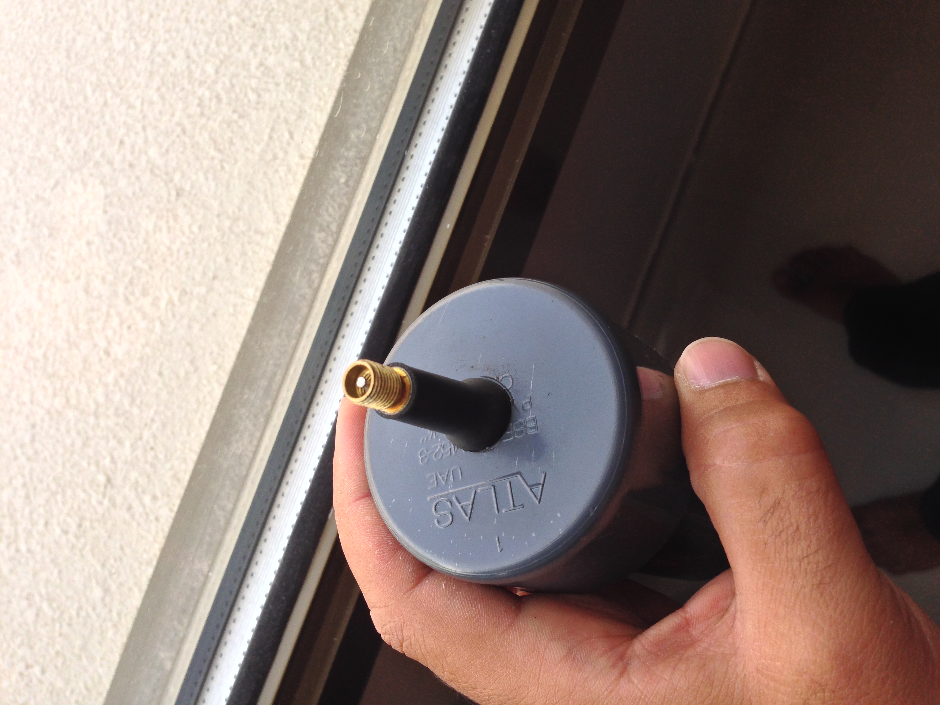

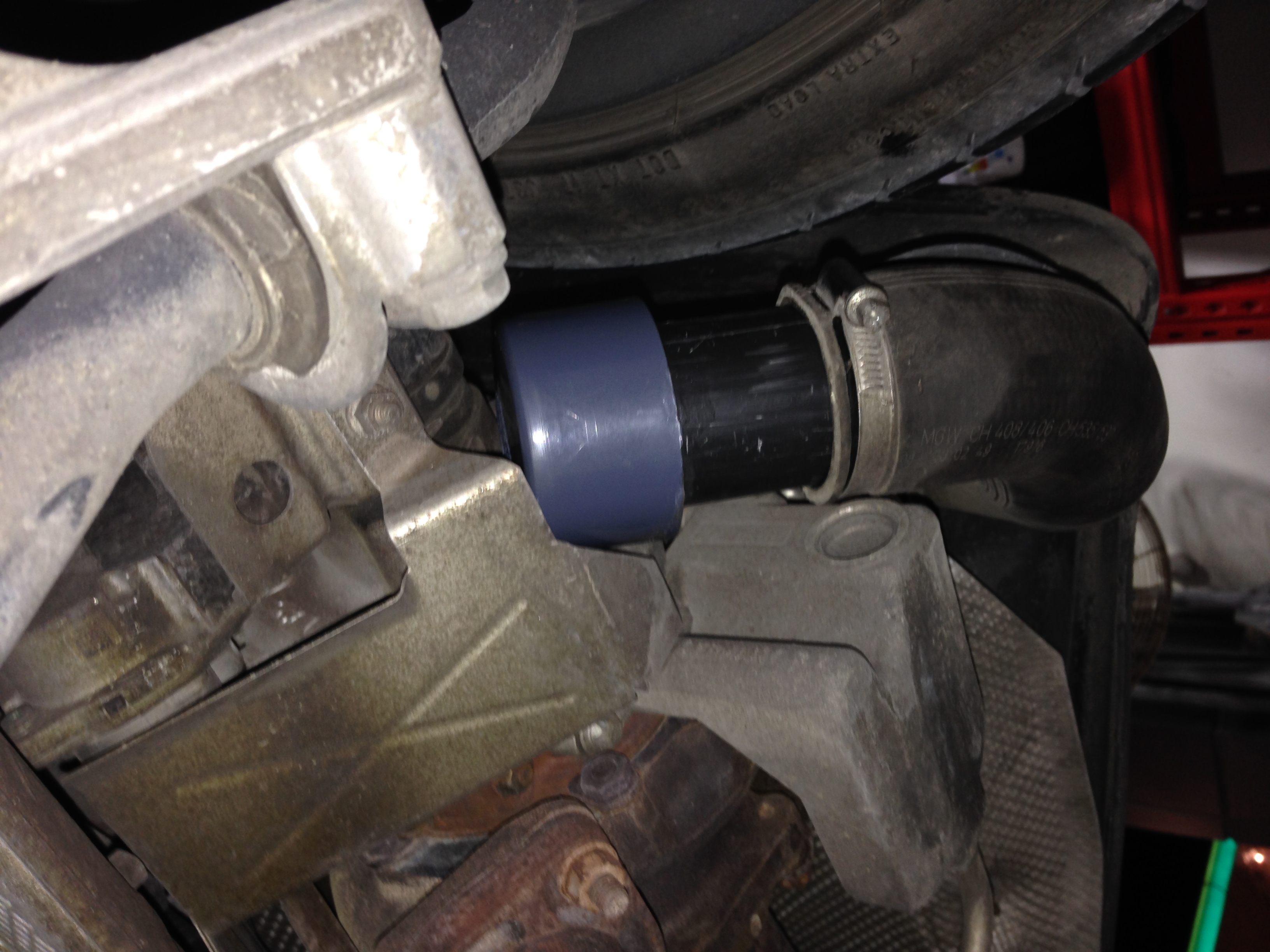

Thumbs up Pictures + Tools + Steps

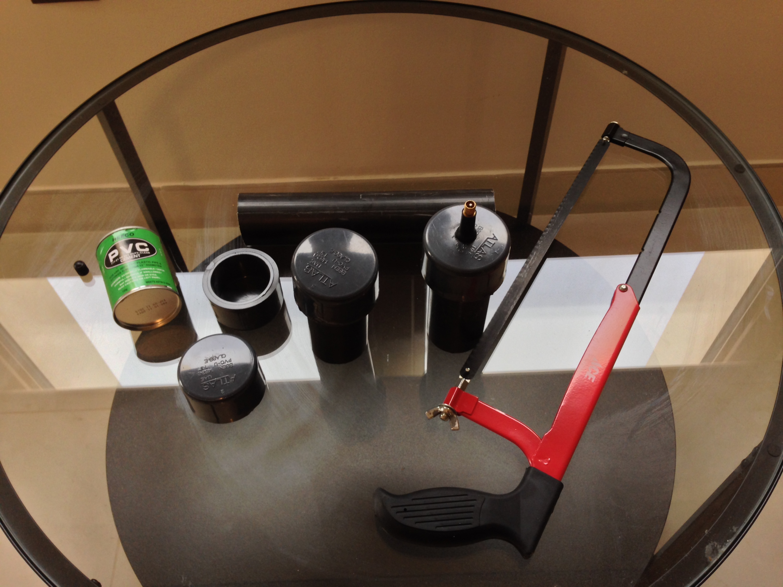

Tools Required:
1- 1.5" PVC pipe (I purchased 1 Meter; however 60CM is way more than enough)
2- 1.5" PVC End Cap (1 for the pressure side, 1 for the non pressure side)
3- 1 standard size compressor fitting

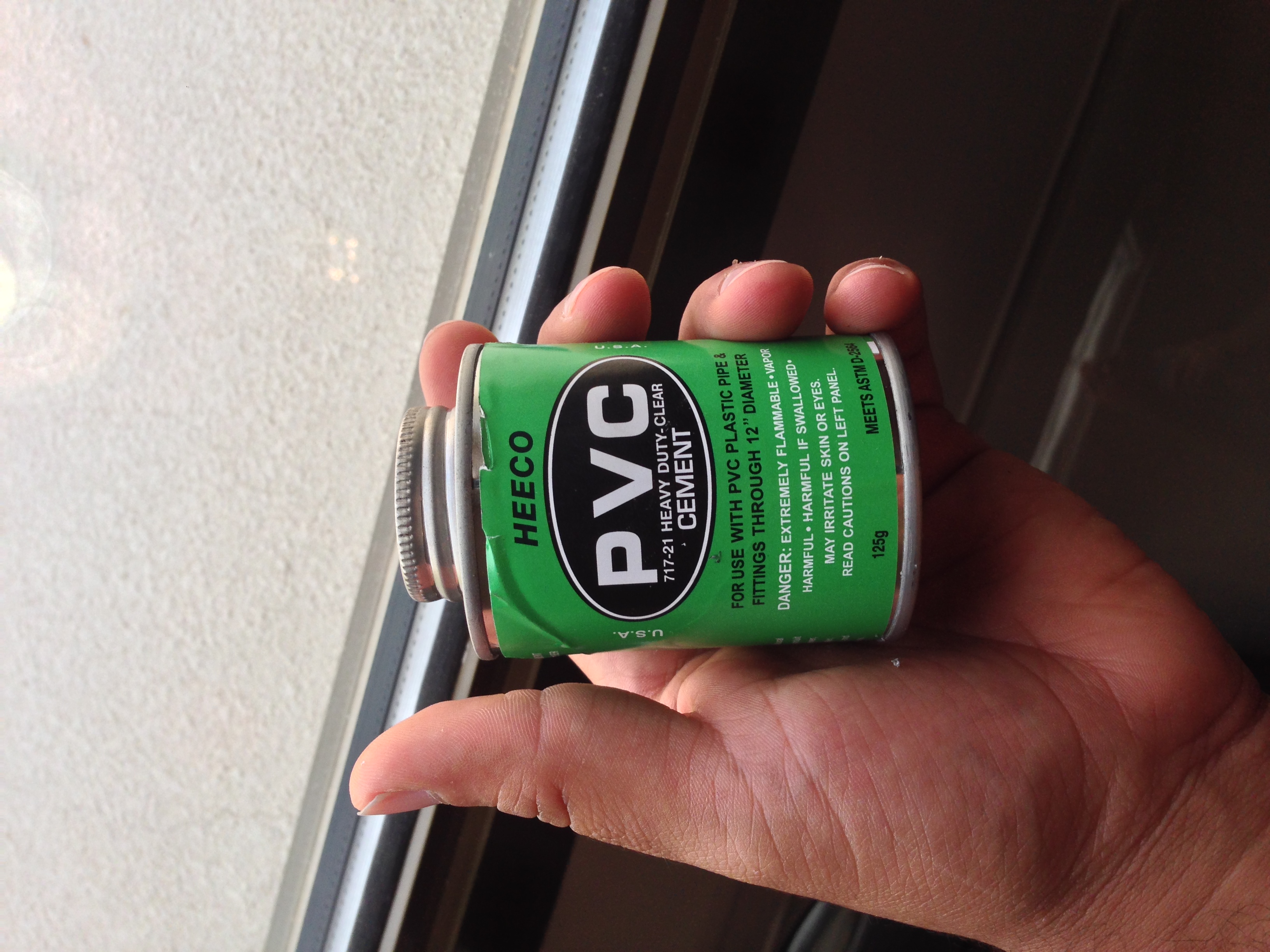

4- PVC Glue

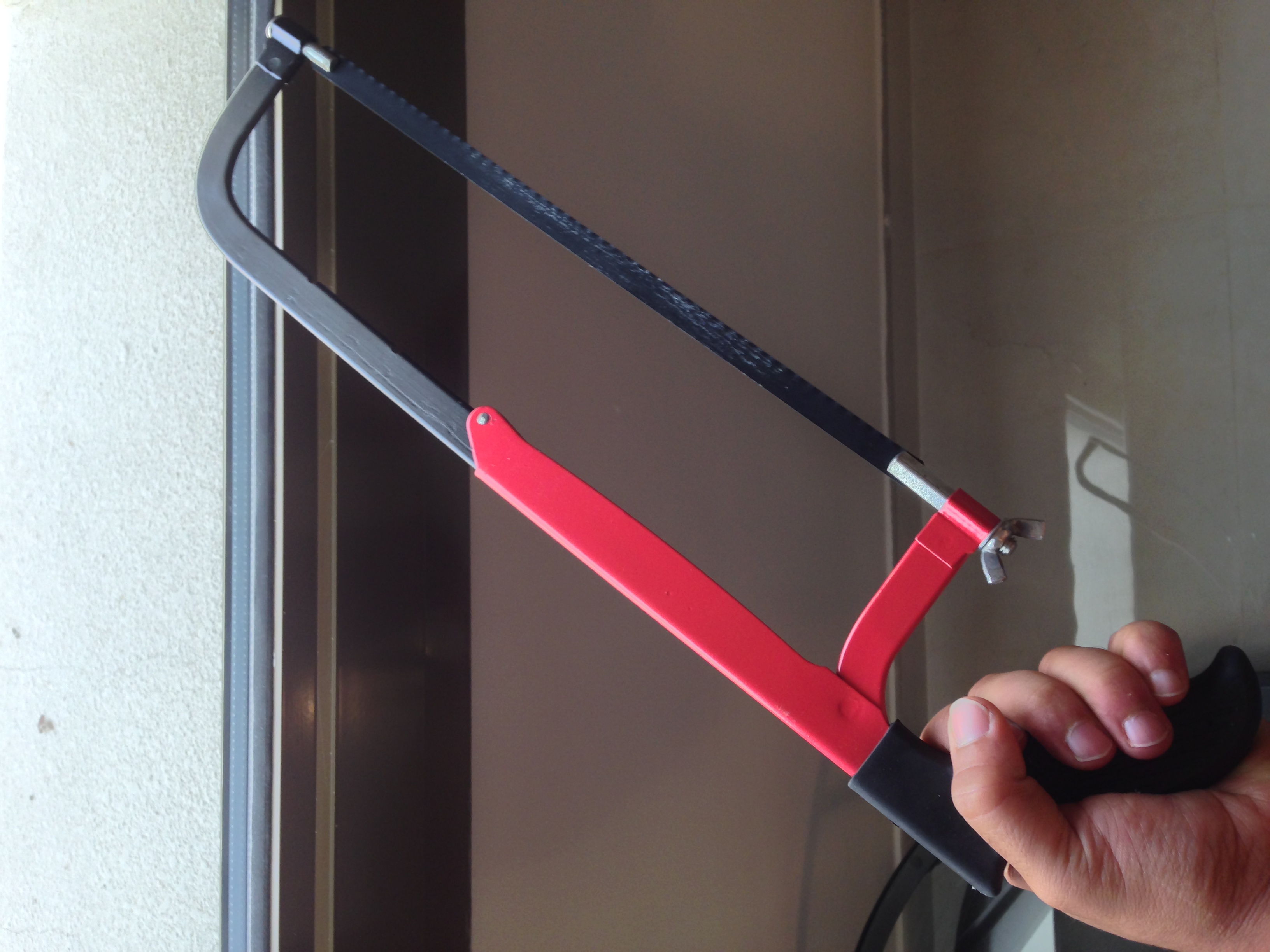

5- Small Saw to cut the PVC
6- Drill to create a hole to insert compressor fitting (I just passed by a tire shop and had him do it)
7- Compressor capable of 25+ PSI.
8- Jack or Lift (I used the lift at a tire shop)

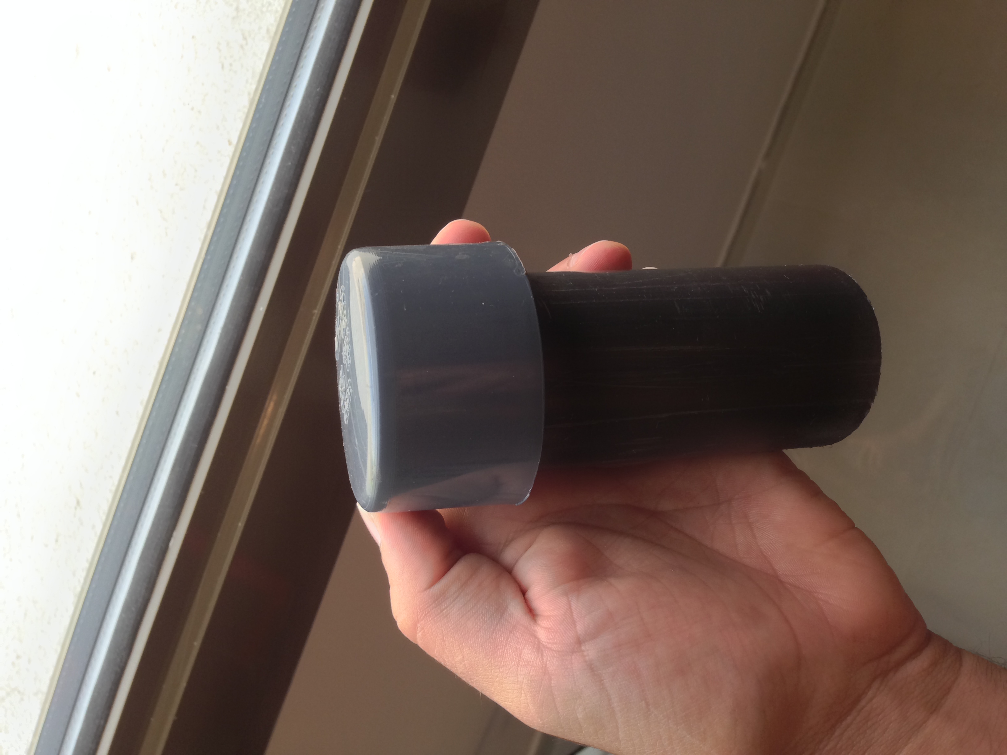

Steps to create the tool:
1- Cut two pieces of PVC around 30cm to be safe (you can adjust after fitting to the hose).
2- Using the PVC glue attach 1 end cap to 1 end of each PVC (The other end of both PVC's should be empty)
3- Drill hole in one of the end caps to install the Compressor Fitting.
4- Untighten the clamp on the intercooler hose (from the turbo to intercooler) remove the hose slightly off the turbo. Repeat for other side.
5- Install the PVC pieces to both sides.
6- TIGHTEN down clamps on PVC pieces.
7- Start adding pressure from Compressor fitting side. I recommend starting at 10PSI, 15PSI, 20PSI, 25PSI DO NOT EXCEED 28PSI.
Time for creating the tool: 20-30Mins
Time for testing: 20-30Mins
Complete process: 1 Hour
Money saved in my case: 200$
My main objective was to test the intercoolers for leaks, so Emre recommended I remove the intercooler hose going from the turbo to the intercooler on both the right and left turbo's.
After removing the hoses you will push the tools into these hoses (1 side with the compressor fitting, the other with the end cap). Make sure you tighten the OEM clamp hard enough on the tool; there is always a chance that the tool can pop off and cause some damage so I recommend having one more person hold down the end cap side to be safe.
Note: I think it is very critical not to pressure test from the Y-Pipe hose into the turbo as this may cause serious damage.
I have attached the images for your reference, however if anyone has additional questions feel free to ask.
This process may harm your car; the above is based on my experience. Proceed at your own risk
NOTE: I am not an expert on this matter; so if someone would like to add some additional information that will benefit everyone please feel free to do so
Name:	Boost Leak Test (1).JPG
ID:	368959   Click image for larger version
Name:	Boost Leak Test (2).JPG
ID:	368960   Click image for larger version
Name:	End Cap Side.JPG
ID:	368961   Click image for larger version
Name:	Pressure Side (2).JPG
ID:	368962   Click image for larger version

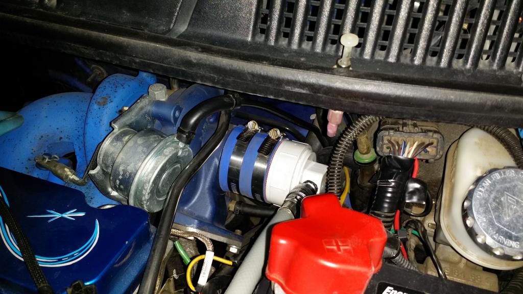

This thread should become a sticky. The only thing I did differently was making the tester out of metal pipe. Also I find a permanent compressor fitting worked better for me. This way I can continually flow a steady 25-30 PSI.
Here is a tester I made for my SRT 4 turbo. It has a quick connector so I can hook my compressor to it. Keep in mind air leaks out slowly and naturally through the motor so I find it helpful to keep the air supply connected during the test. On this car it was tested at the input of the turbo but with our Porsche the inlet is bolted to the turbo and thus not so accessible. That is why it is easier to do it as shown by Tereg
