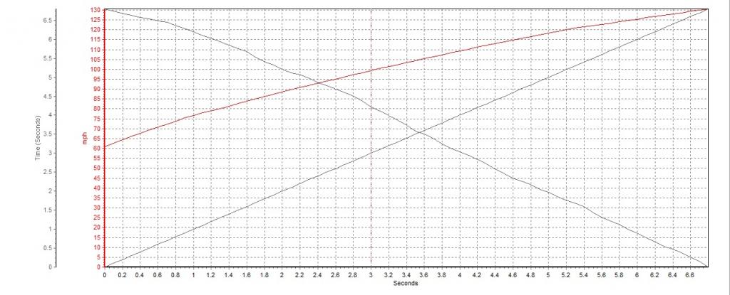

Originally Posted by yumaverick
Thomas,
Did you guys get any vbox data from this weekend? 60-130?
I was able to get the vbox on the car for a couple runs at Shift Sector. Elevation was just over 400 feet, temperatures at 90 leaving us in a sauna-like density altutide of 2800 feet
Vehicle is full weight, OEM tires and wheels. We also dialed back the power slightly, as we have a good knowledge at this point of where this setup will begin to stress the connecting rods. Power was at 660 whp and 660 wtq for these runs.
I'll have some more runs soon in a more favorable DA, so we can see what the stock motor setup can really do.
6.76 60-130
0.7% decline
6.76 60-130
0.7% decline
6.76 60-130
0.7% decline

Originally Posted by The Bogg
nice! I presume this was the car mentioned in your first post with the full package?
I've done some runs in temperatures like this and it definitely makes a difference compared with temps in the 50s and 60s.
Correct, it was the car mentioned in the first post with the supporting modifications (inlet pipes, injectors, intercoolers). As I said, for this run the car was turned down slightly from the original dyno due to it being stock motor and the torque coming on so early. We were right around 660 whp and 660 wtq for this run, 22-23 pounds of boost.
