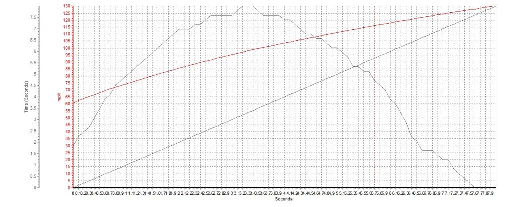

I was able to pull this run from the setup noted on the original post. This car has:
Champion 68mm Turbos
GIAC ECU Software
GIAC TCU Software
Stock Turbo Inlets
2.5" Exhaust
Stock Injectors
100 octane fuel
This run was taken from No Fly Zone Airstrip event in Bakersfield, 03/02/2013. Temperature at this event was 82 degrees, at an elevation of 424 feet. This gives us a density altitude of around +2100 feet. You can see that even in a higher density altitude, the car shaved off over a second in the 60-130 by adding the air and fueling supporting modifications.
Champion 68's, stock fueling, stock inlets: 7.99 60-130 (+2100 DA)
Champion 68's, upgraded fueling and inlets: 6.76 60-130 (+2800 DA)
