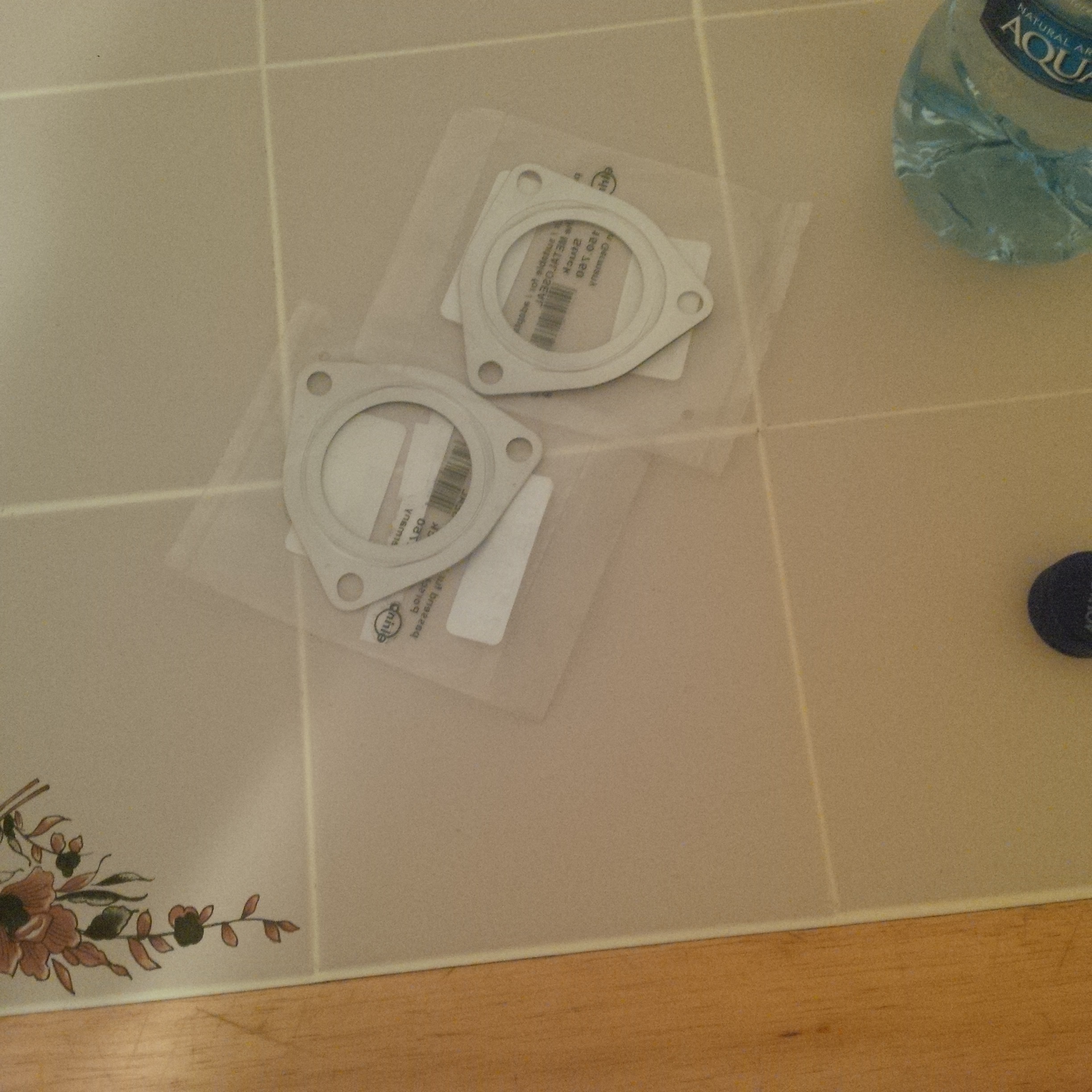

found the problem. the actuator was fine. the passenger side exhaust gasket (the one that connects to turbo to headers) blew out. i have a replacement in hand, will do it tomorrow w/ Tim.
Thank you ECS. Ordered these on wednesday and they got here this morning. perfect timing.
Glad you found the problem...and nothing serious. If you do not get them snugged up just right, the pressure blows the corners off pretty quickly. Surprised you did not hear it? I have had a header gasket go on me (after Dealer installed!) and it sounded like a 1970 truck with busted muffler
