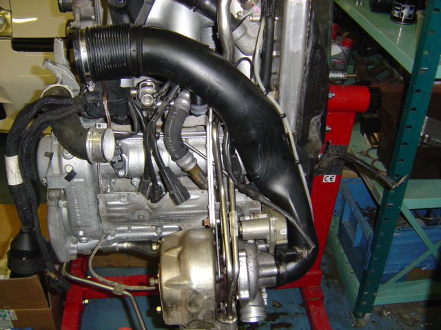

Steve make sure that plastic intake air lines from turbo to air box are push all-way down in the engine compartment.

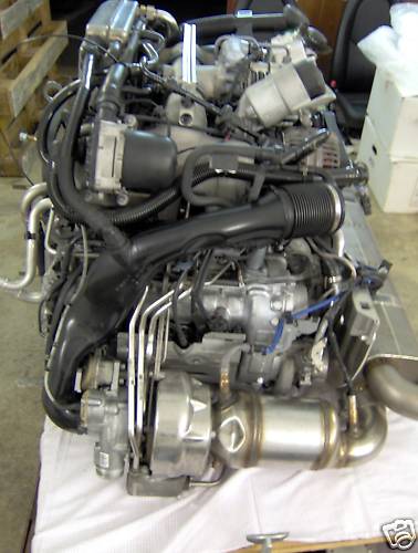

no the tubs that runs from air box through the engine on right and left side to turbos ,make sure that they are push all the way down and that there is no air leaks
