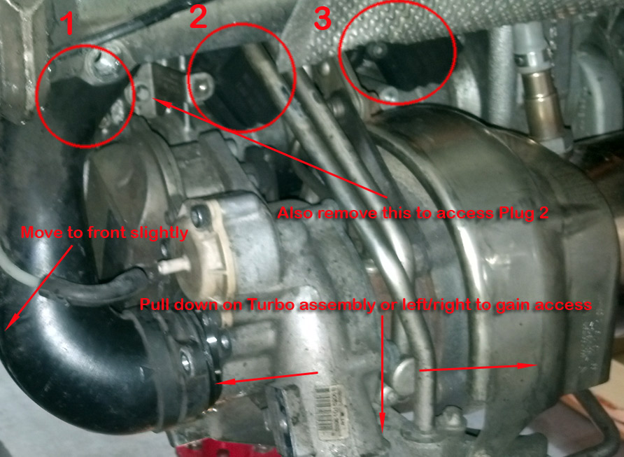

The dealer and Indy's are telling me the plugs are 5-6 hour job. They say the engine needs to be dropped in order to reach one of the plugs.

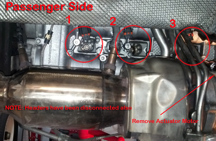

I hear ya...if they drop it then certainly get other stuff done...However, I have done it a couple of times and wrote a DIY on how to do it....complete with photos....also got access to the Porsche WM....and engine does not come out. It helps to lower it an inch or so....Just FYI..Maybe I saved you some money$$$?
Good luck,
DC
