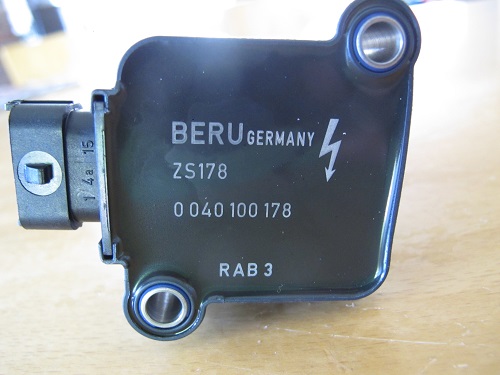

Hi...
On the Coil Packs, when I changed mine, I used the Bosch equivalent (see picture). They fit perfectly, were easy to find, cheaper, and so far running like a champ.
Good luck.
DC

Thanks for the tip Rock. Did you reuse the mounting screws or get new ones?

I just swapped mine to those same Bosch.

did you reuse the mounting screws?
Good to know there are options. It doesn't look like there is a huge price difference between the Beru and the Bosch depending on where you get them from...

Hi There...Yes, use the same mounting bolts. These are the exact coils for your application, and you will have no issues mounting or running them.

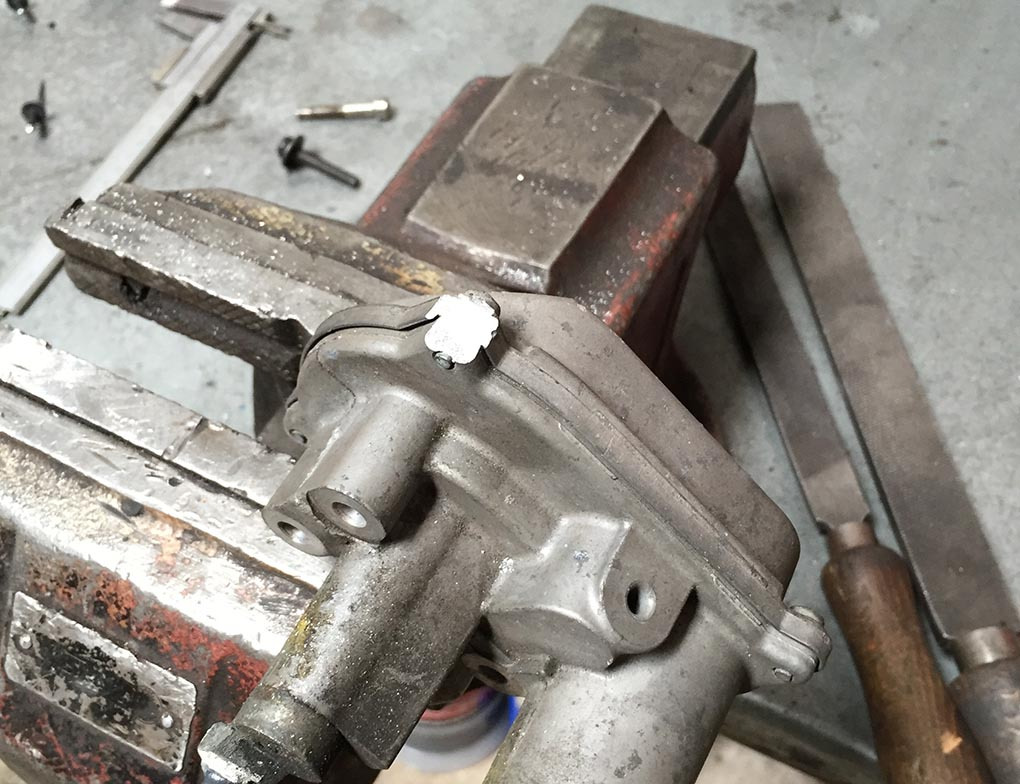

Don't you need one of the older thinner coil packs because it won't fit in the available space? Cylinder 6 maybe?

I bought these at the dealer and they came with the mounting screws.
99760210402
They are indeed thicker than the original part number.

I'm shopping for replacement coilpacks for my 2007 997 tt. The original part is 99760210400 and it looks like there is a revised version which is part number 99760210402 which requires longer bolts. I haven't been able to determine what the difference is and I'm trying to decide which set to get. Anyone have any opinions?
I placed the newer thick coilpacks on my 2007 turbo. At Cyl 6 there is not enough space. You have to adapt the turbo adjuster a little
The picture shows where to adapt the adjuster.
The new longer bolts came with the coils
Regards

Hans, what did you modify to make it work. My dealer is recommending the older thinner one for cylinder #6.

Hello Johnny DB
The pictures I copied from the German PFF Forum.
They show the, thick coil, adapted adjuster and a modified bolt.
Regards, Hans
