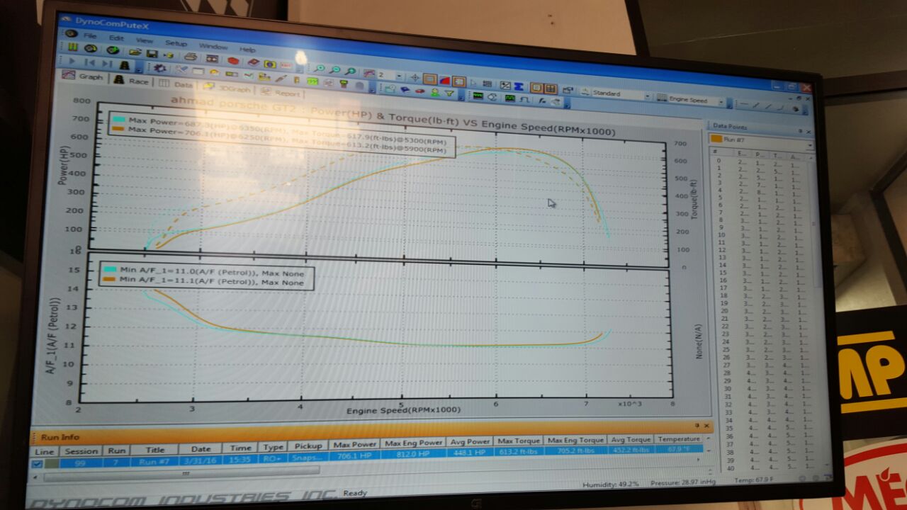

last week the owner of this champion turbo took it to the dyno,she puts 610whp with 50/50 pump/ms109.then he decided to let Todd.K @Protomotive to retune it.this is the graph after proto tune.sorry i dont have the first graph before proto tune.Proto tune adds 96whp with same fuel.
Just wondering if they did a before and after dyno on the SAME dyno?
How old was the GIAC/Champion tune?
As I know everyone in the 911 world has gotten more aggressive with this platform as we now understand more about the strengths and weakness.
I am not taking ANYTHING away from Protomotive (as my car is a Proto car) as I believe Todd is/has been a pioneer and a leader of the 911 platform overall, BUT there is enough mis information on forums not giving true delta differences between upgrades/tunes.
Champion/GIAC is also long time tuner that Has my respect for developing turn key, all around performers. I had a full AWE/GIAC STG 3 package on my 02 S4 and it performed all day everyday as if Audi would have designed and made it. Could I have gotten a custom tune to squeeze out more? For sure, but for that vehicle I wanted everyday reliable performance fro a proven long in the profession tuner.
Either way if it is a net of 96hp above, that is amazing and would say good job to Todd!
yes sir same dyno 1 week difference
Very nice,
Do they know how old that tune is and if GIAC has any updates?
Also the GIAC tune was it a tune tuned specifically for 50/50 race/pump as Protomotive custom tune?
Or was it a pump gas tune with just 50% race fuel put through the tank or was it a race tune with 50/50 pump/race?
I am getting Todd to look at doing a recal on my car shortly as now have upgraded ETS intercooler! Hoping to squeeze some more out of her on pump and my E85 tune!

Very nice,
Honestly no idea about Giac/champion tune on the car ,but we datalog it on pump and saw lot of timing pull so we tried the 50/50 which was great.so we stayed with same fuel when Todd tuned it to see what gain we have in the same conditions.
