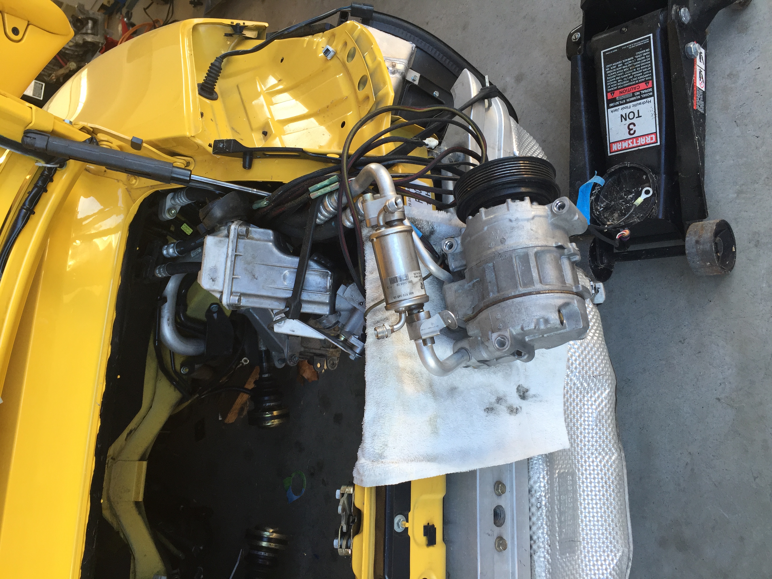

are you wanting to pin the lines or weld them? pinning can be done with the motor in the car , welding requires a drop
if you drop it i would suggest new clutch , replace every rubber hose you can find, every vacuum line and tie wrap every single line you can find. inspect the fule lines for age and wear and replace them if you need to. get the sharkwerks billet coolant pieces and replace them. also at 56 k miles it wouldnt hurt to replace the water pump and thermostat.
its simply maintenece that is near impossible to do with the engine in and since the car is boderline 10 yrs old rubber ages and under boost fails. none of it is high dollar just a high pia!!
heres a tip. remove the power staeering pump and reservoir and the a/c compressor from the motor. leave the lines attached. bungee cord them to the back of the car and drop the motor without them. now theres no need to recharge the a/c or rebleed the p/s pump.

which is the better route to go, welding or pinning? Any examples of either? I see the 3 pcs that sharkwerks sells and they look solid. What else gets replaced with the coolant fix?

Pinning keeps the fitting from bursting out but not leaking if the glue fails. If you weld then a full install of the parts and pressure testing is needed to insure no pinhole leaks. I have done both. On the 997 i think 7 fittings and the sharkwerks fix
