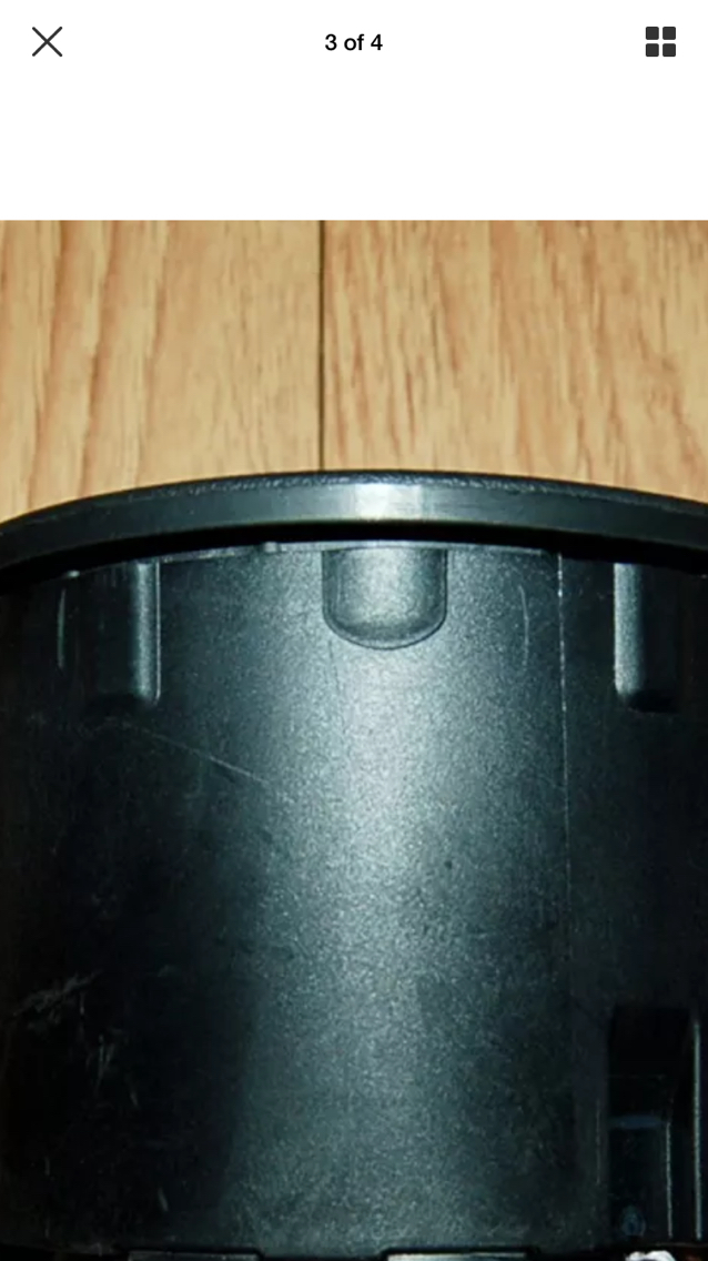

I think my airbag has been modified or a different cover has been put on it. I am trying to find the pics of the airbag before I sent it out to be wrapped. The sticker is not on the airbag and I think it was before I sent it off. The airbag does not fit well. The wheel and module install I did and went very well.

[quote=ocmacman17]I think my airbag has been modified or a different cover has been put on it. I am trying to find the pics of the airbag before I sent it out to be wrapped. The sticker is not on the airbag and I think it was before I sent it off. The airbag does not fit well. The wheel and module install I did and went
I think the problem is the leather on your airbag went around the cover.

Also, make sure the wire is tucked in the groove or that will stop it from sitting in.

the airbag should be more flush...
i have seen plastic air bag covers being sold on eBay, so there may have been a some funny stuff going on?
