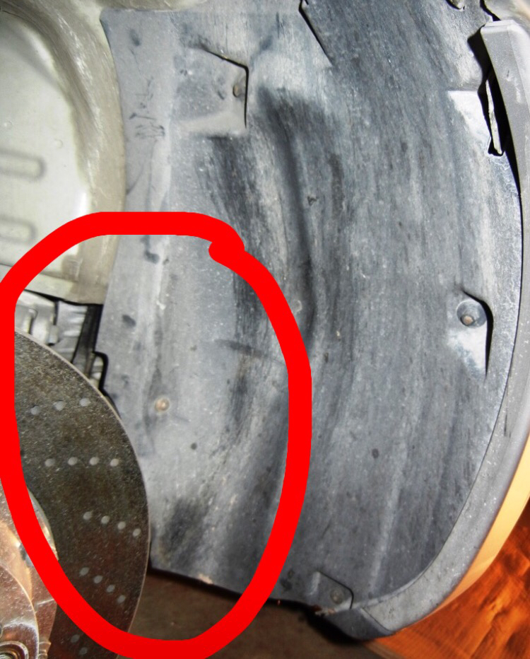

Check the plastic pipes each side that attach to the rubber pipes into the diverter valves on the turbos.
My car would build up boost then drop it all to minimal amounts each time and that was the cause.
I glued the pipe back in and never had an issue after with the VTG's.

Thanks for the input and the picture. It helps a lot. I can tell this is under the car. Darn, not that I mind. I just need to get the thing on a lift to inspect it.

I did mine on the ground, I think I felt that it was not connected with my hand first then just used a jack and took of the wheel and lining.
This is the location of it and check it when cold, I made that mistake and burnt my hand.

Well now thats dummy proof, thanks for the awesome-er photos.
