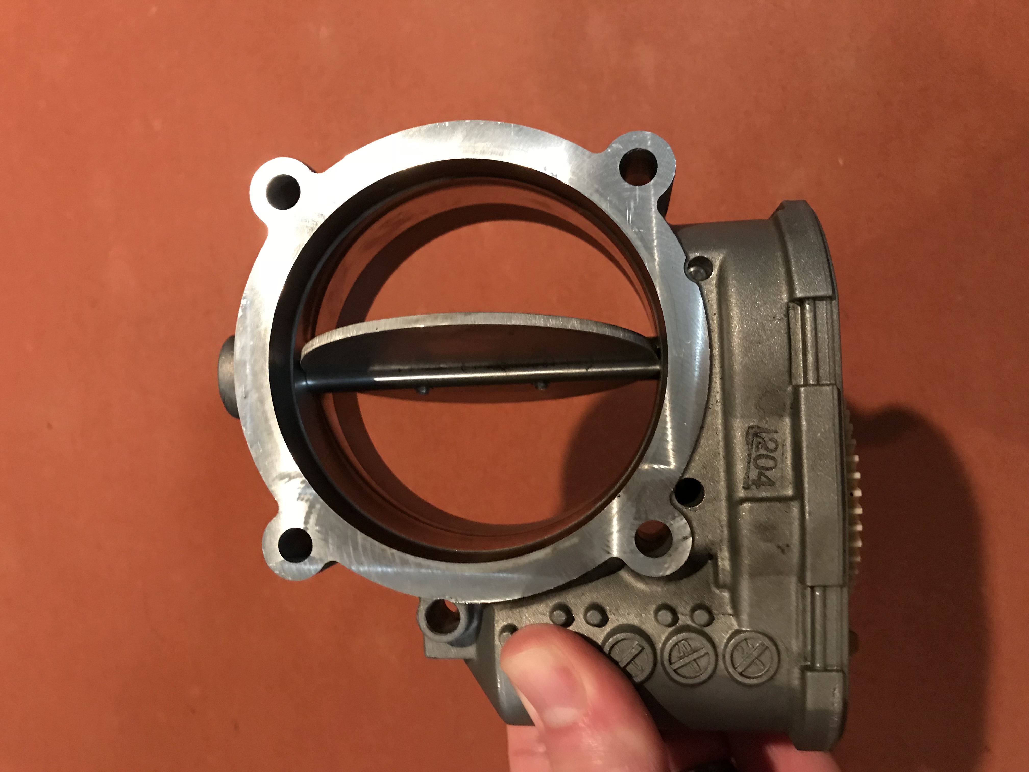

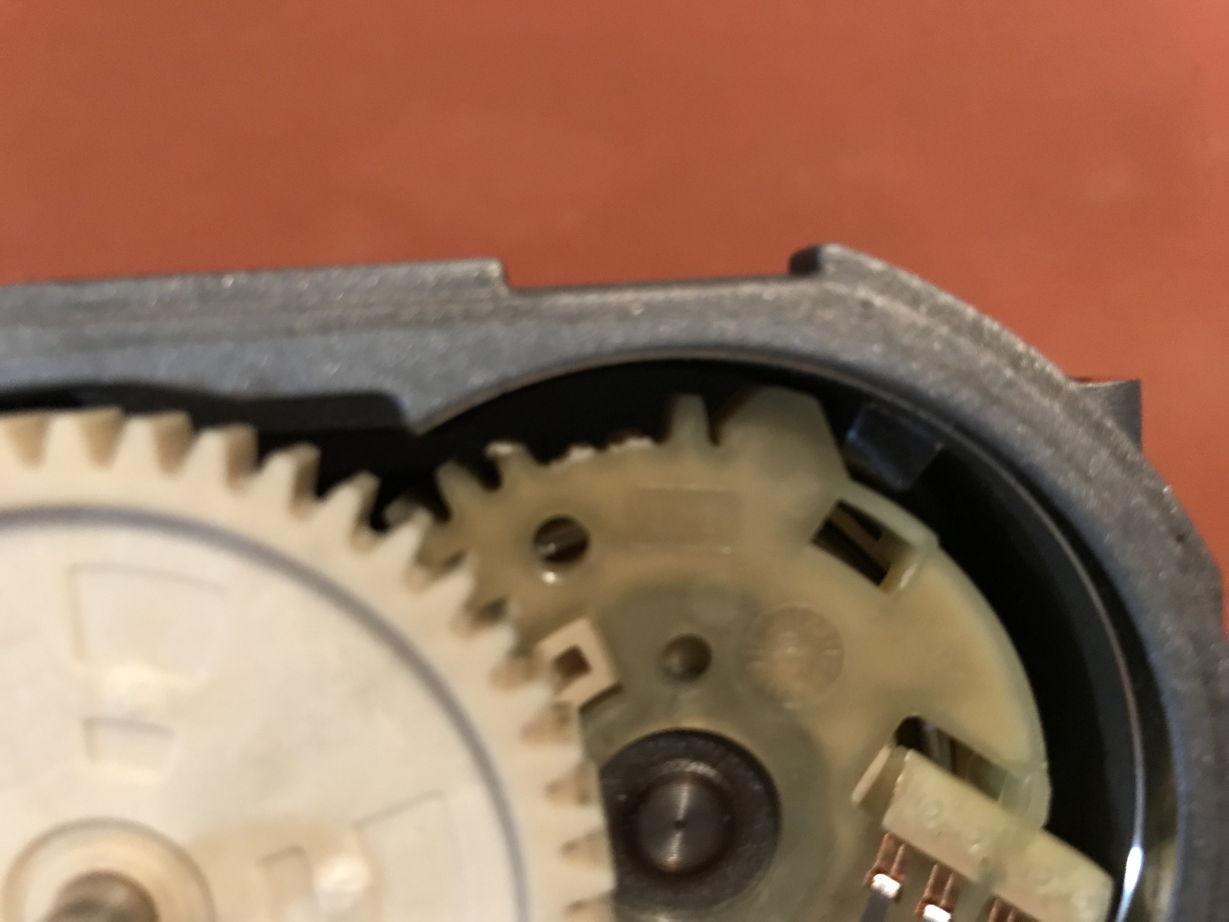

New 2009 tt TB installed by dealer. My p-tech who has been in the business a very long time said he had never seen what happened to my TB. In the photos you will notice some of the teeth on the inner plastic gear chewed off. My TB became stuck in the WOT position. Have no idea why that happened? Because my car had a AWE 750R kit the TB was not the 2007 TB that came on the car but AWE uses a 2009 TB from a TT, GT2 which has a larger bore.
Part number 997-605-116-01
