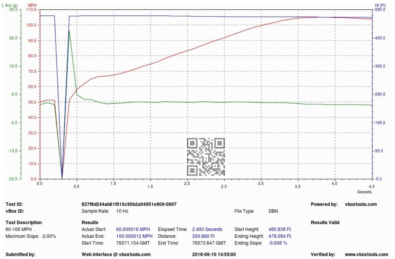

lol, I'm not sure exactly what's wrong or why it says "valid" but somehow I don't think it's valid.

This one looks good and it's slight uphill, so 2.8s isn't out of reach...

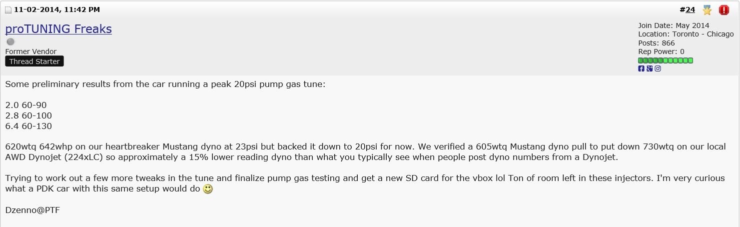

my results aren't too far off what PTF did on the older alpha 3076 with the same pumpgas.
