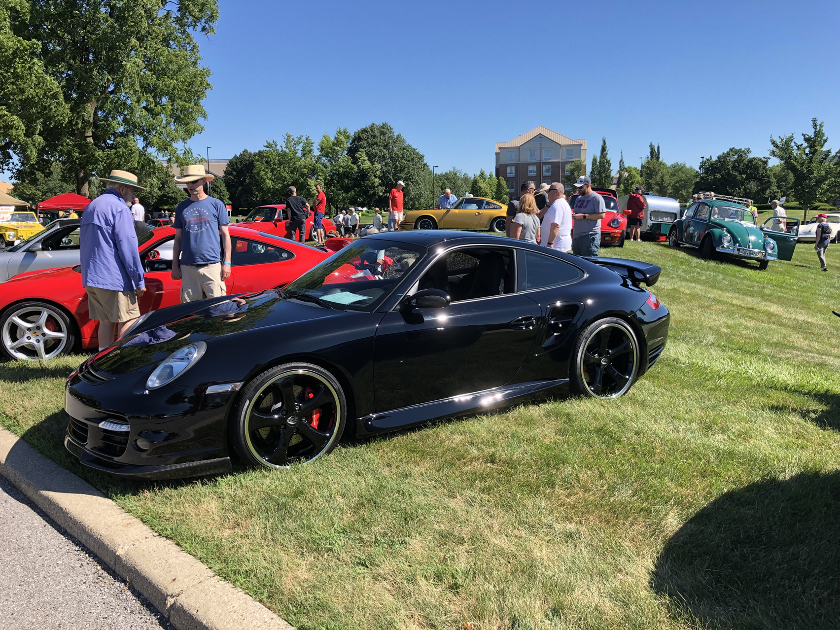

Dguth is a glorious beacon of lightDguth is a glorious beacon of lightDguth is a glorious beacon of lightDguth is a glorious beacon of lightDguth is a glorious beacon of lightDguth is a glorious beacon of light
Here's a picture of how the Techart wing looks. This is my car and I'm considering going with a different wing for more downforce with track use. I'm thinking of the GT2 option or others but NR auto has plenty of choices.

Nice car! I like that decklid. It's subtle like the factory aero kit package. I haven't seen a GT2 decklid on a car with TechArt side skirts. I know ctony66 had this decklid on his black turbo, maybe he can post some pics up. I can confirm that because the decklid was black when I bought it off of him
