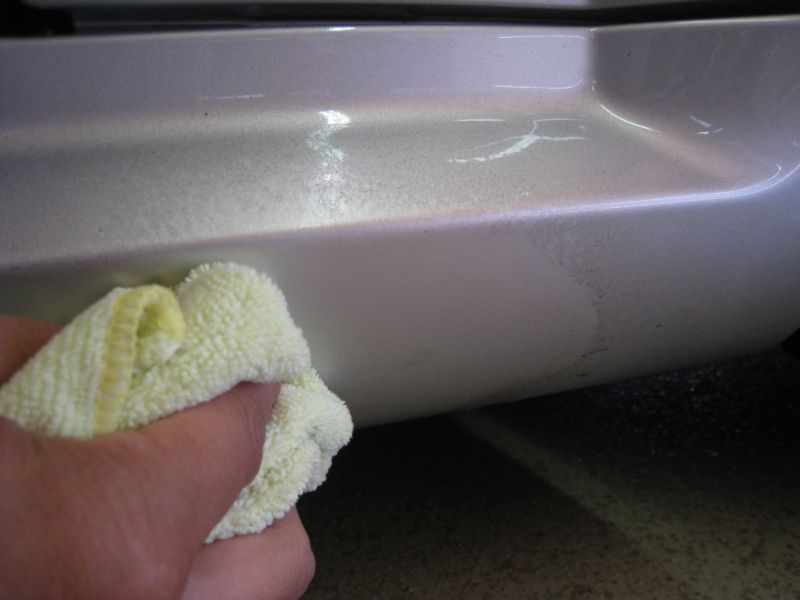

We have recently launched our newest product line for paint protection film PF1 TTR. This product is specifically designed to help those car enthusiasts take out black rubber marks or any type of similar transfer. Below are some pictures of the product being used on a track heavy car and the customer hit some tires on the track.
Here are the pictures:

Completed pics. Customer initially thought the film was toast...he's very happy he didn't have to replace or live with those marks.
