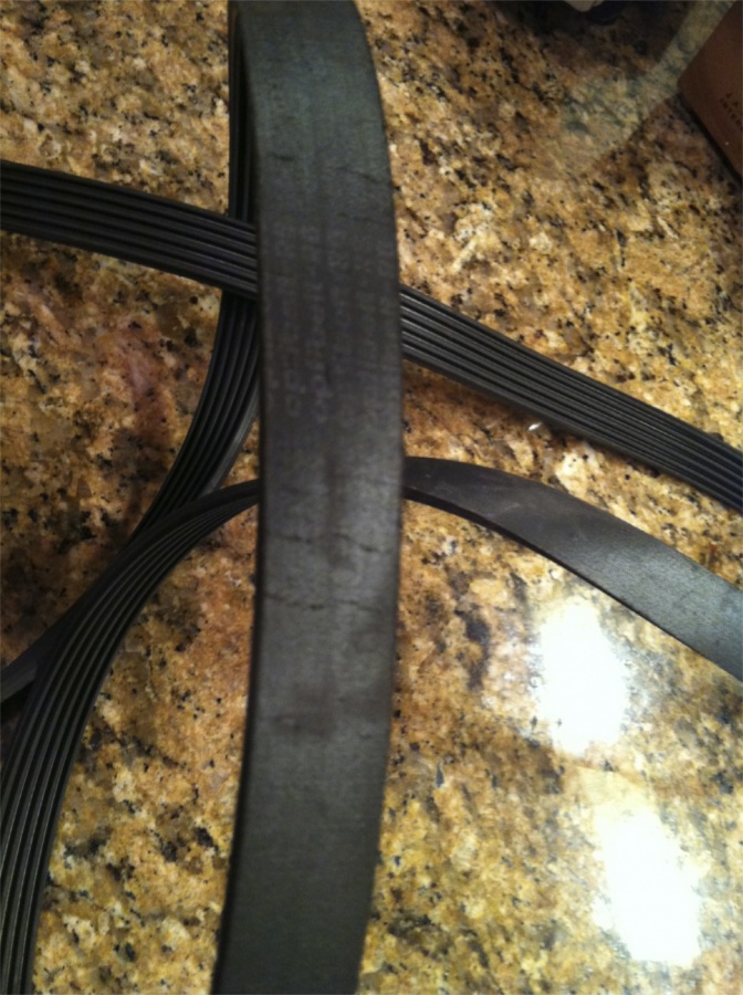

Posted this over on Rennlist as additional information to a thread about spark plugs. In case any of you are not on the other board and are interested, here's a picture of my plugs, coils and belt after 4yrs/39K miles. Did coolant tank, cap and coolant flush, air and pollen filters, brake fluid flush, cleaned out radiators and throttle body at the same time. Had no problems with the car at all but tend to be pretty **** about maintenance. Looks like it was time for the change!

Pretty extensive maintenance list. We all face this point in ownership eventually. I'm wondering if you noticed any improvement in seat-of-the-pants performance (hopefully you did)? Did your technician say the wear/tear looked normal for the mileage/age or was something found out of wack? Care to reveal what the service cost you in parts/labor?
Hard to say exactly what just the above items cost as I don't have the bill with me, but I also had oil & filter change, mount and balance 4 snow tires, unmount and dispose of the worn out summer tires, 4-wheel alignment and a few other minor things. The tech thought the wear was fairly normal for a car driven year-round in the Northeast. Total bill was ~$3K at a local indy. A big nut but, like you say, we all get to this point eventually. Part of the goal was to establish a good maintenance/service baseline on this new (to me) 997.
I'd like to say there was a small performance improvement afterward but probably on par with how well the car drives after a good detail session

Good move on both!! ......... Plugs, once they start to get a coating on the internal ceramics just do not run well at all (in fact some of those look nasty). And the belt is just something that for the cost, why not! (not only you've got where people look at the external "flat" side for cracks and such, but, the depth of the gooves also wear down and its not realized. (They have a little tooth-pick lookin gauge for that too)
Actually on the plugs.... the left row, middle plug seems to be the only one that looks like its running decent. (although I guess if pulled when just warming up you could get some darker, but honestly those were really in need of a change like you did)......again, good move!

Was the belt change recommended by your shop or just something you wanted to get done? I have an '05 997S with 38k miles. Since the car is 6 years old now, I asked the dealership if I should change the drive belt (per manual). They said they'll inspect it when I come in but it may not need changing yet based on my mileage.
Your belt still looks pretty good, but I'm by no means an expert on this topic - great post and pics!
Belt change was just something I did for the peace of mind. Despite a number of visible cracks, it probably would have lasted for awhile longer but why chance it. It's very cheap and an easy DIY from what I've read.

The coils are not called out in the Porsche service intervals but for the 997 often require replacement about every 5 years. That's how long mine lasted, and a 'Total 911' author had the same experience, stating this seems to be the normal lifespan of our ignition coils given they start to crack at about this age.
