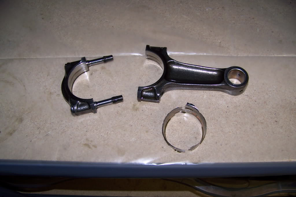

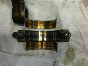

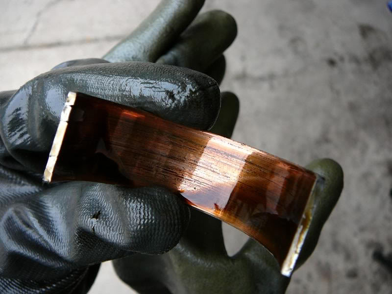

I searched a lot and I found the source it is the crankshaft bearings ( main bearings) And maybe from connecting rod bearings
And here is some pic I found it on the net

Crankshaft bearings:
And here it is new :
And for KSA stand for Kingdom of Saudi Arabia ( Saudi Arabia )
