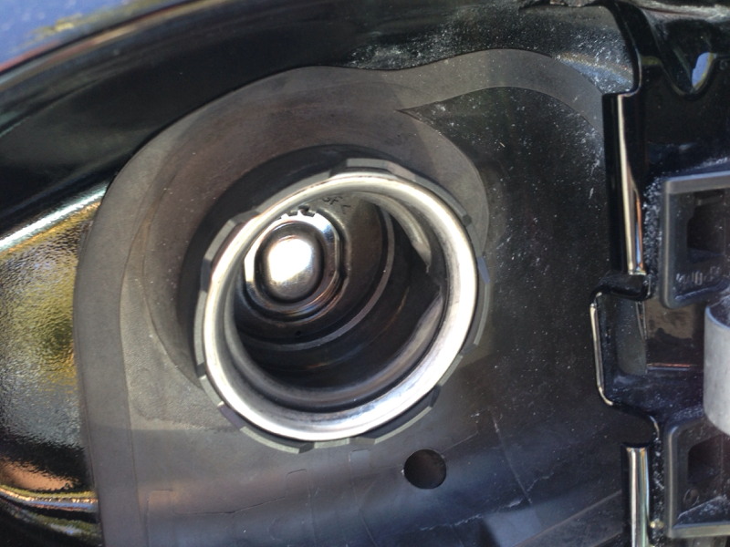

You need this adapter. Call you local Porsche dealer. They should be able to set you up with one. I had the same problem at the pump, after explaining to my local Porsche dealer (Rusnak Pasadena), they asked me to come in and the service advisor fitted one on my car.

I had the same problem and was given the adapter by Barrier Porsche (thanks, guys!) when my car was in for servicing. I think it's a $6-7 item if you have to buy it, and I know Suncoast also sells them.
Despite the adaptor, I would still occasionally have the problem, but only at certain stations. It appears to be a function of the nozzle type used by a given station and the effect on displaced air flow out of the tank (the adaptor is essentially a spacer with extra air gaps). For the problem stations (which I now tend to avoid) 9 o'clock or 12 o'clock works sufficiently well for these.

I also had Barrier install the adapter and agree, it lessens the occurrence of the issue.
The rate of occurrence seems also driven by the flow rate the pumps were set at, as pumps that pump high rate cut off more often I think.
