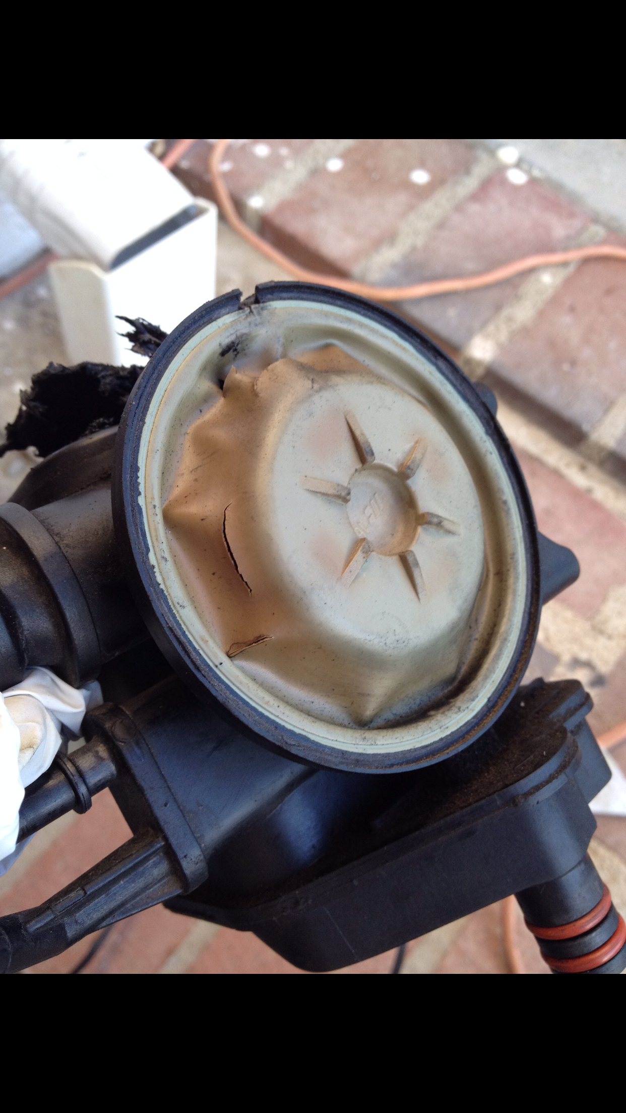

When I replaced mine, I did open it up. I bet that if the tears were at the exact locations, I bet the AOS would make noises. Mine had the tears at 7-, 9- and 12 o'clock so I believe the air volume did not create noises. Just WAG.
