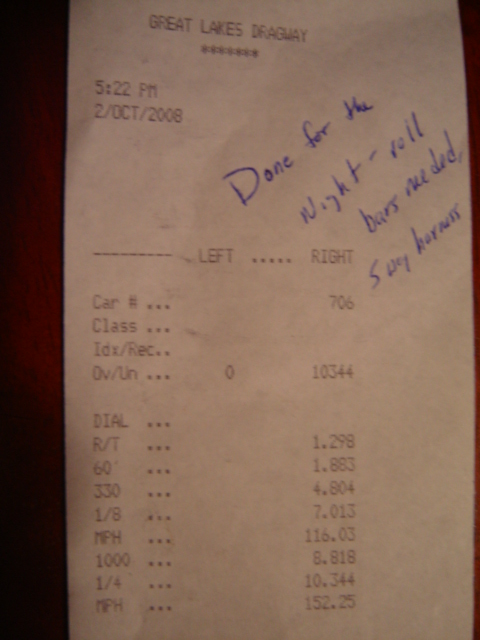

Pics and info below. I drove to the track last thursday and ran 10.3 @152mph with 16psi boost, 11.5deg timing. Was going to start out conservative and work my way up but the track told me to leave and not come back . Well, they said I could come back once I had a certified cage, nhra license, harnesses and a parachute.

Thanks guys, it is alot of fun. With the gear referenced boost control it's actually very tractable on the stock runflat tires. It ran 10.6 @141 on my "street" boost settings and stock tires-
1st gear 6psi
2nd gear 8psi
3rd gear 10psi
4th gear 11psi
The 60ft time on the 10.3 run was 1.883. Much room for improvement but the best I could do on my one and only pass of the day.
(timeslips attached)
