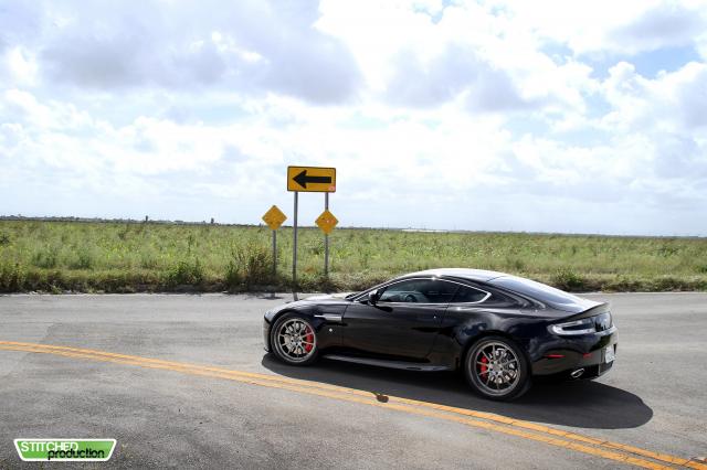

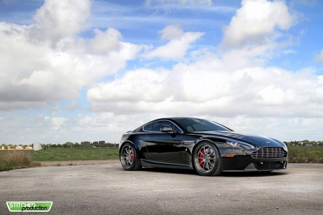

Stuart - first I want to thank you for 100 Cell Cats - They are the perfect sound for me.. I will get a sound clip on here soon ...
Regarding the springs; I installed the H&R's and happy with the drop and ride.. A bit firm and low - but I knew that going in.... paid right around $500 - and felt that was a fair price .... Would have paid more for what you are suggesting ....
Good luck ...
