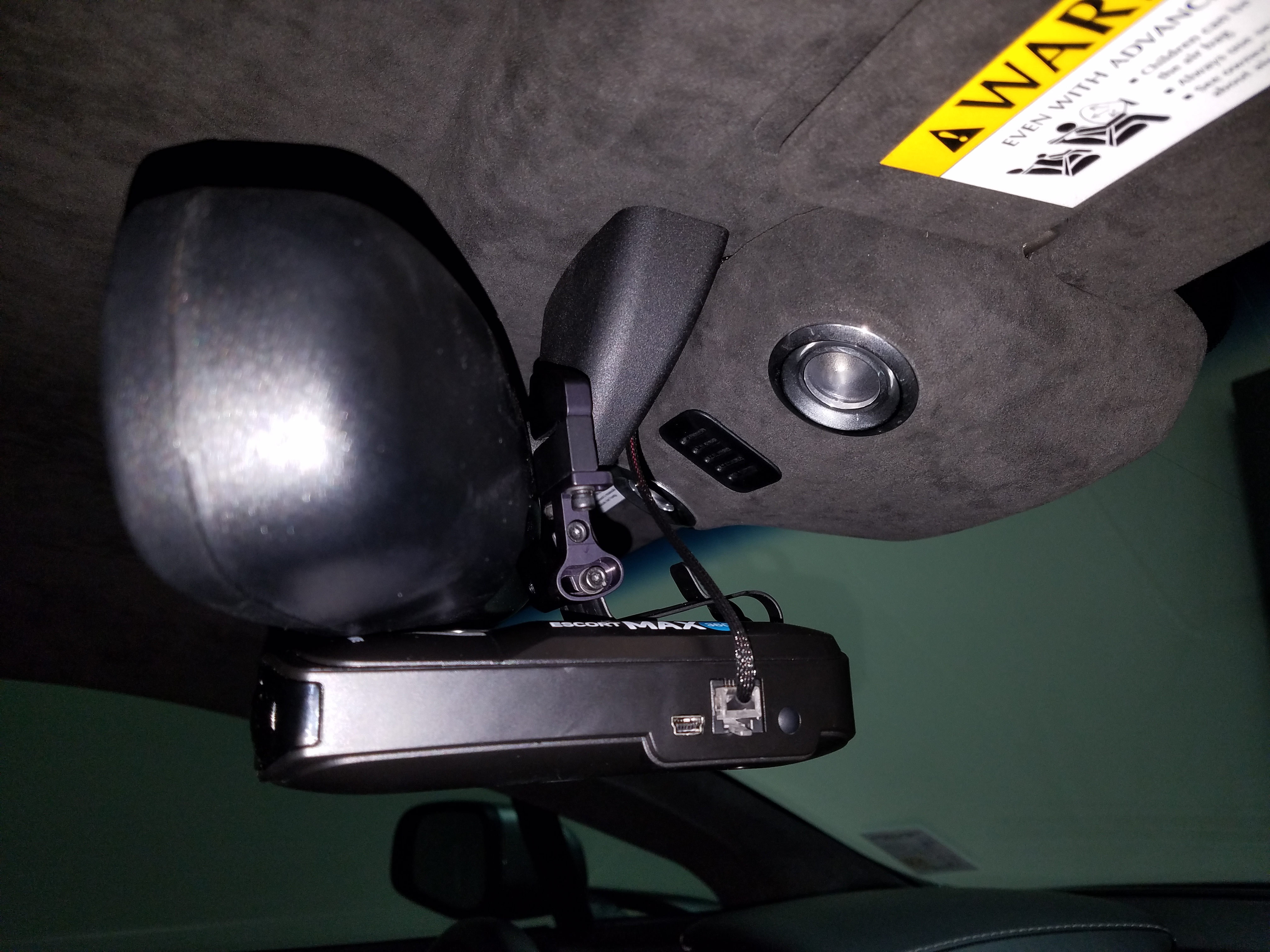

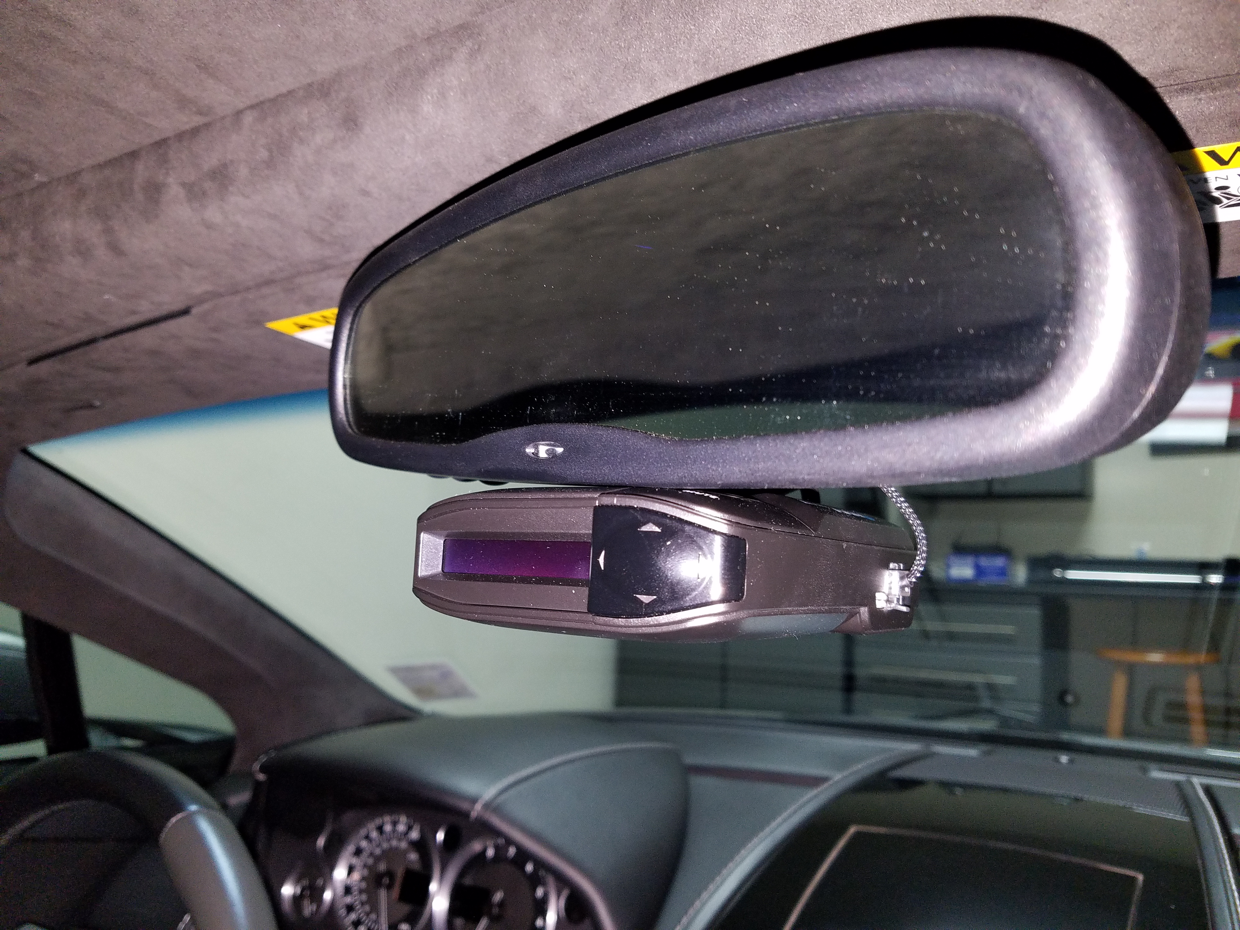

Well my lovely wife got me a Max 360 for Xmas. I've been rolling with a V1 for over 20 years so I'm excited to try a new detector with all these new features. Would have loved to have stuck with Valentine but the V2 is still nothing but a rumor and their upgrade plans have gotten worse over the years. It was damn nice to just plug this 360 into USB and get all the updates right there and be done with it. (I realize Valentine upgrades hardware too, but the whole process is getting out of hand - complex and pricey)

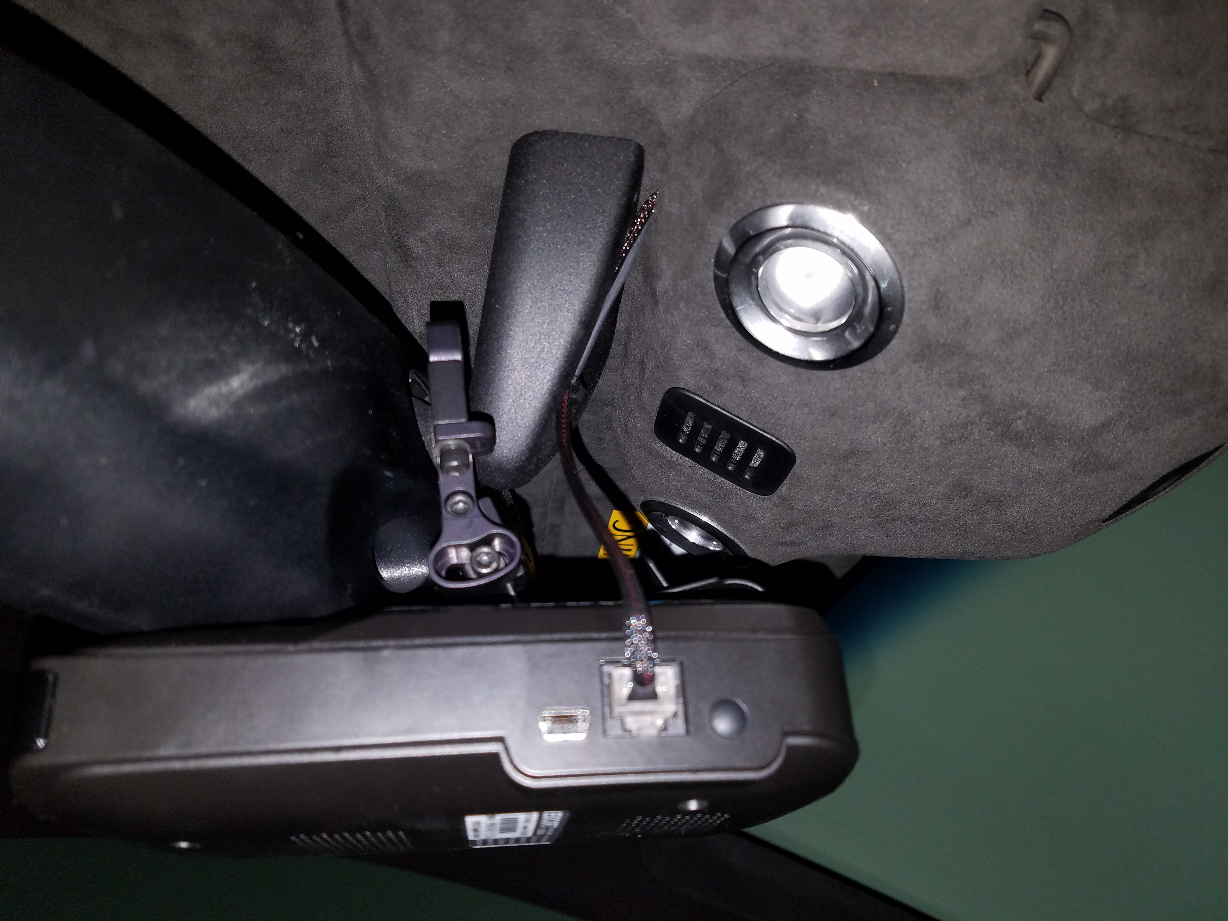

Here's a few install pics. I was too "in the moment" to snap shots while actually doing the wiring but I can step out the process:
The MirrorTap kit is a nice set of wiring connectors sized for any situation and allows you to hardwire power and ground from the mirror's power supply (eg a dimming mirror) to the radar detector. No need to run wires around the cabin to reach a remote fuse box.
The Aston doesn't have a dimming mirror but it does have Homelink (if so equipped). So we'll just use that.
Your objective is to remove the map light pod to access the homelink molex connector which has a convenient switched 12v + and a ground.
You will need:
MirrorTap kit
Flathead screw driver (small, for prying)
Phillips screw driver (medium/regular size)
Lighter/heat gun
Wire cutters (only to trim zip tie)
1. Locate and gently pry off the plastic microphone cover on the rear side of the map light pod. It clips top and bottom. I tried using my interior trim removal tools but the piece is small and very snugly fit into the suede roof. A flat head screw driver worked best. Just go slow and be gentle with the material. It pops out pretty easily.
2. Once the plastic piece is removed you can gently pull on the mic cord and get some slack to get it out of the way. Now you can see the small black phillips-head screw that secures the dome light pod. Remove it, set it aside.
3. The dome light pod will be loose but you will need to slide it forward toward the windowshield about a 1/4 inch before it unhooks completely. The dome light pod will now just hang from the wiring, which is no big deal. It's all pretty light weight stuff.
4. The homelink molex connector is easy to spot. If not just follow the wire from the mirror to the connector. Unlike other connectors in here this one is clipped to the roof. Don't disconnect or do anything to it. Locate the black (ground) and white (12v switched) leads going into the connector. These are the ones you will tap from using the MirrorTap extensions.
5. Choose the largest MirrorTap extensions. Then, using red for 12v and black for ground, just shove the MirrorTap leads into the molex connector. They basically just sit inside the molex connector holes and push up against the existing lead connector. It's all friction-fit and very sturdy. Red shoves into the white molex wire and black shoves into the black molex wire. The extension should slide all the way into the molex connector with a little effort. It will be a tight fit, as it should be.
6. Now take the MirrorTap detector cable and slide on the included heat shrink tube. Then connect the cable to the extensions you just installed in the Molex connector. Then use a lighter or heat gun to carefully shrink the heat shrink tube around the point where the cable connects to the extensions so they can't come loose. Take care not to overheat the wires or the surrounding interior components (especially the suede).
7. Route the MirrorTap cable to exit the rear of the dome light pod (right behind the mirror) and just follow the Homelink wire. Use the included mini zip ties to neaten things up by tying the MirrorTap cable to the Homelink cable. Use wire cutters to remove the leftover zip tie.
8. Now just reinstall the dome light pod and tuck the remaining MirrorTap wire slack inside this pod.

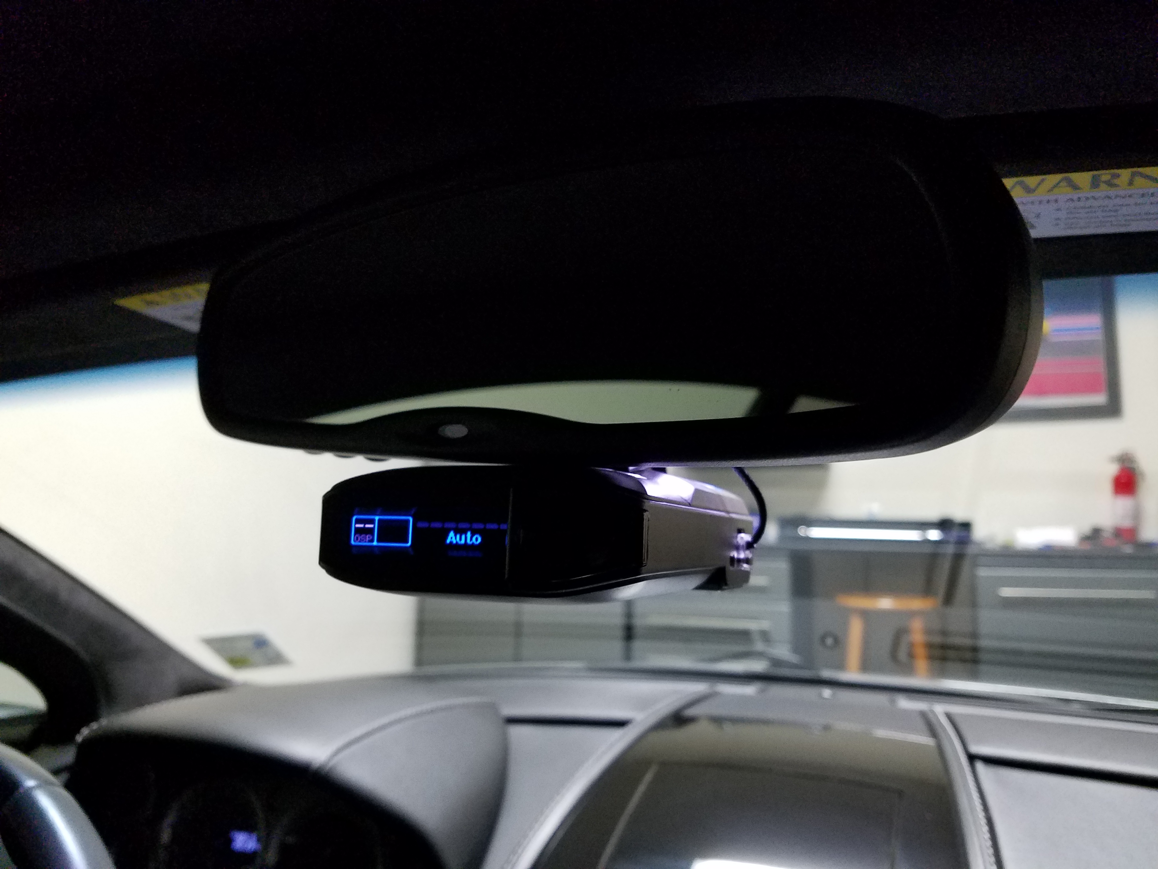

And that's it! Now your detector will power up when you open the doors and on acc power, and power down when the sentinel delay kills power (or when you lock the doors) after exiting the vehicle.
Whole install took me 30 minutes and I didn't have instructions, just feeling my way through it.
And props again to Blendmount. I have had one in my last 4 vehicles and they are always worth every penny. This one is great. I still need to do some bumpy-road testing and final adjustments, but it looks really good right now. Very clean install, if I say so myself!
