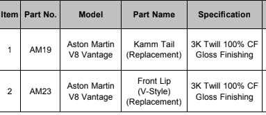

Here is a copy of line items on the order list

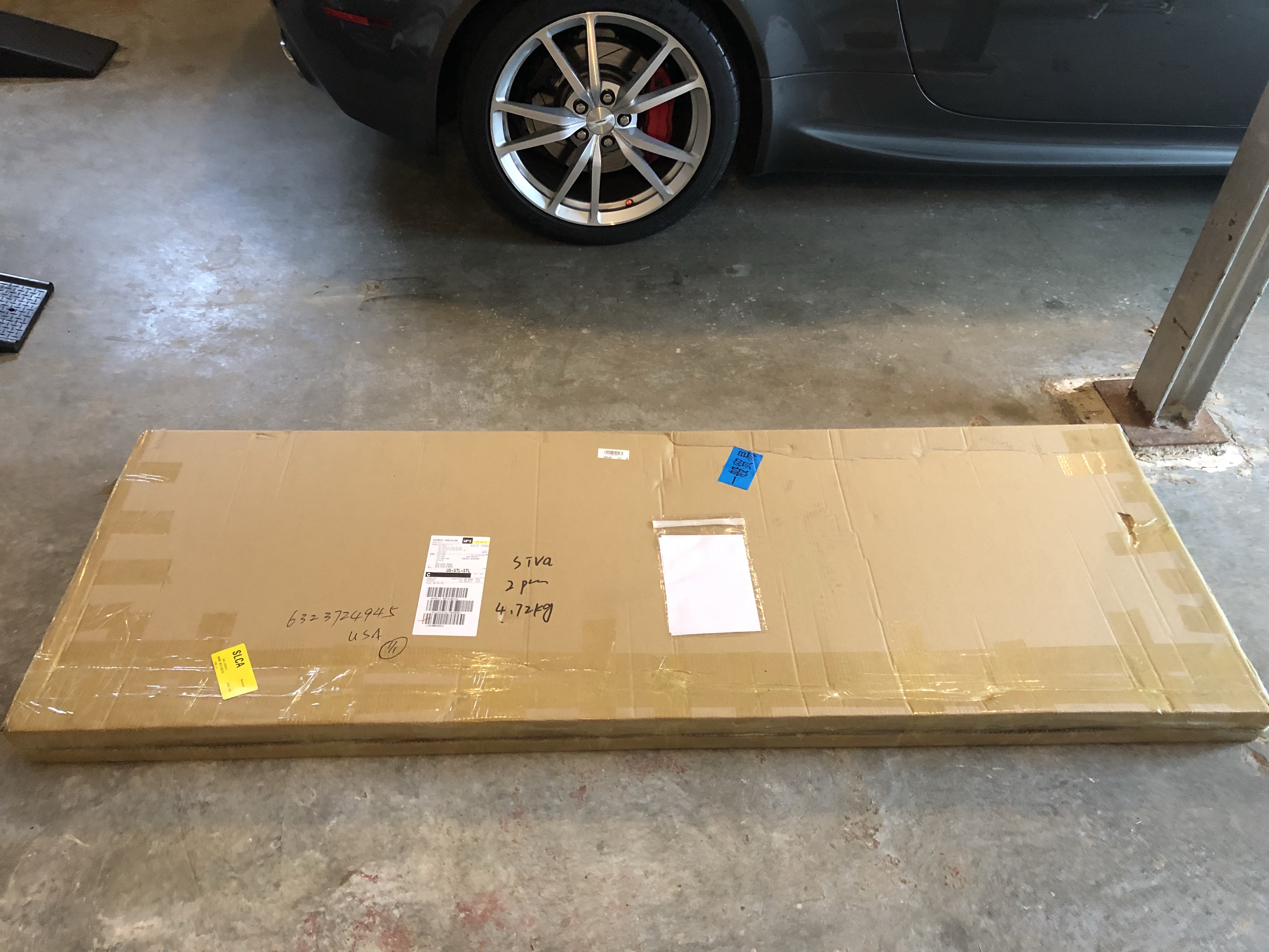

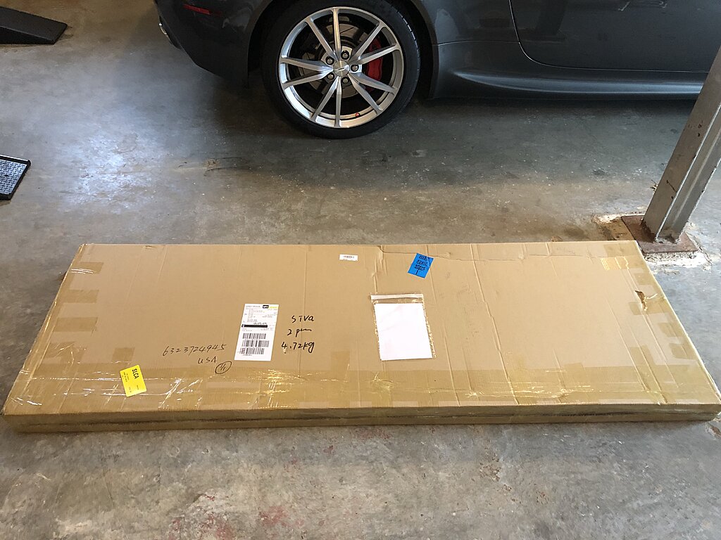

After the order was placed, it took them exactly 1 month to have the 2 pieces made. When it was complete, Tina informed me of the DHL delivery, it took them 12 days to deliver to my doorstep here in St. Louis
The box did not seem damaged at all

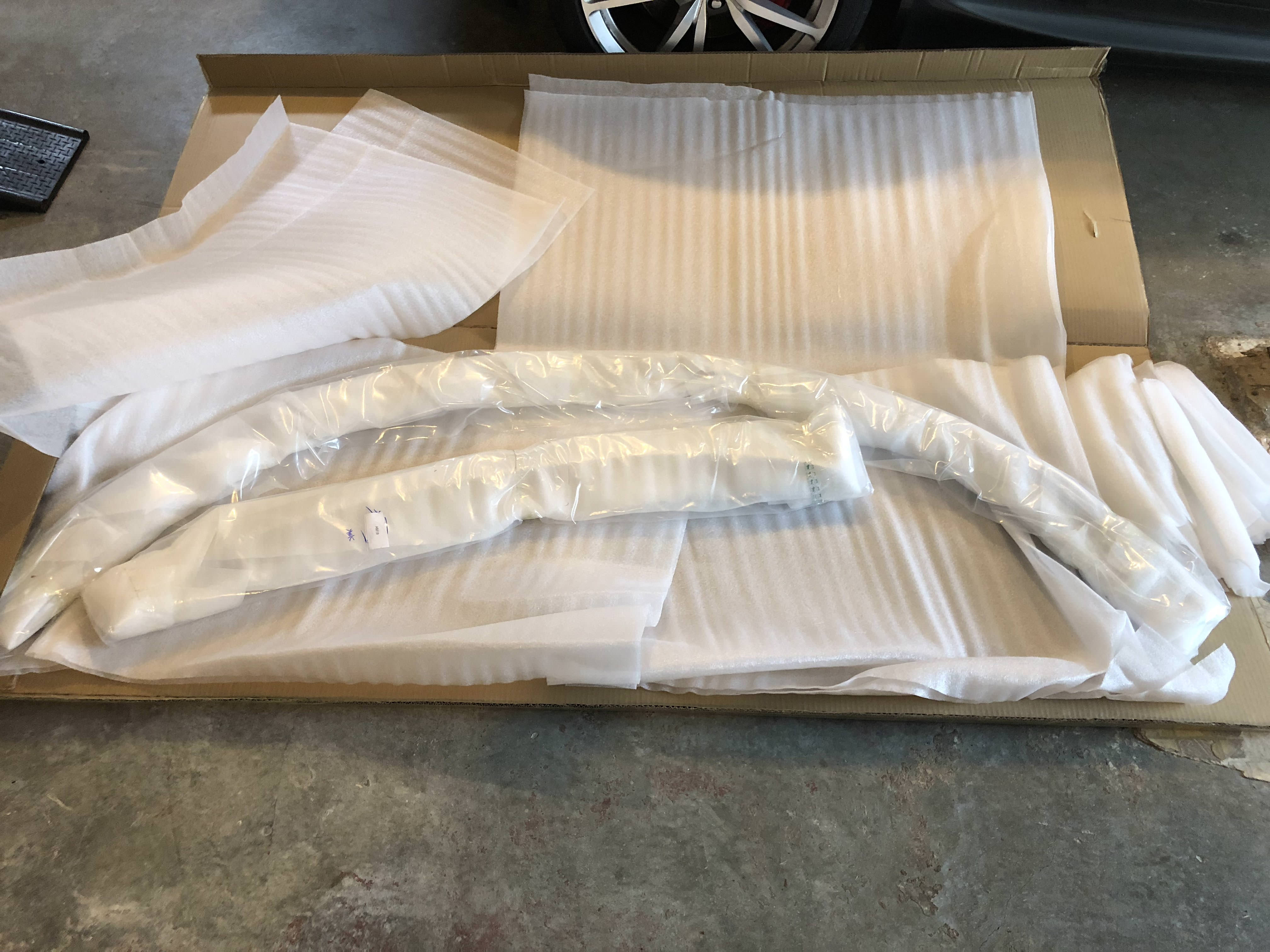

Very happy with how everything was wrapped

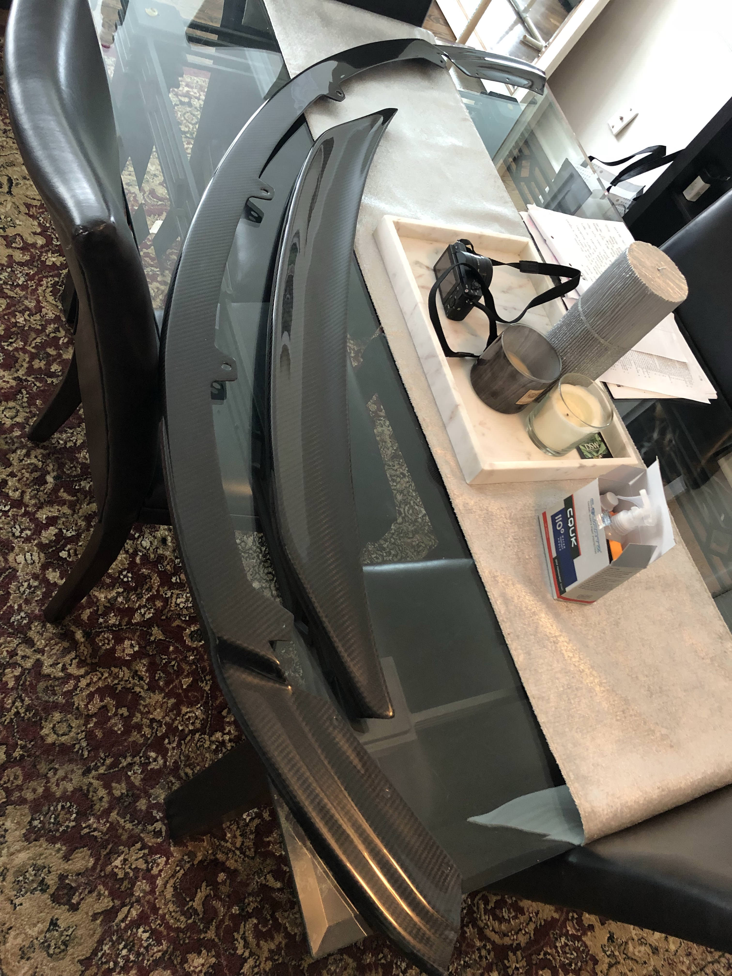

Unpacking

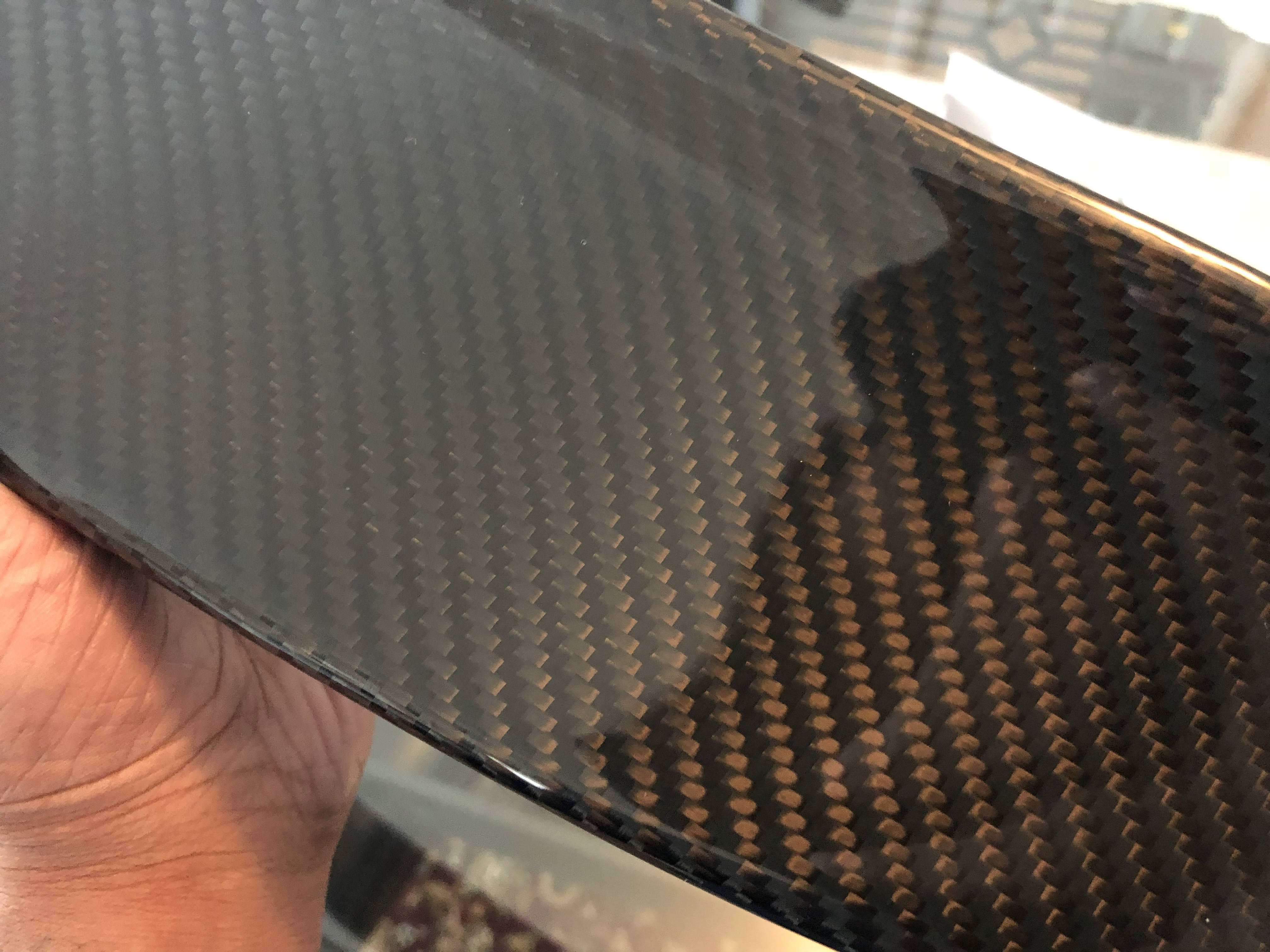

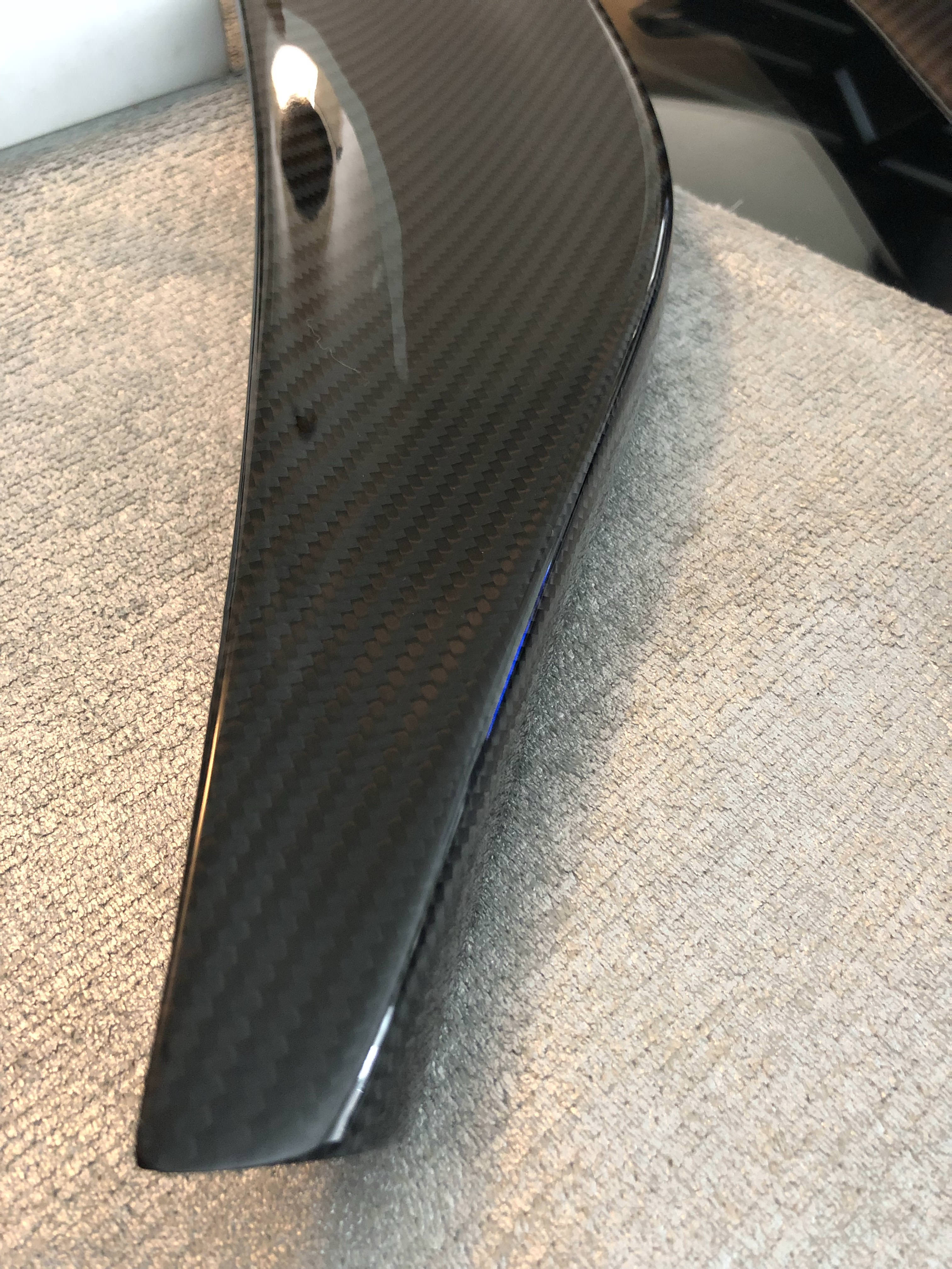

Closeups of the weave

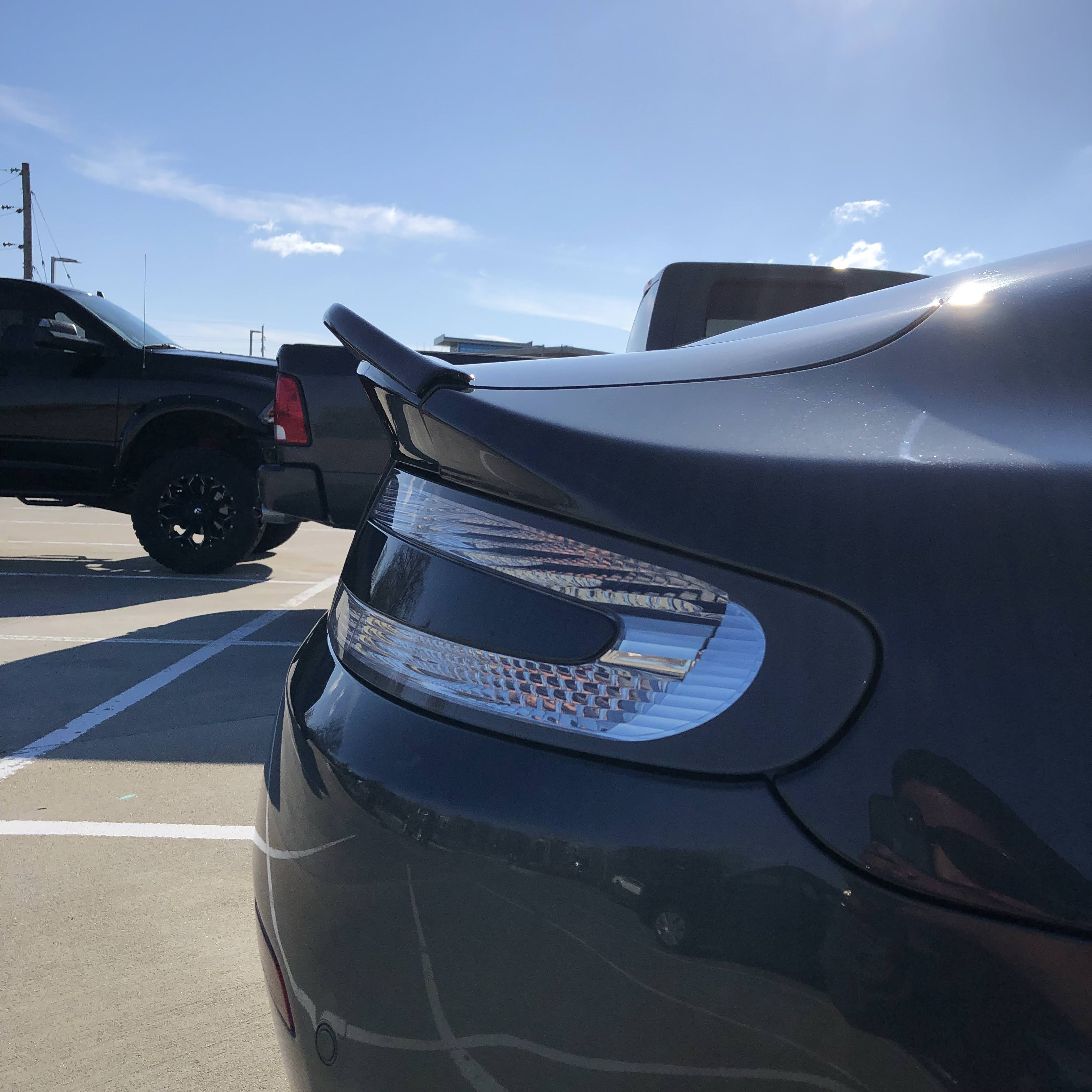

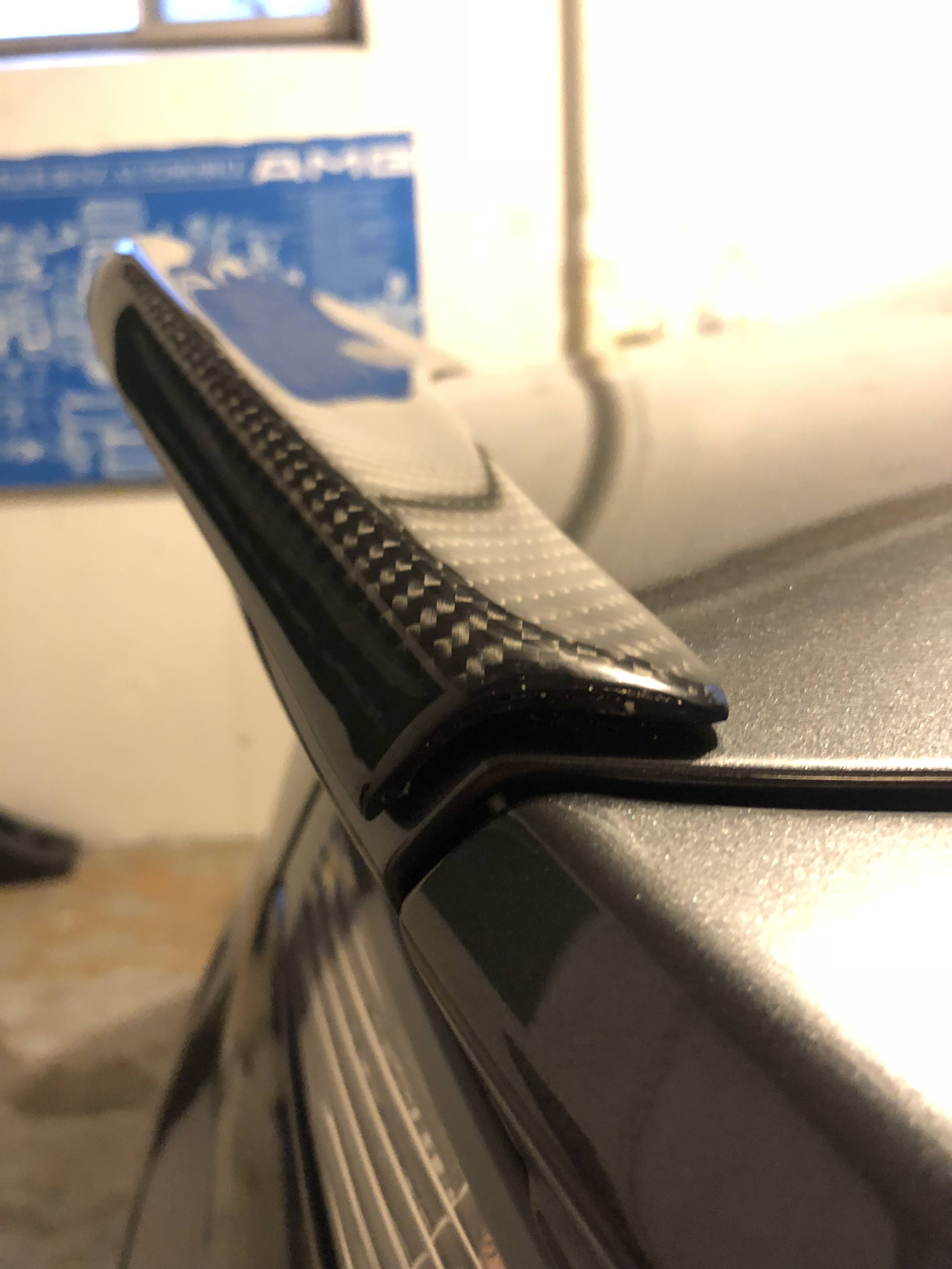

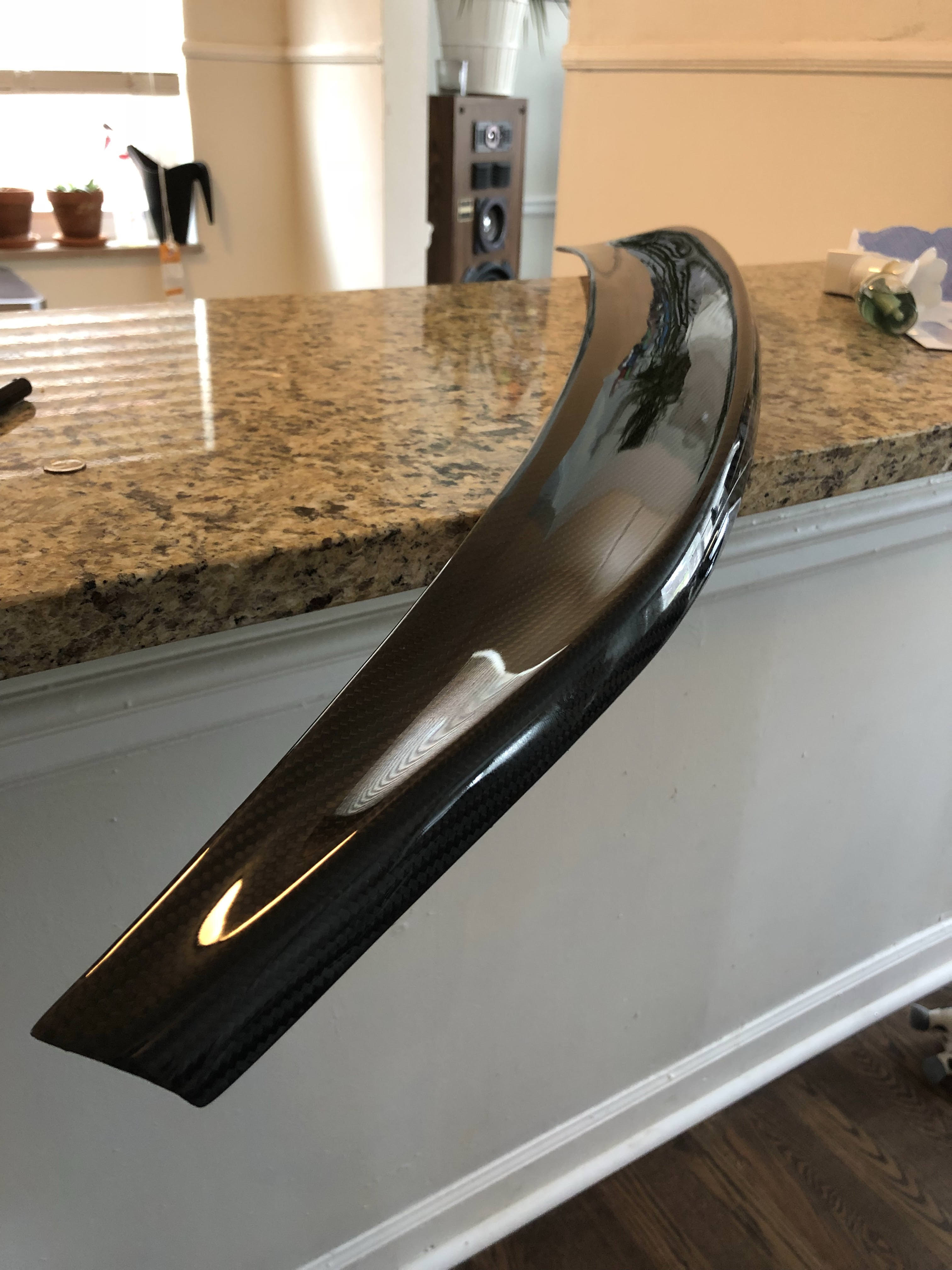

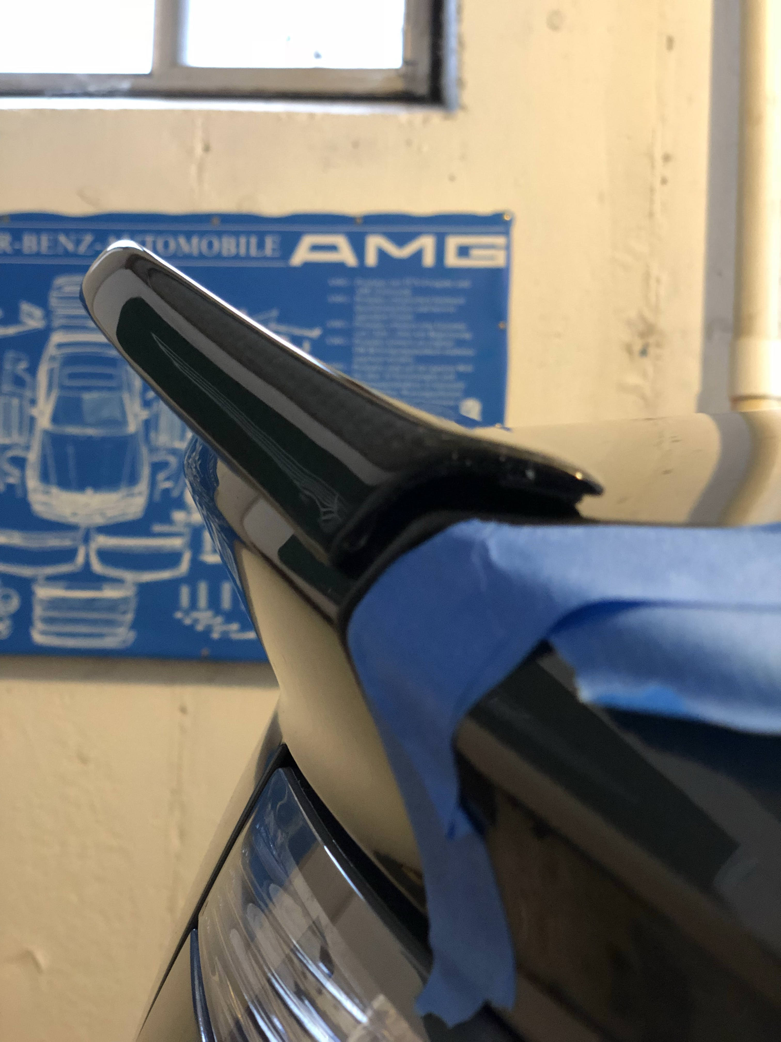

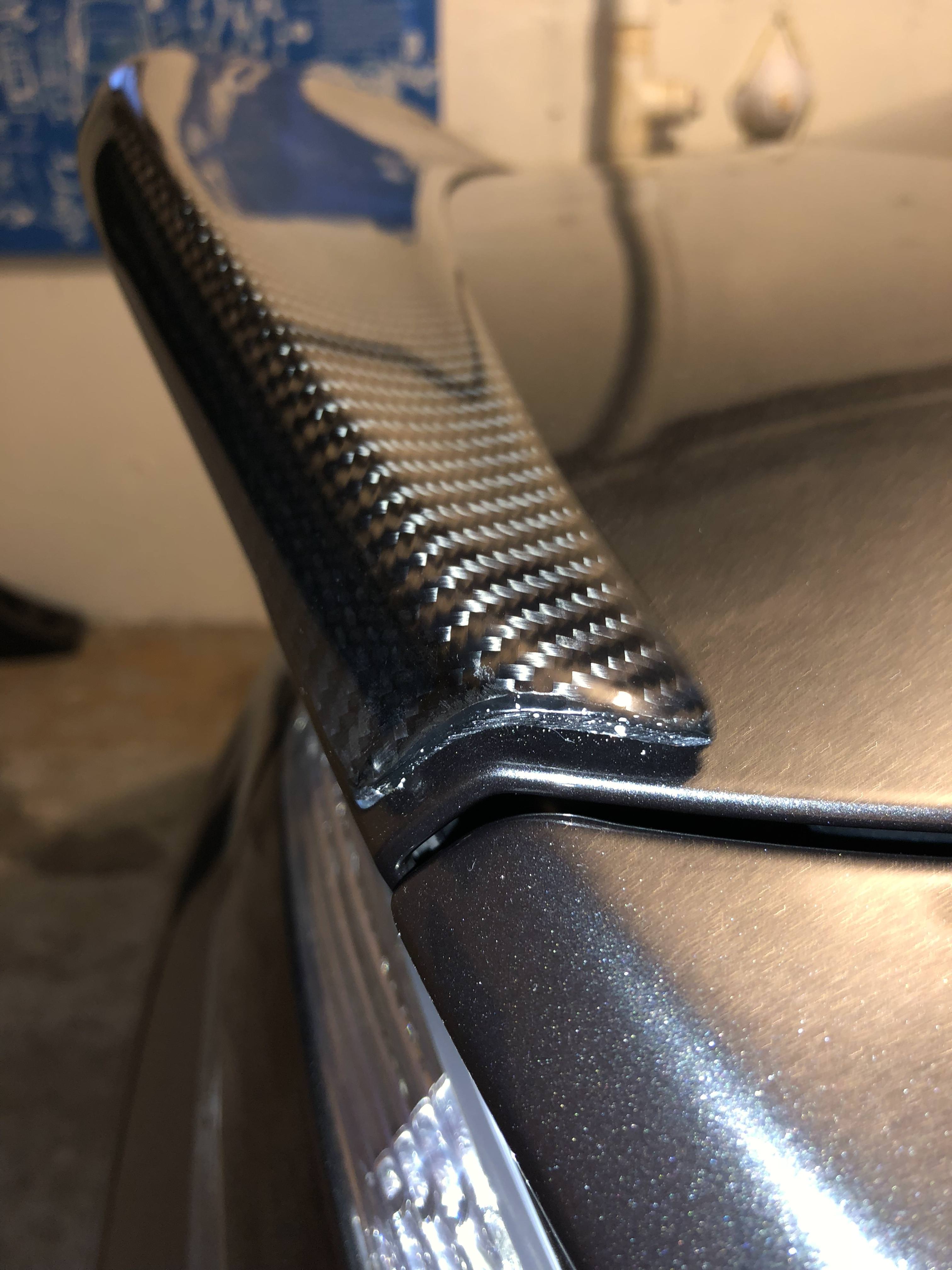

Kamm Tail
I used 91% alcohol to prep the trunk and 3M Auto Adhesive to bond the tail to the trunk
Overall, the fitment is a 8/10. The problem is since the ends are curved to match the line of the trunk, you need a very strong adhesive to make sure the ends stay done. It will not move for now, but I know over time the 3M might play a little problem. There is absolutely no give, but I can imagine the adhesive is at it's max capacity in terms of holding strength on the ends. Also with the thickness of the tape, there is a raised look on the sides of the tail. Not exactly flush as if you were to panel bond or liquid bond, but maybe a mm or 2 of added height. If the tail was curved slightly more, I'm confident the fitment would be a 10/10. I will need to revisit down the road on correcting the adhesion, for now I'm fine with it

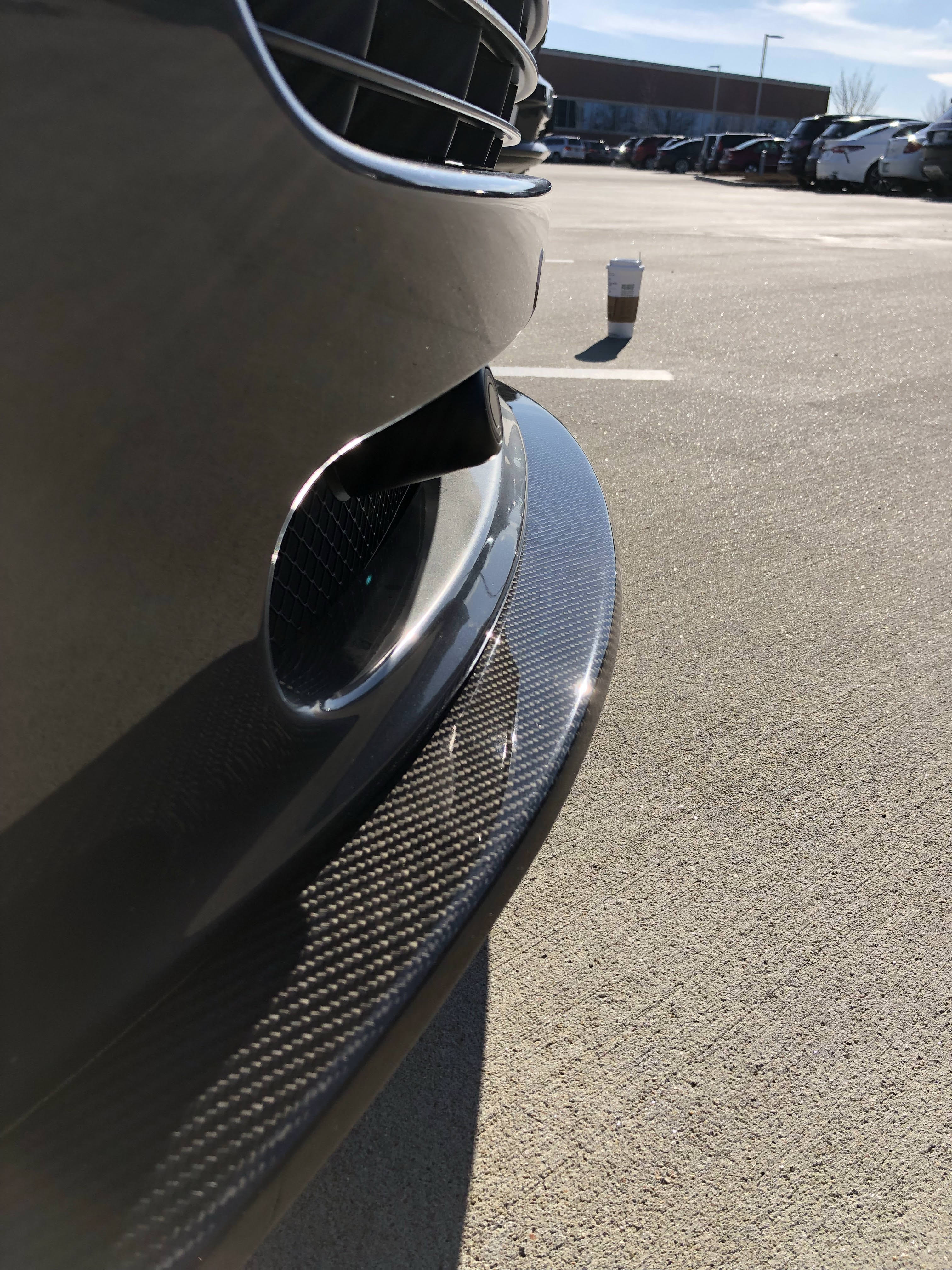

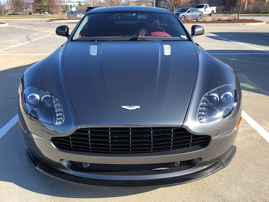

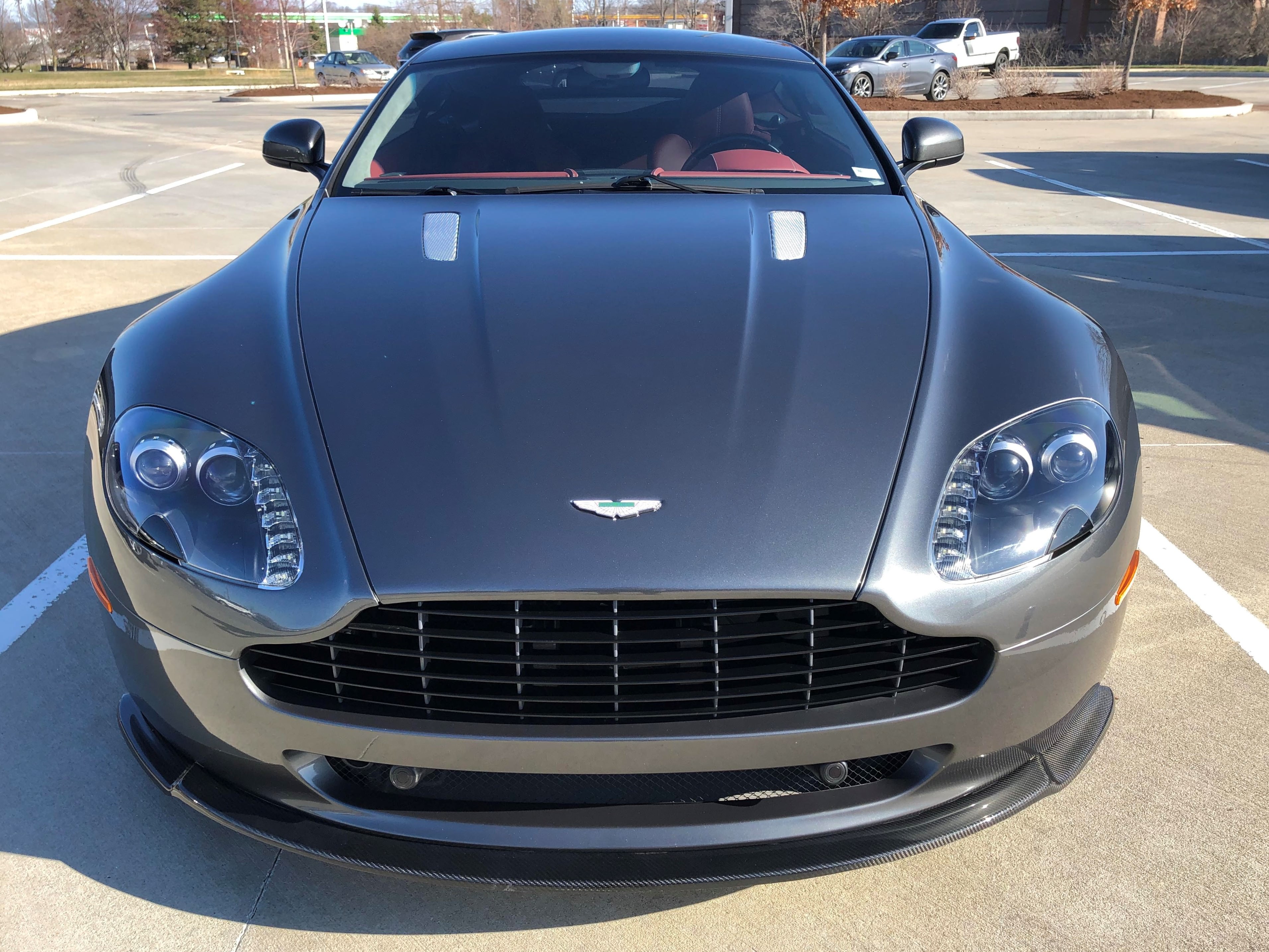

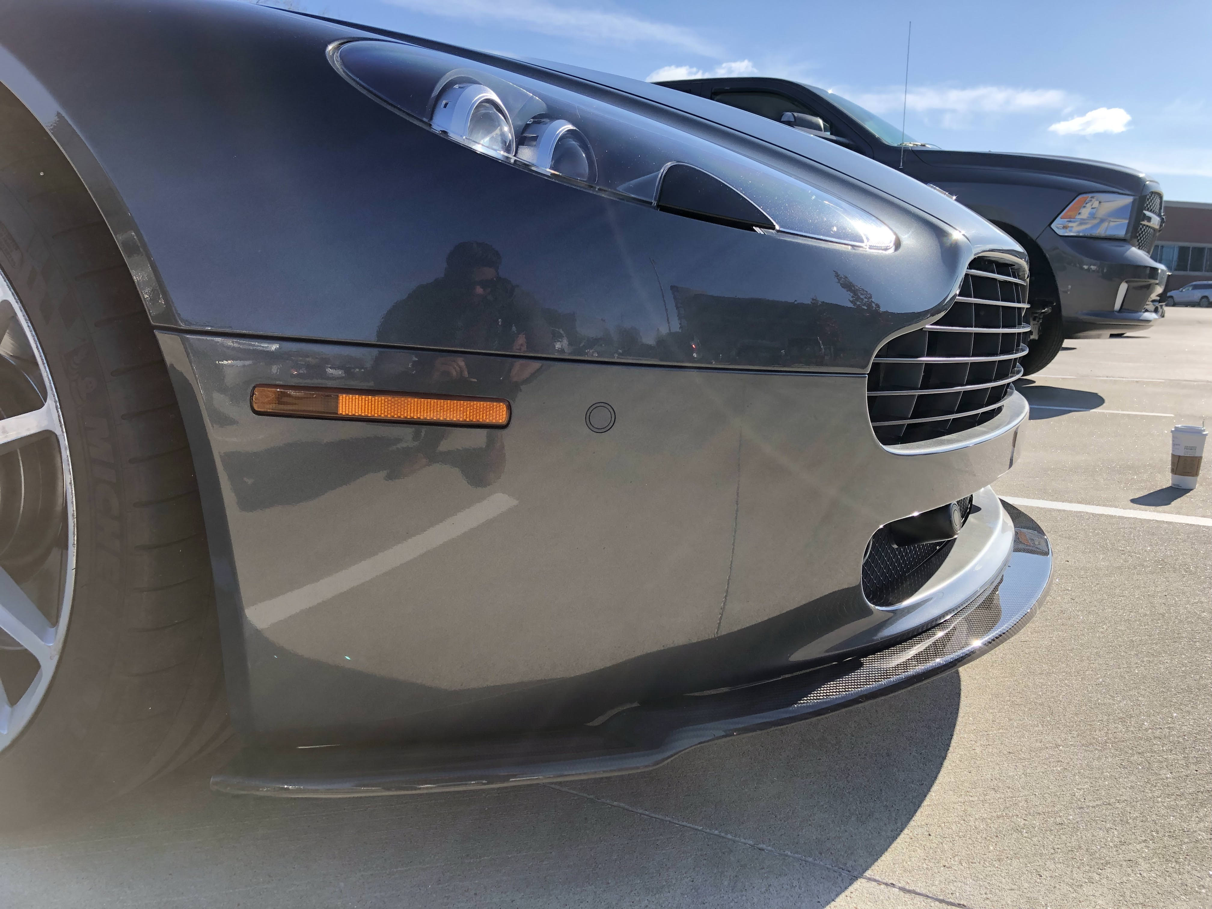

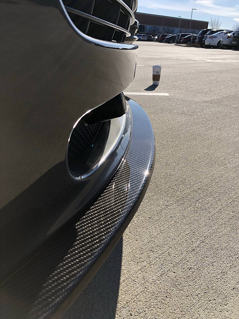

Front Lip (V Style)
Fitment here again is a 9/10 - when taking the existing plastic skid lip(?), there are some gaps that are uncovered. I'd expect to for fitment to be a 10/10, but simply bolting up the lip in the existing front bumper screws creates some gaps. I will have to remove this and probably lay down some 3M on the front as well, to close those gaps
Side note, I am very impressed with the mirror finish on my car! Those 18 hours I spent on it 2 weeks ago really payed off

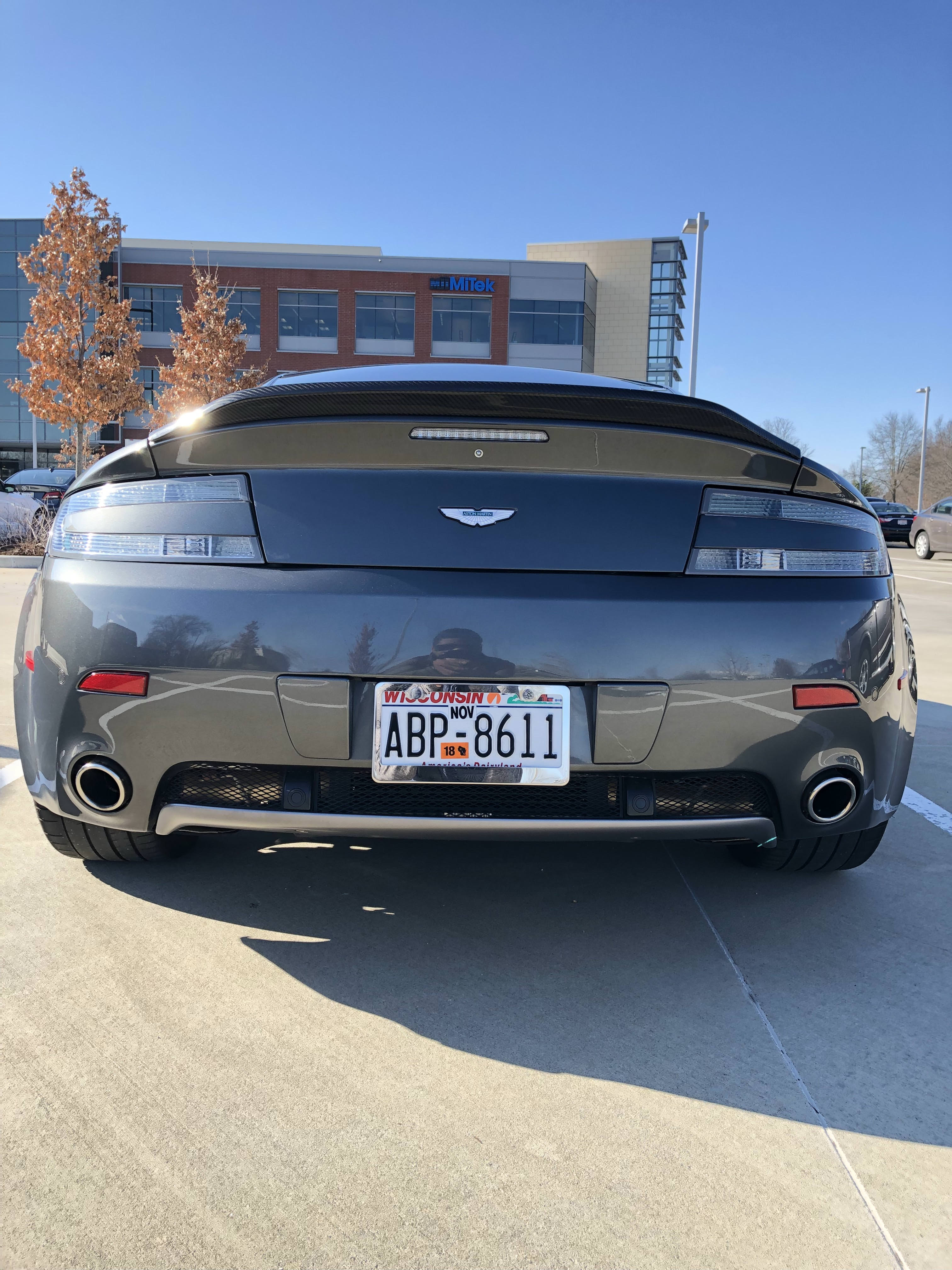

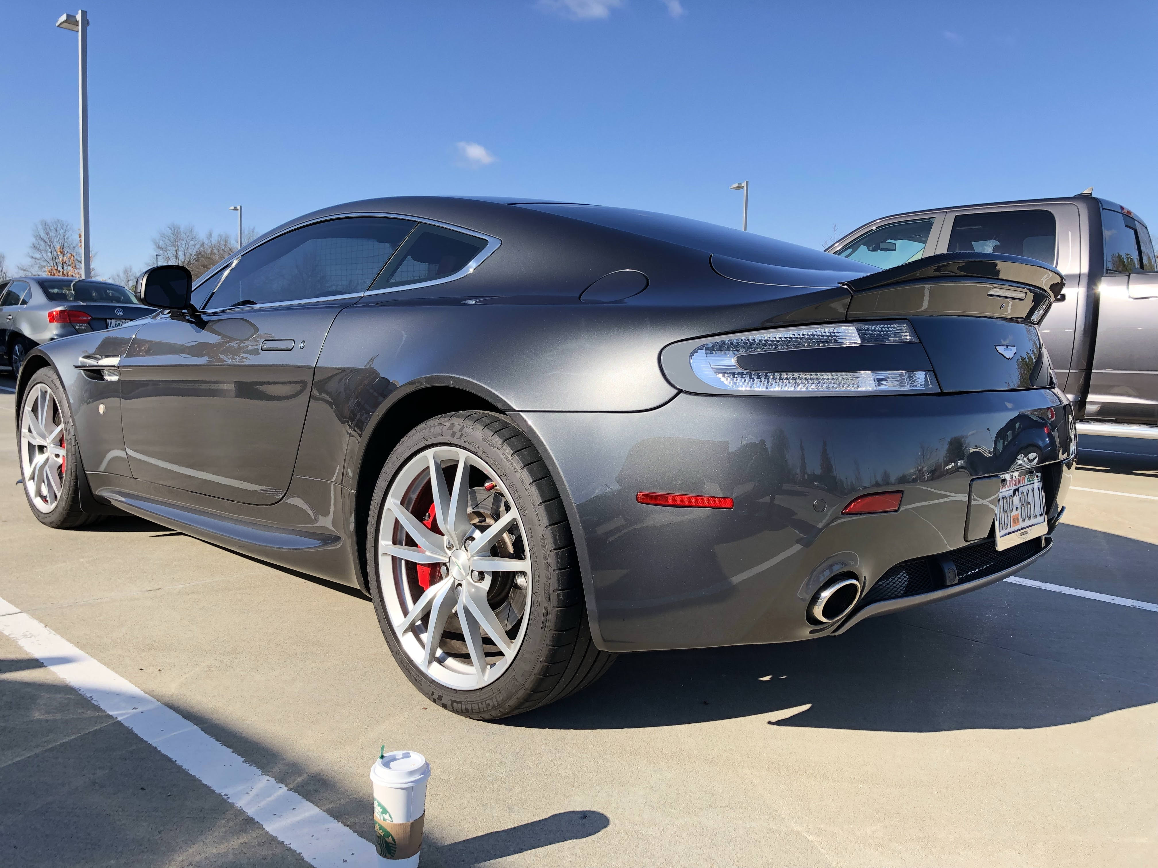

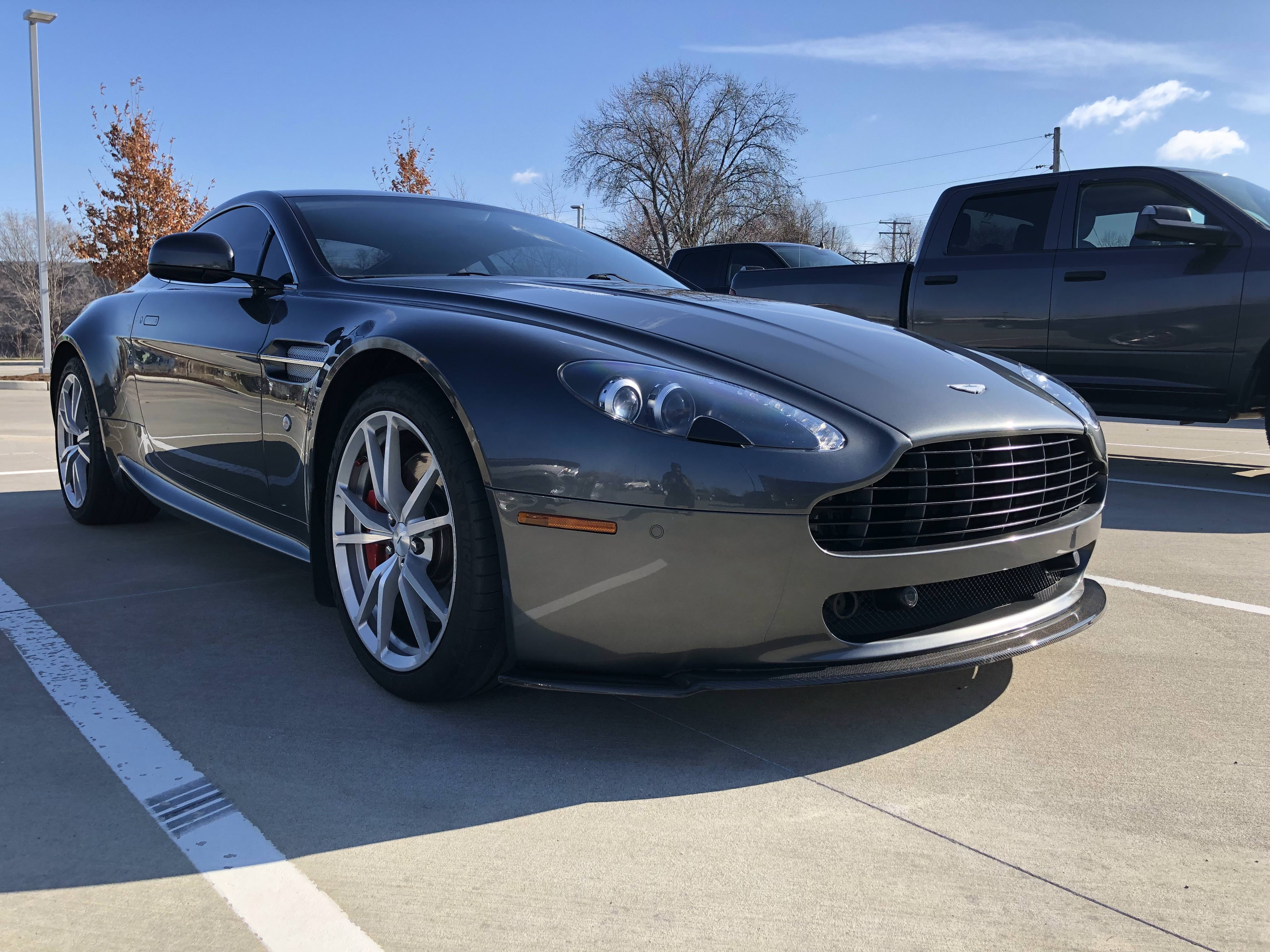

Mounted Car Pics

Overall I am VERY happy with my order and the price justified it, after shipping it was a fraction of the cost from V Collection and others

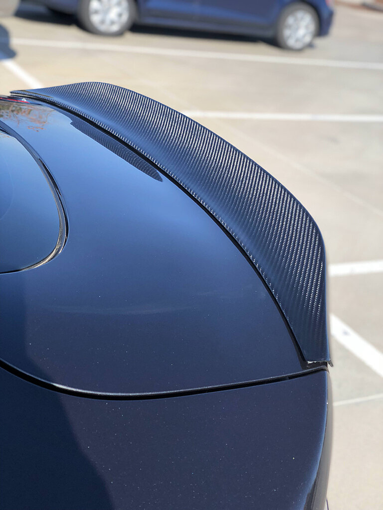

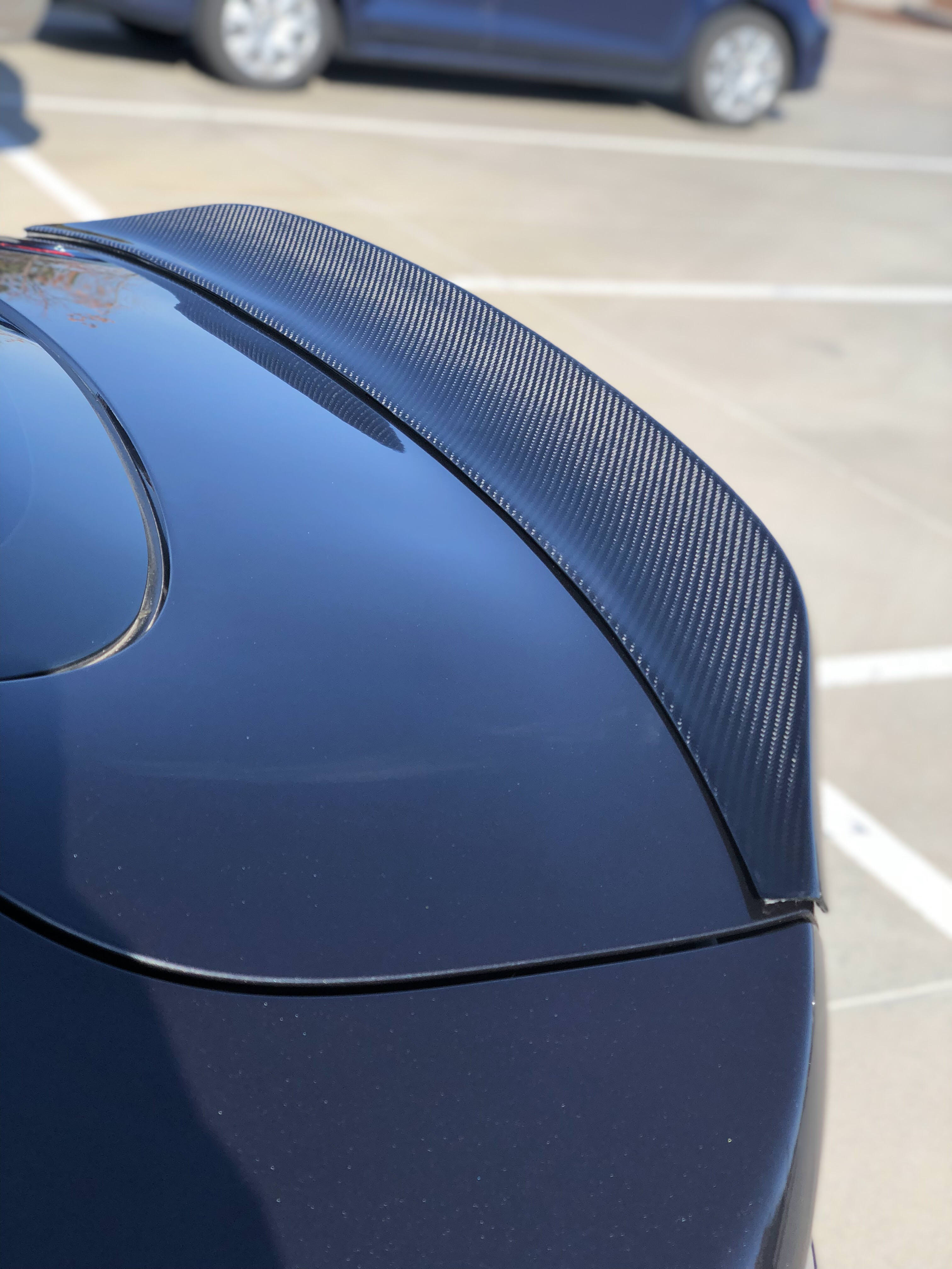

Held down the edges of the kamm tail with some clamps covered by a microfiber towel for 48hrs
Really closed down the gaps, it's a perfect fit now!

I am happy you like it, these extra pieces really make the car look complete and stand out.
BUT...... the tail doesn't look right iMHO. The tail should completely cover the edge and not just the half of it that it does. Looks stuck on, not OEM or meant to be on the car.
I bought V Collection for this very reason. Fitment and quality. Yes their price is 1/3 to 1/2 greater. But all thier parts fit almost precisely. Their quality CF is on part with the best of the best also. No corners cut. I spoke with the owner several times during my order process even when he was on vacation. So for someone willing to work with fixing parts, the cheaper route may not be bad, but for top shelf quality and fitment, I always suggest V Collection. There is no worry there.
Again, happy that you like what you have, that is all that matters in the end. Your car does look great. Make sure you use Reload and the CarPro shampoo to keep your glass coating clean protected. It will last longer that way.

I know exactly what you're talking about - when I 1st mounted the Kamm tail I was a bit disappointed it didn't flow with the rear deck edge, but for the price I couldn't really complain
If someone is looking for top quality and fitment, this is not the route to go. If someone does not care and is just looking for some cheap, cosmetic upgrades - this is a great solution. It's a nice sporty touch and honestly does not look cheap irl, I don't see any sort of quality issues in the carbon fiber itself outside of fitment issues.
For the perfectionist minded I'd opt for the more expensive options on the market

Have to agree with Sheriff , it looks like a bump on a log and if you zoom in on the end fit you can see the poor end finish of the carbon piece .
It should be the exact width of the deck lid to look correct . As it is now it just screams “rice rocket” at me .
