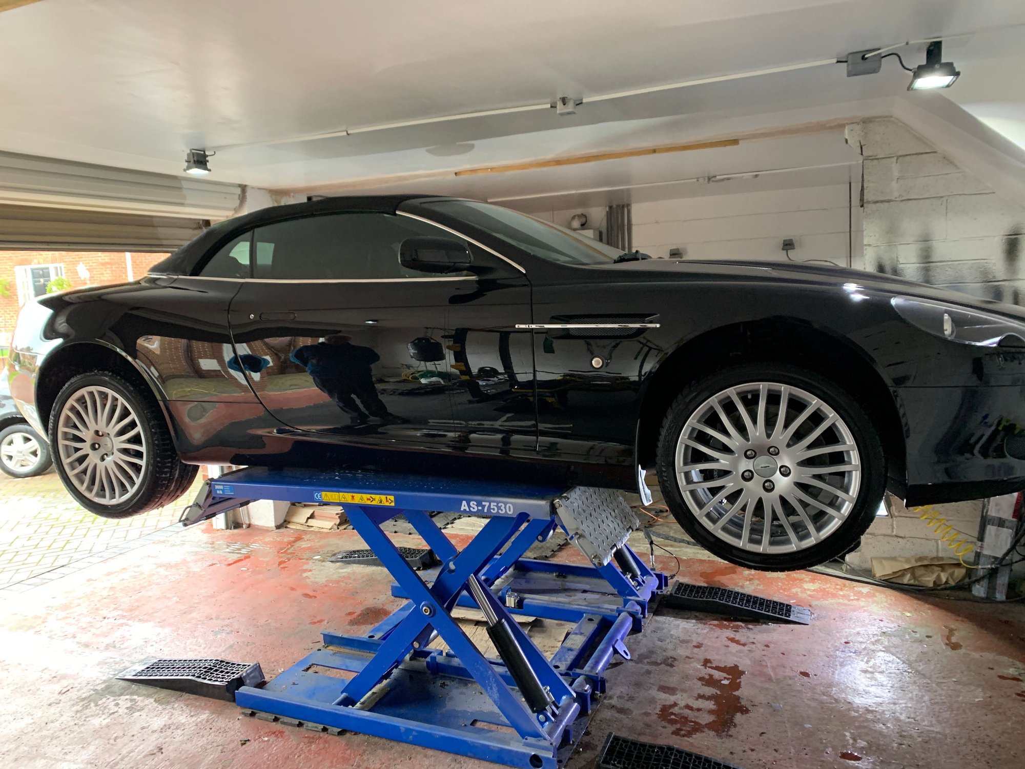

For me the best thing I've ever bought is a lift. I'd love a full height one but until I get a place with higher ceilings this one will more than suffice.
Then I'd say the next most useful thing I've got is an oxyacetylene torch (not so much on the Aston, but certainly on other cars)
A 4ft breaker bar is very useful
Finally (and very Aston specific) is a 3ft long flexible tool with a magnet on the end for picking up those bits which fall down into the engine bay.
