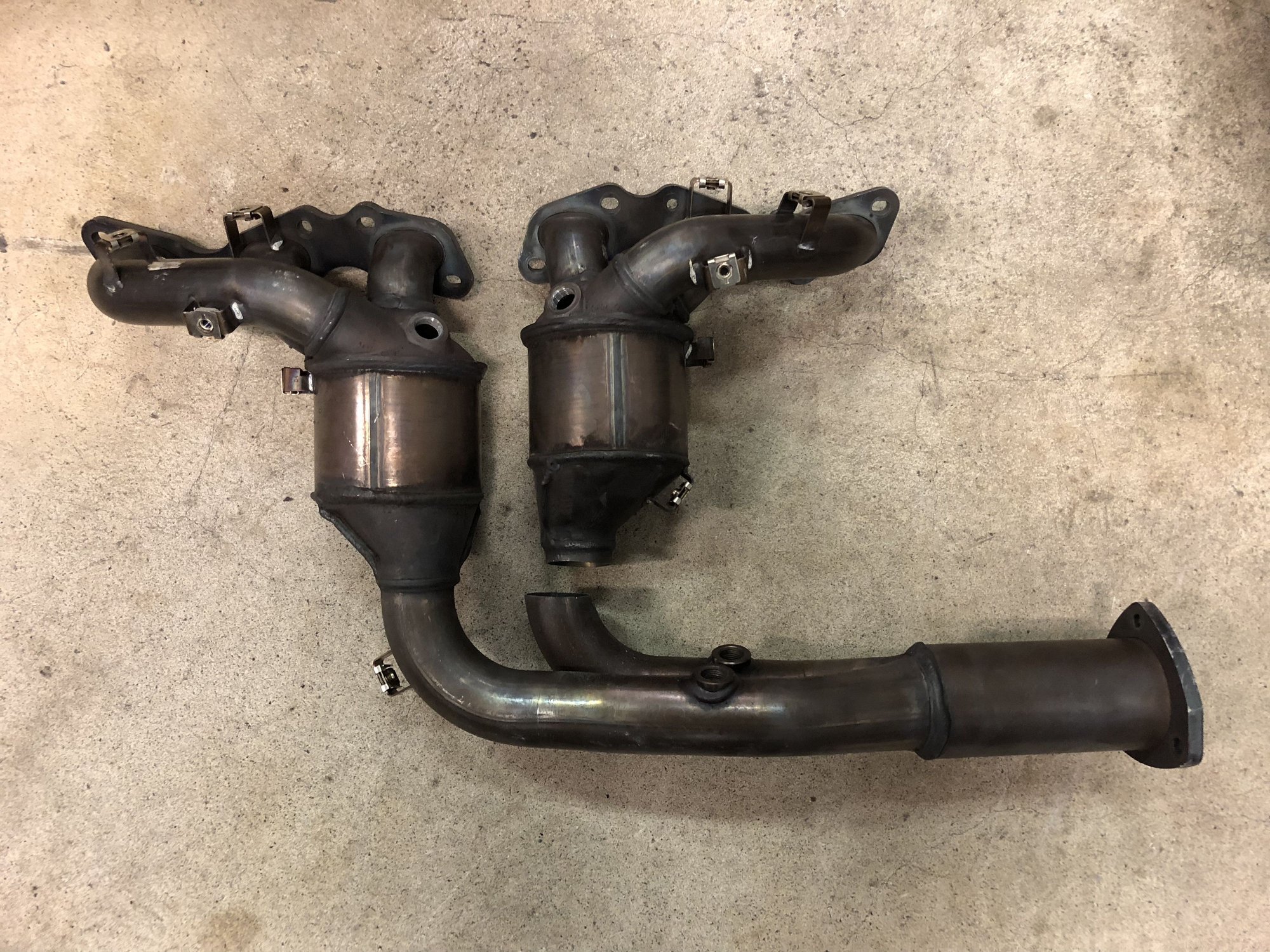

You don't need to replace with headers and lose the original sound. You can simply chop it out of the stock manifold. And disable the cat monitor. Cost 10x cheaper. You cut just below the cat and fit a flange. This allows you to remove the manifold without removing the front subframe. Then on the bench you can cut open and remove the element and weld it back. You will need a "mini cat" of some kind to avoid a warning light if you don't program it out. Or you can upgrade the downstream cats to support 12 cylinders and then fit the O2 sensors downstream. That way you will even pass a tail pipe emissions test.

Removing the baffles from the stock manifold and deleting the primary sensors is what BR recommends. Have you done any of this?

Because of my local laws I will need to do a bit more engineering first. I plan to do something in the next year at least.
Here someone improved on the stock manifold once the primary was removed; https://www.pistonheads.com/gassing/...f=70&t=1903854
